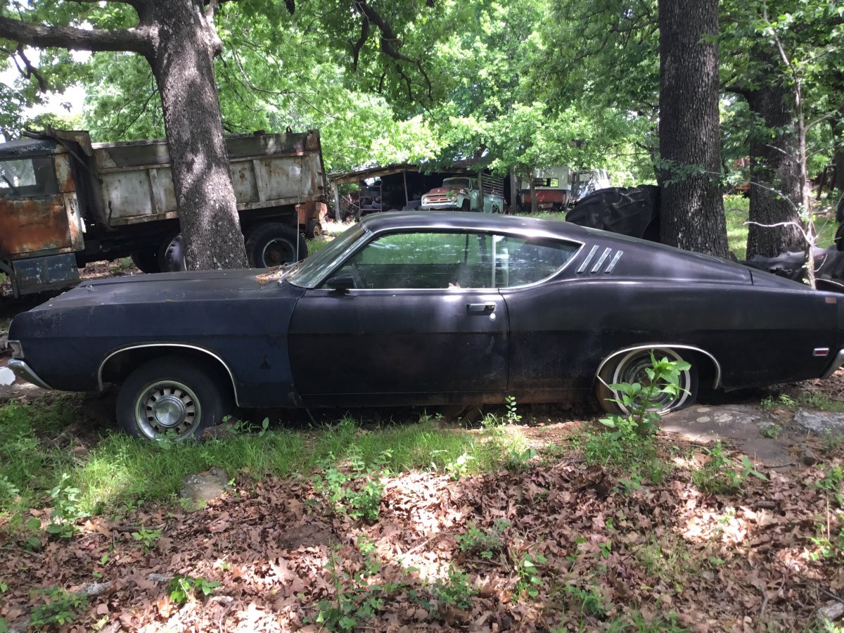

    Find the 312, it made 245 horse power in stock form. It came with better rockers, bigger heads( ECZ) and larger exhaust manifolds. It made awesome torque. We put one in our 1956 Pickup, back in 1965. It was the engine my Dad taught me how to rebuild an engine on. You can see the truck in the barn if you look closely. C2F0DC6A-B088-4D80-B151-F3A4B17EE594.jpeg

    or you can crop the picture :)

    Maybe you can! Not that high tech! Lol
