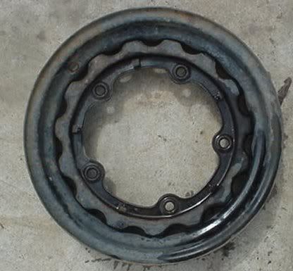

    If they are original wide fives they will look something like this:
    They're really pretty damn distinctive as you can see. The wheel lug holes are almost all the way out to the rims.
    Frankly, if your hubs are set up to use wheels like those I don't think you'll find wire wheels to fit without changing your hubs/brake drums. (I may be wrong about that, however, and if I am I expect somebody else will be along shortly to correct me. :) )
