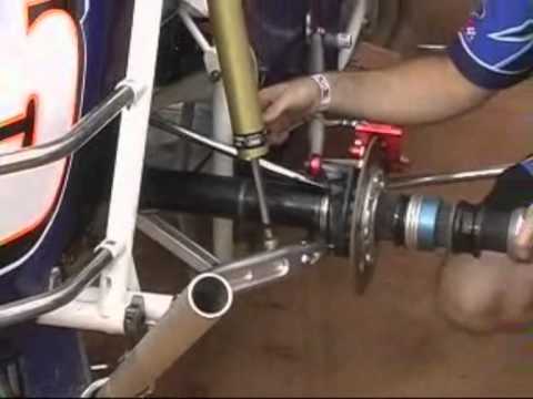

  5. Yes @Hnstray is correct, I believe Ford came out with in the late 30's and they last unit 1941(?)
    Live Axels are what sprint cars or I.R.S. cars run . where the axle shaft are open and run in a bearing.[​IMG] [​IMG] [​IMG]

    I believe Post #6 illustrates the difference between ‘live axle’ and ‘floater ‘. What the photos in post #20 show is the difference between a stock truck floater axle shaft and a refined race axle shaft and drive flange.
