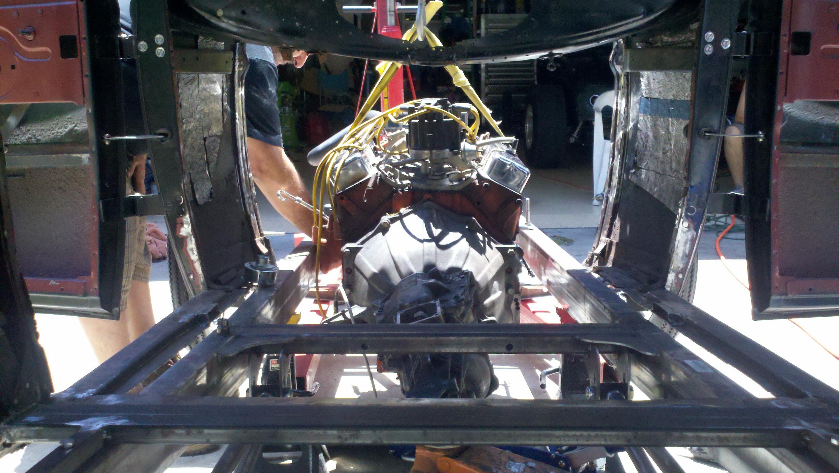

    I just set up the motor mounts in my 32 for the 351w. The motor is dead nuts level measured off the motor mount bolts, and with an angle finder off the carb base plate. But when i peeked inside the car i notice that the transmission is tilted towards the drivers side a good 10-15 degrees. I've heard of chevy tilting their t5's but not ford. I have checked the numbers on the trans and its an 87-93 mustang V8 trans.
    I've searched high and low and cant find any evidence that ford ever made a bellhousing that tilted the trans like this. Anyone have any ideas?
