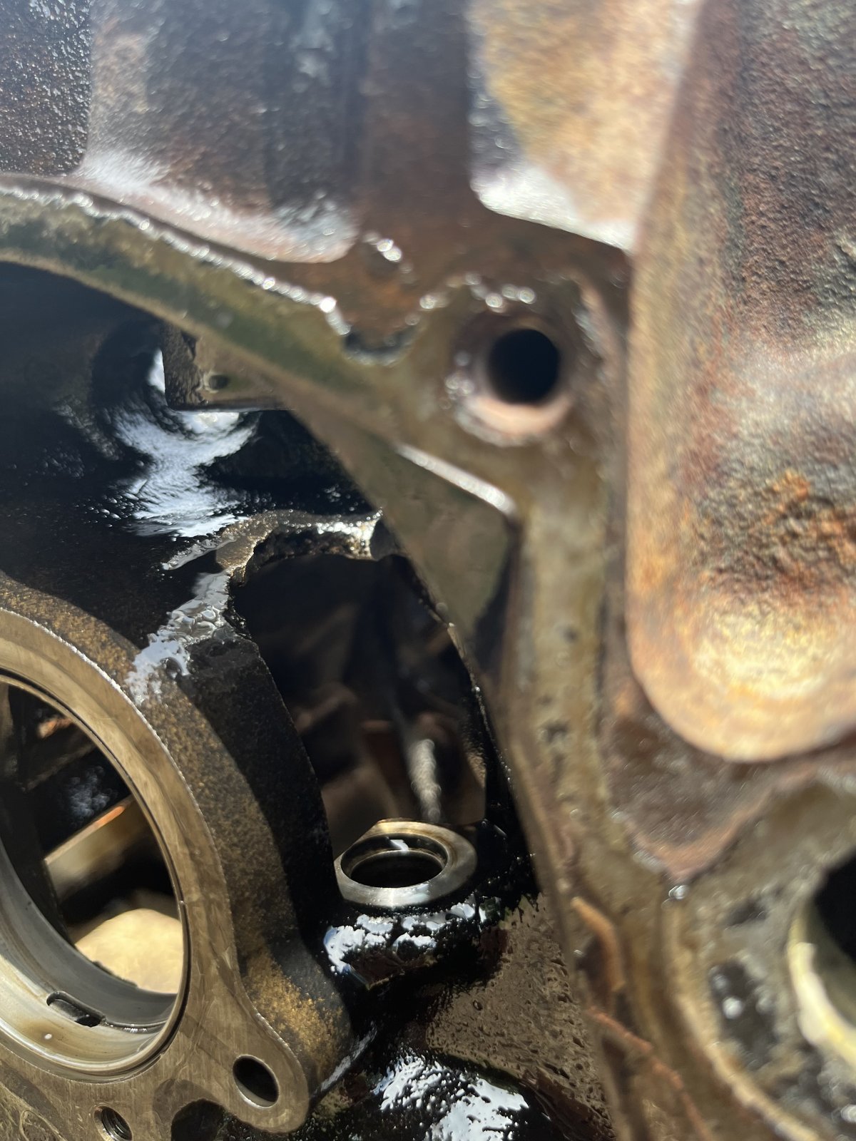

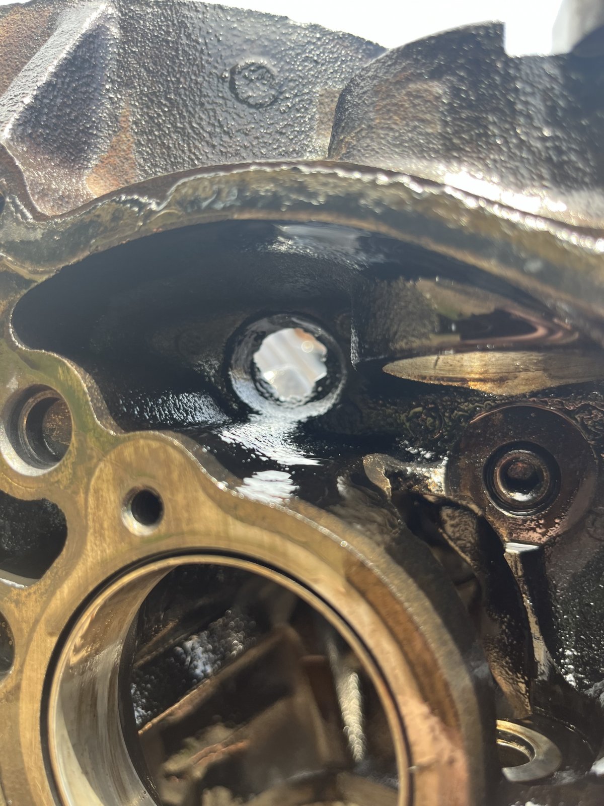

    Hey guys, I recently picked up a Windsor block to build up a stroker. The 302 in my '54 Ford is fun and all, but I want, nay, need, more power.
    Now that it’s cleaned up, I noticed a rough looking hole in the lifter valley, that leads into the timing cover/distributor shaft.
    it looks like it may be intentionally cast to have that hole knocked out by the factory, but if anyone can confirm that, I would greatly appreciate it! 67778318290--F6BF36B7-EB3D-422F-B595-48A73DD694A5.jpg

    I’d deburr it along with everything else…

    Ditto. It is a drain back hole that is supposed to be there. I just needs a little grinding.

  4. I’m blind,,,,I don’t see any problem,,,,,,looks like a little casting flash around the hole .
    Am I missing anything ?

  5. Lifter valley drain hole.

    From memory it's there to help with the crank case ventilation more than to act as an oil drain.
    It's meant to be an all the way through but looks like the sand slipped during casting, so was knocked through during finishing.

    thanks everyone. I will debur and move on!

    One thing you can do with the two rear drain back holes is take a die grinder and smooth the passages.
    No need to make it larger just radius and blend it so the oil has an easier transition back to the pan.
