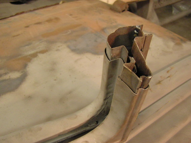

  27. This is called a sleeve. In this case its being used in a door window frame. You use a piece of the part removed, split and welded back together. This telescopes into both sides of the part. This provides a backer. Make sure you get full penetration into the backer. Now when you grind off your weld you still have a strong joint. As strong or stronger than the surrounding area. Also makes alignment much easier( in the last picture the door frame is just slipped together without clamps). Another way is to separate the outer and inner pillar and cut them at different places. (stagger cut)I use one or the other or a combination of both depending on the design of the part your sectioning.
    Most people simply butt everything together, then grind it down. Unless you do your welding and grinding perfectly, it can severely weaken the pillar. No matter what kind of car, the pillars are critical should the car ever get wrecked. Not to mention metal fatigue over time.

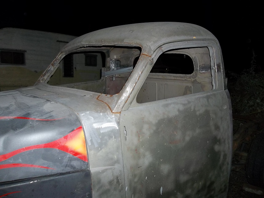

  28. On this Stude, you can see where I took off the outer A pillar skin. Over the winter, in storage rust formed on the weld line, making it easy to see where it was cut. The skin was removed, the pillar cut and lapped, and in this case reinforced with 3/4" square tube. The pillar was so weak originally it was scary! Then the skin was cut down and welded back in.
