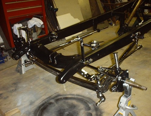

    I used a 1953 f-100 box in my '31 frame.
    It goes like this:
    1 - Figure out where you want the center gear for your pitman arm mount to be located.
    2 - Adjust the angle of your steering column to fit properly to your dash and interior
    3 - transfer by marker the top edge and bottom edge of the frame rail to the 3 bolt flange of the steering box
    4 - subtract from these lines the thickness of the material the rail is made of, and add a little to be sure
    5 - use a cut-off wheel to remove this material from the steering box flange
    6 - using the same clearance from the edge of the flange to the center of the bolt hols, redrill the upper and lower hols for new mounting locations. No big deal here, you just want enough meat on the flange equal to what was there to begin with.
    Hope this helps.
    I actually added a few washers to the rearward bolt between the rail and the steering flange to push the steering wheel away from my door and toward the middle of the car. you may or may not need to do this. I attached a pic of mine. It may not be so clear, so I'll try to find a closer view and from the inside as well. I did this AFTER I boxed my rails.
