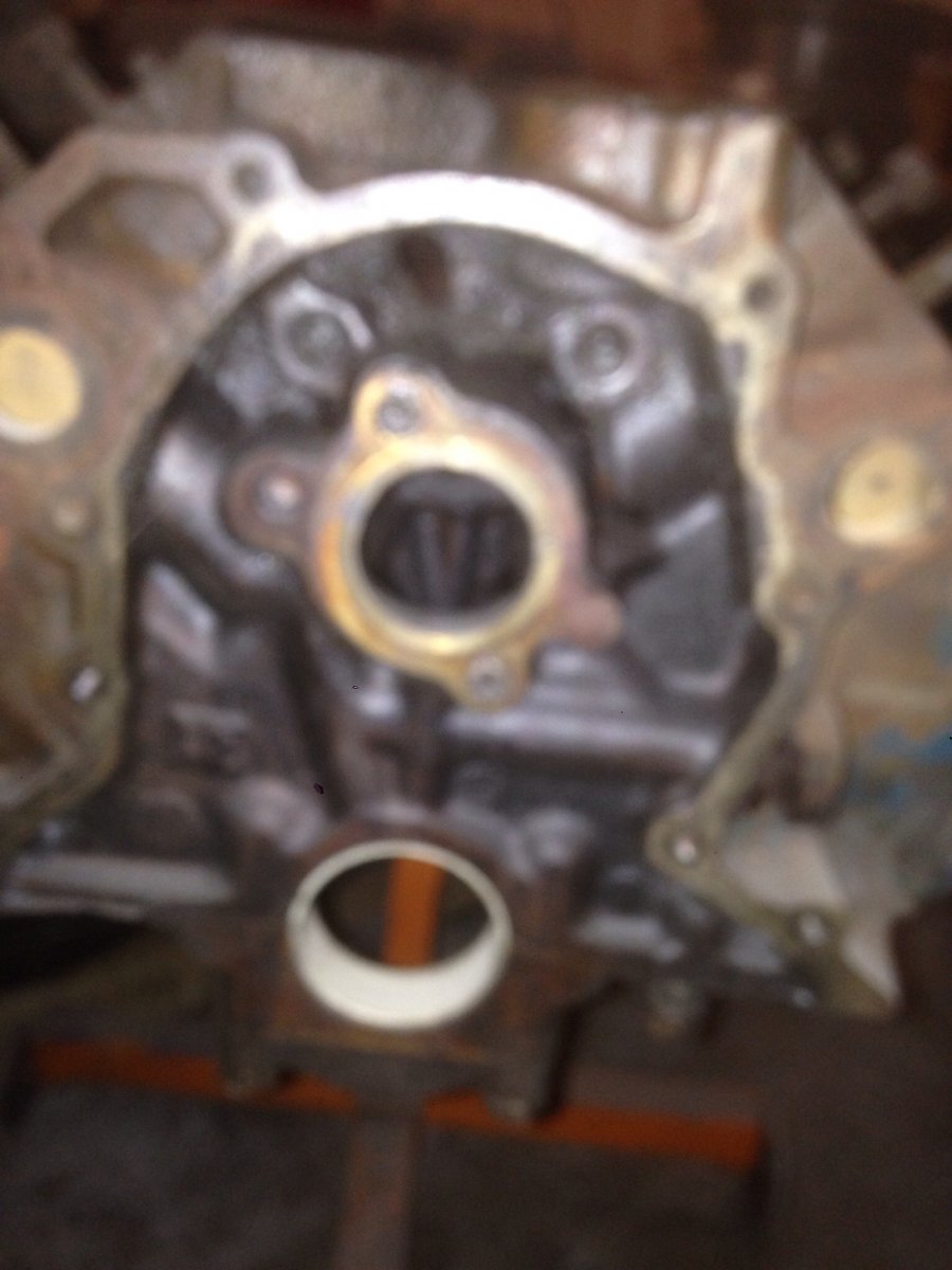

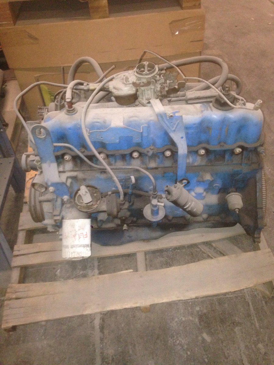

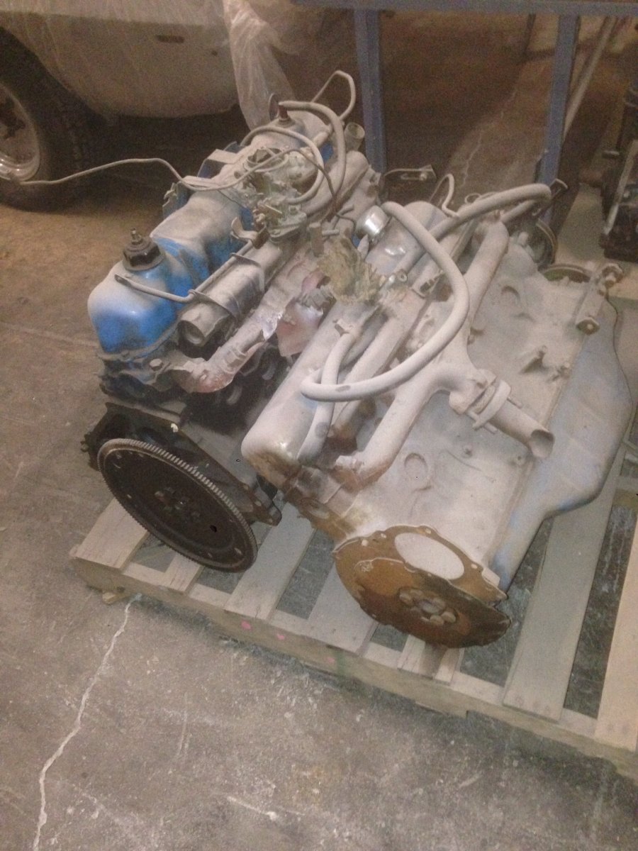

I sorta had 3 ford engines follow me home. 1 pretty complete 6 cyl. One partial 6 cyl and a V-8 disassembled short block. I need to get them IDed valued and moved along but I don't know where to start. Where's the numbers on these things ? Bores and crank look great, certainly a good builder.

I think the six on the left is a 200 cu in engine, looks to have five core plugs under the exhaust manifold and the other one has three so it is either a 144 ( I think they were) or a 170. I think the 144/170 has a generator bracket on it so must be an earlier one.
The 200 is a late-style block, with the modified V8 SBF pattern. The 144/170 has the early 8-1/2" bell pattern. Check for a part number on the log of the intake manifold, toward the front. That will give the year. Decade by letter (C=1960's, D=1970's, E=1980's). I am guessing 1970's on the 200 (else Econoline Van, 1980-1983). On the 144/170, look at the pad near the front of the block, by the distributor. There is a sole stamping there. It is a letter T, or a letter N. T = 170. N = 144. If you find neither, you may have the fairly rare very early 4-main bearing 200, after that they, and the 250 had 7-main bearings.
The deck on the blue one looks too low to be a 250, but you can verify that quickly. A 200 has a water pump held on by 3-bolts. A 250 has a water pump held on by 4-bolts.
