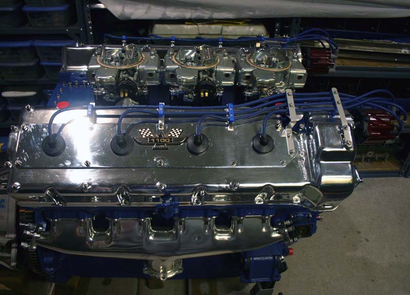

    Greetings: I'd like to continue and add to the discussion about the Ford GAA V-8. My rod project involves building up one of these engines and putting it in a 1984 Ford F350 cab / chassis donor truck. The truck is a long wheelbase regular cab dually with 6.9 diesel and 4-speed manual trans. I am adding a 36" cut down sleeper behind the cab and then a 6' flat bed with my cargo being (3) 16-gallon polished beer kegs on cradles, which will double as extra fuel tanks. The truck is to be built up as a "driver" and not a trailer queen. My motto in building it is to keep it "Simple Yet Functional - Like a Sledgehammer." The GAA engine is 33" wide, only 3" wider than a Ford 4.6, and will fit the engine bay with 1.5" to spare on each side. If I offset the engine 1" to the right, I won't even have to move the vacuum booster. The heater box, however, will have to go. The GAA engine is only 3" longer than a Ford 300" truck 6, but will require notching the firewall for lengthwise clearance. I want to add a Detroit Locker to the Dana 70 axle. The engine requires an automatic trans, as the engine's torque cannot be controlled with a manual trans and riding the clutch. I'm starting out with a Ford 4R100 and will changeover to an Allison 6-speed after I've saved up a whole lot of pennies and dimes.
    On to the engine: my #1 engine as built up is stock except for carburetion and ignition. The 2 Stromberg 2-bbls have been replaced by 3 Demon 4-bbls and the very weak WW2 era ignition has been replaced by 2 MSD distributors with 6AL controllers. I will try to attach a couple of pics of the engine to this memo. The stock engine as installed in Sherman tanks had 1,000 lbs of torque or more at every rpm from just above idle to redline. If it were left totally stock, when the light turned green there'd be 1,000 lbs of torque to pull away from the light with. With the changes made, this should increase to around 1,200 lbs of torque or more. The engine is all aluminum, but "light" is relative. "Light" means around 900-950 lbs. The block itself is very light, around 200 lbs, weighing less than a 350 Chevy cast iron block. Of course, with the 5.4" bores, its like swiss cheese. Two average men can pick up a block and carry it around with no problem. However, the crank weighs around 135 lbs, each rod weighs over 6 lbs (no use quoting gram weights here) and even the pistons weigh over 5 lbs each. The cut down flywheel weighs around 100 lbs. Still, there's no more weight on the front end than there would be with a 460 or diesel with a snow plow attached. In fact its less. The heads are DOHC, 4-valves. The exhaust headers are of fabricated stainless steel and are both light and streamlined. A whole lot of air goes into and out of the GAA.
    With the GAA, its tough to grasp just "how 'big' is 'big?'" Its bigger than (3) Chevy 350s, bigger than (2) Dodge V-10 rams plus an additional PT Cruiser 4, bigger than 2 1/2 Chrysler 426s, etc. If someone had a built-up Boss at 550 cubes, it would only be as big as one of the cylinder banks on the GAA. If somebody had a GM 502 crate motor, you could say, "another 48 cubic inches and you'd be half as big as my Ford." And all the power is right at the bottom end where its needed for street use. How about fuel economy? My trans has a 30% overdrive, and with a converter lockup, an add-on US Gear (0r Gearvendors) 22% overdrive, a 3.54 gearset in the Dana 70, and 265/75x16 tires, the truck will pull around 1080 rpms at 60 mph. I think 5-7 mpg is reasonable, which is in line with many other street rods, especially those with tunnel rams, blowers and / or gears.

  12. Three four barrels! That should flow some decent air, hahaha. What size are the carbs? Demon carbs come in many cfm sizes. Any pics of it installed in the truck?

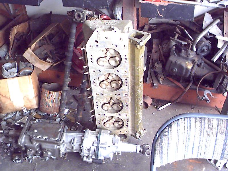

    The thing with these engines is that you could find one anywhere. I found two of them at an old time tractor dealership 25 miles from my house where I previously lived in central Illinois. They'd been sitting in the back of a storage shed for years and years. After WW2, the tanks all got scrapped out, but the engines were mounted on skids and used as irrigation pumps or generators until they came due for overhauls, then either got put away, abandoned in the field, or sold for their metal content. My engines were locked up, and were sold to me "as-is." I was able to break one free fairly easily with a 4-ft pursuader bar, but the other one required drilling out two pistons until there was nothing left in the bore. Then I had to take out the sleeves because they were ruined too. The price was reasonable, roughly equivalent to "by the pound" scrap prices, but I took a big chance that I could save one or the other for rebuilding. There's no such thing as going down to the local Auto Zone or NAPA store and finding any parts for a GAA at all. It took me well over a year of networking to find barely enough parts to rebuild one engine. A couple of head gaskets from Canada, pistons from Pennsylvania, a starter ring gear and valve springs from Texas, etc. Every change from stock, such as an intake manifold or distributor adapters, requires custom fabrication. The entire oiling system had to be redone to get modern oil filters to adapt, etc. There's been many a day that I wished I was back wrenching on small block Fords.

    Using the Edelbrock catalog's formula for CFM requirements, the GAA requires 945 standard cfm @ 3000 rpms, assuming 100% volumetric efficiency. So going a little liberal on the requirements, I could've either gone with (2) Demon 750s or (3) Demon 525s. I went with the (3) smaller units because manifold runner length was going to be an issue with only two units. Talking to some old timers and tank restorers about their experiences with the GAA, it has always shown a sensitivity to manifold runner length. And not to mention that the engine just looks like its asking for that 3rd carb to set it apart from the crowd.

    Holy shit, dohc and pent roof chambers? SICK.

    In answer to a question about the dimensions on the GAA that was asked earlier, the engine is 41" long, nose to tail, including the MSD distributors on the valve covers. The engine is 39 1/2" tall from the bottom of the pan to the top of the air cleaners, or 35" from the bottom of the pan to the top of the valve covers. It is 33.25" wide including the exhaust manifolds. By comparison, the Mustang Cobra 4.6 DOHC is listed by Ford as being 30" high and 30" wide. If you can shoehorn one of those into a Mustang, then you can shoehorn one of mine into a pre-97 Ford truck. Might have to cut a hole in the hood for the GAA's aircleaners at the most.
