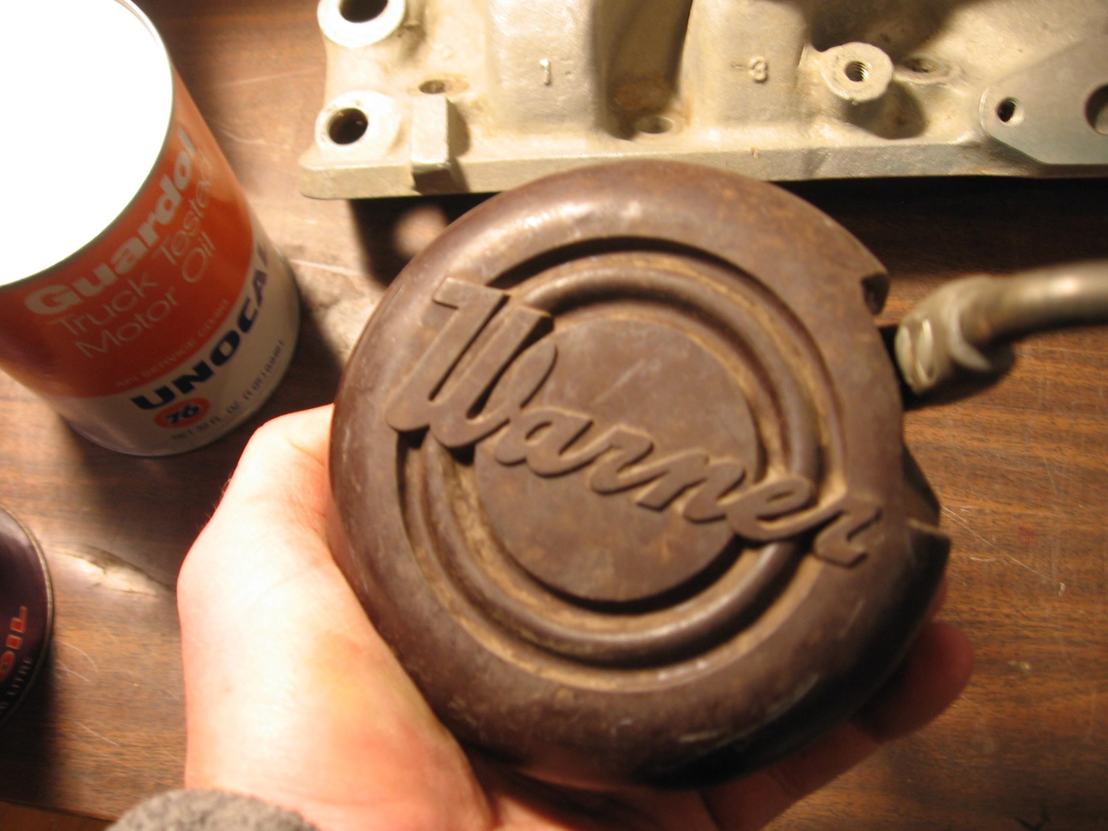

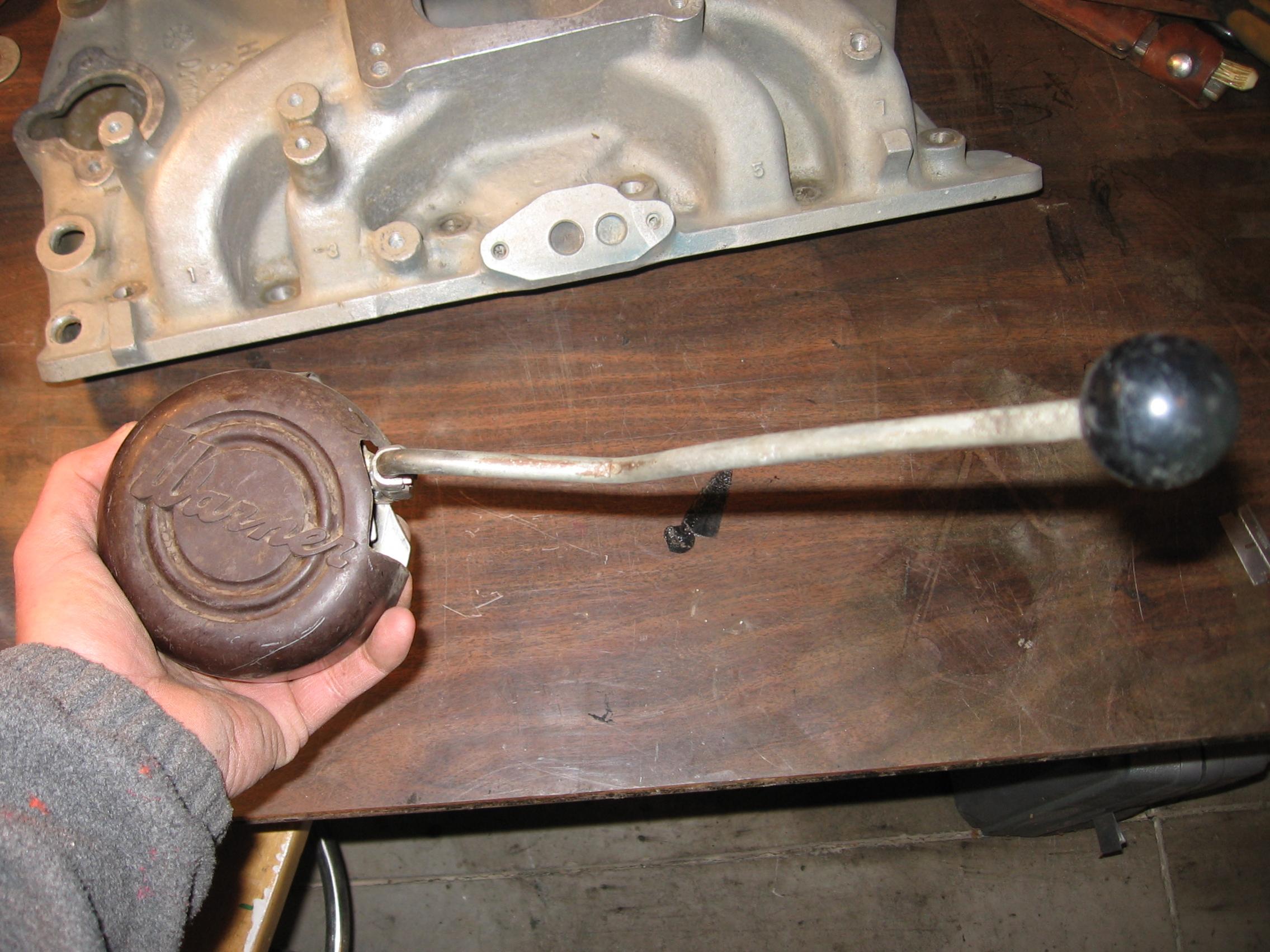

  9. JF
    Joined: May 15, 2008
    Posts: 519
    JF
    from Utah
    I would use a Warner! If your trying to stay traditional.... Best ever made! :rolleyes: ok sorry...
    I'd have to go look in my truck to see what brand it is. and its cold out there right now.
    btw this Warner is for sale cheap if ya want it ;)

  12. Ebbsspeed
    Joined: Nov 11, 2005
    Posts: 6,258
    Ebbsspeed
    WOW, that's some controller! But my tow rig isn't traditional, so I guess I'm free to use newer technology. Looks like Tekonsha is the overwhelming choice, so I'll check into them.
