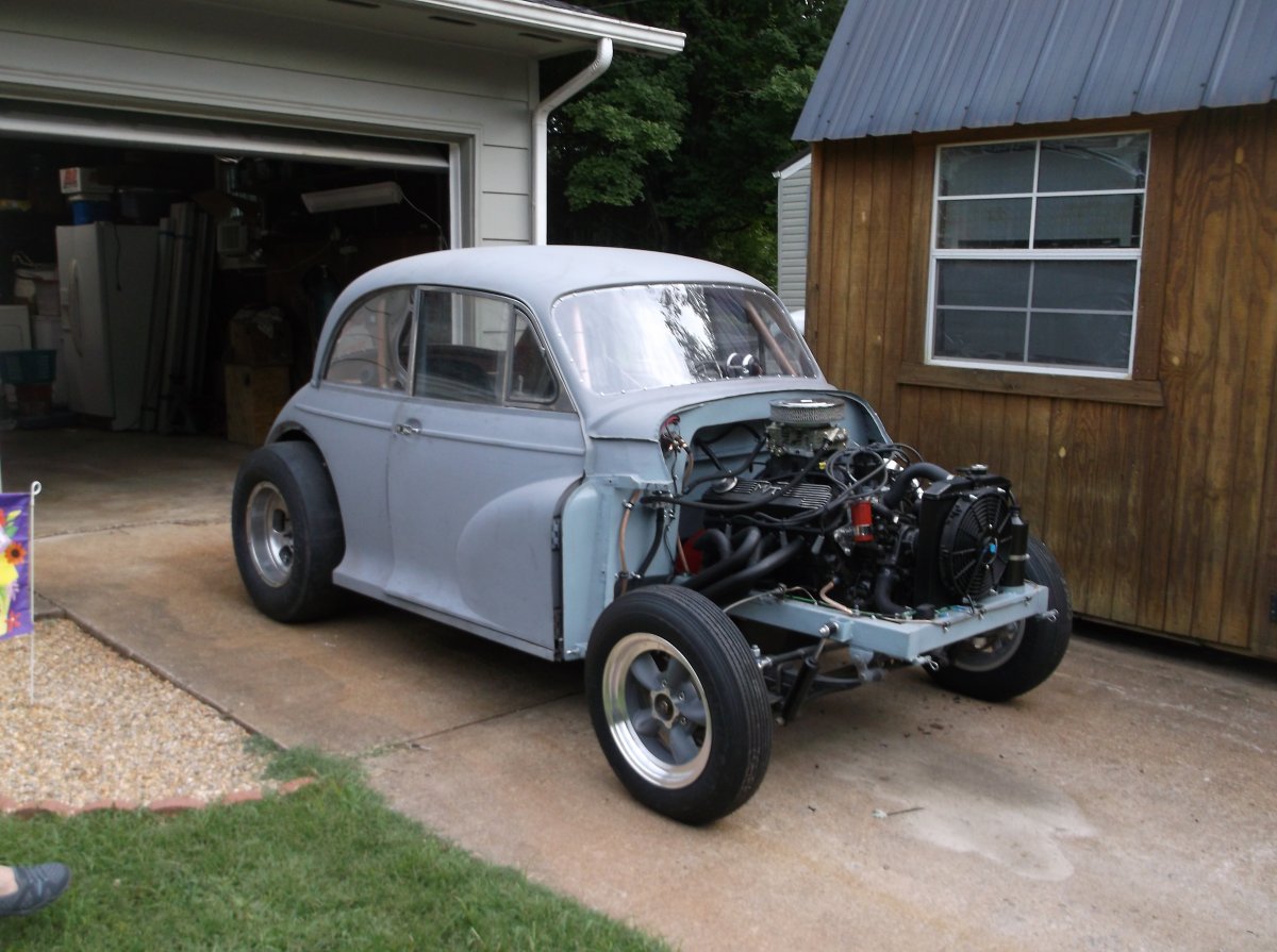

  24. My brother first tried plexiglass to make a windshield for his morris racer....had to force it to curve and when he came out the next morning to check his work, every screw hole had cracked.
    Next, he used a good grade of lexan and installed it in the hot sun...worked so good he also used it for side and back windows. He had the car over 25 years and never had issues with it but he babied it and always parked it inside. Scotty's morris on 6th street..JPG scottysmorrisatB'villeback.jpg
