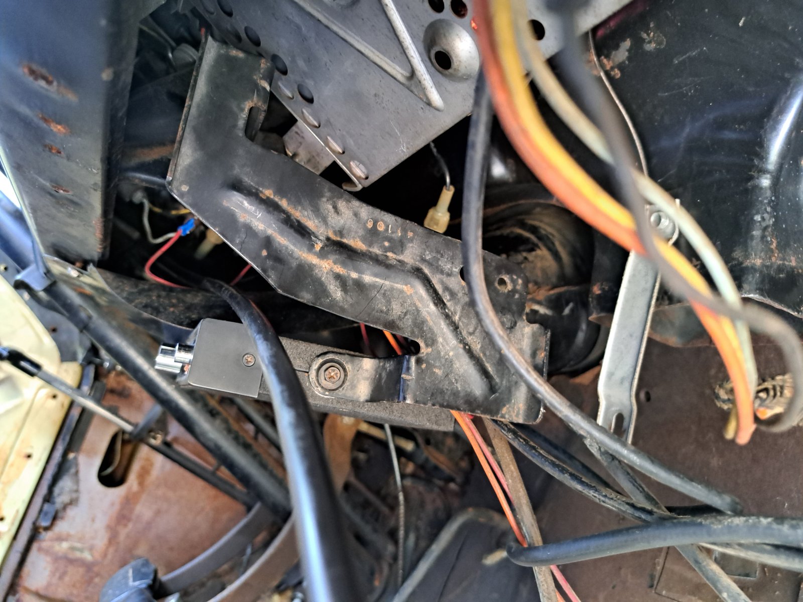

  17. installed and starting to work, i think my caps have given out at this point. audio is very quiet. 20230602_115758.jpg 20230602_115801.jpg 20230602_125539.jpg 20230602_161757.jpg
  18. squirrel

    how does the AM radio work on AM stations, when connected directly to the antenna?
  19. I installed a few of these many years ago, and from memory the low signal output to the AM radio meant you had to crank it up to hear anything. You could try an RF amplifier in series with the FM output.
  20. it used to work pretty well, but even with out the fm converter it started crackling. the caps need replaced.
