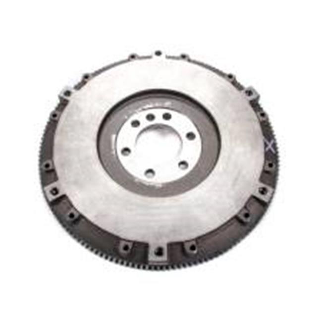

    i've got a gm flywheel that i would like to use in my 55 chevy 210 with a 1970 350ci engine. the number as close as i can tell is 3856570 dated 02/06 and gm2nf. it is a smaller flywheel with 153 teeth. it was used in a chevy dirt track car with 350ci engine. i know this ain't much info but maybe a good start. any info ya'll give would be helpful. thanks, nubby!

    You mentioned the flywheel came from a circle track racer. Does it look like the one pictured, and if so it weighs 15#.
    I run this one in a ‘32 coupe with a blower, and being a relatively light car with low end torque it is fine on the street. I think you might find the typical 30# ‘wheel more to your liking in a ‘55 Chevy.

    that is exactly what i've got. so i guess you would have get the rpm up and ride the clutch for street driving or a really tall gear in the diff. right?

    Yes, you are correct. In addition to being lighter it is cast nodular iron making it stronger than the typical GM gray iron flywheels. It’s a nice ‘wheel in the right car, somebody will want it.

    14085720 is the current part number. I doubt you'd have to ride the clutch, or need really tall gears, but it would help to have gearing in the mid 3s or so, and you'll have to slip the clutch a little to get moving.
    It was used in production cars...it's not a trick race piece.

    Maybe not a “trick” piece but it was developed for the L-88 Jim. Chevrolet didn’t use them in any other RPO. Also available BITD was a stronger 10 1/2” diaphragm pressure plate, a disc with an aluminum marcel and even a dual disc package.

    i do have a 3.55 gear so maybe a little clutch slipping want be so bad!

    You can give it a try, or find a heavier flywheel. Make sure the starter will work with this one, they used different ones for different flywheels, and the engine block and bellhousing are also involved in making sure everything fits together.
