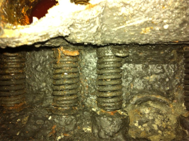

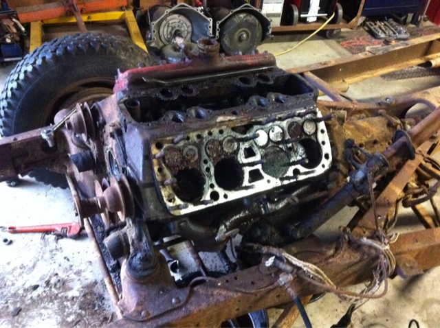

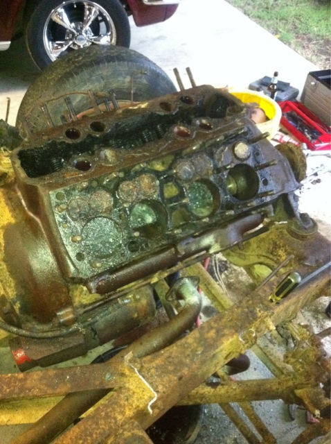

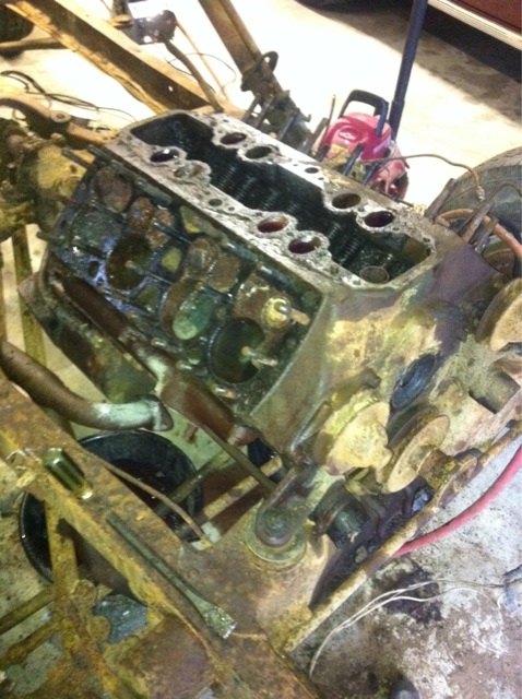

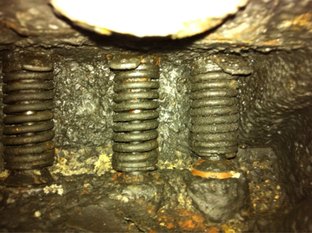

    Seized up solid, cylinders have a lot of corrosion and rust. Have sprayed the pistons down with zep rust penetrant and ATF fluid. What other tips or tricks for loosening this motor??? ImageUploadedByH.A.M.B.1405046281.207334.jpg ImageUploadedByH.A.M.B.1405046303.405085.jpg ImageUploadedByH.A.M.B.1405046322.037788.jpg ImageUploadedByH.A.M.B.1405046339.920960.jpg

    I thought about getting a cylinder hone to knock of all the rust and buildup?

    Get a correct size ball hone and work on the cyls that are down. Use a wire brush on an angle grinder on the rest and the soak soak soak. Gary

    Man that one has been out in the elements for a long time. You'll be very lucky if you don't have deal breaking cracks on that block. Be prepared for a letdown.

    Soak for a week or 2 if need be, if you get out the ones that are down, then flip it over and let the ones that are up soak from the bottom.

    I fill the cylinders with vinegar and let them soak for about a week. I will scrape the top of the piston with a screw driver around the cylinder to stir up the sediment as it soaks.
    I have done several this way. You will be shocked how clean it gets the cylinders.
    But as stated before, from the looks of that one I would be surprised if there is not cracks in the deck.

    Might attempt to check over what you can of the block before you put much effort into it. I would look at the water jackets around the bottom end, cylinder walls and the main cap webbing. If it has had water freeze in it there may be cracks in those areas that can not be repaired. An engine in that condition is going to take a large investment of time to get apart and it might pay to be sure there are not obvious problems first.

  27. Those pistons aren't the only things frozen up! That valve train is gonna take a lot of freein up me thinks .If you go the electrolysis route get a plastic 55 gal drum & get as much grease off first or you could soak it in molasses after you get the grease off & set it in the drum. Either way keep a close watch on it. If you wish to invest some coin & can find a machine shop that will bake it & pressure wash it that would be the easiest & best then it can be magnafluxed.
