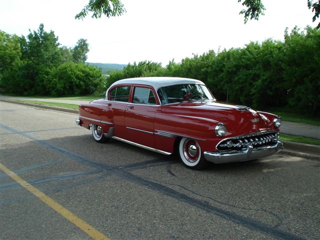

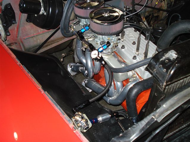

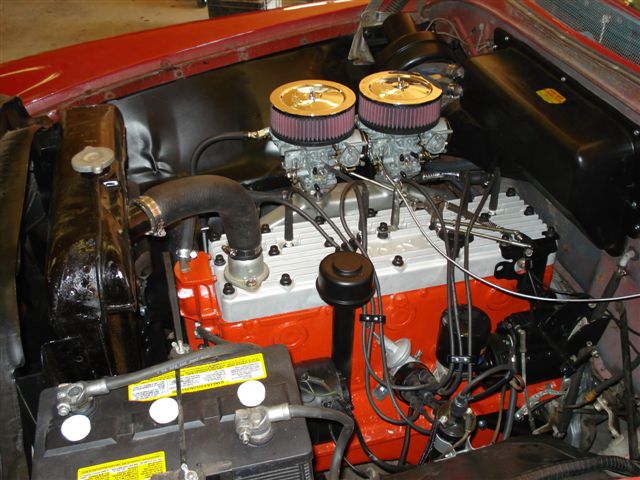

    here is my mopar flathead, it is a Chrysler 265 in my 54 Desoto with a Powerflite 2 speed automatic
    1. Bored .040 over
    2. cranked ground .010 under
    3. crank journals line bored
    4. rods resized and new bushings installed
    5. balanced complete rotating assembly
    6. port matched intake and exhaust
    7. edgy cam .410 lift and 260 duration
    8. edmunds intake, carter/weber carbs
    9. edgy head
    10. headers
