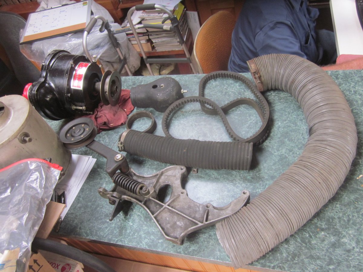

    Recently picked up a Paxton Supercharge SN60 setup. Looking for pictures of this setup installed on a flathead (postwar if it matters). Want to see what parts are used/ needed and how it installs along with relocation of existing components.
    Currently have :
    SN60
    Mounting bracket w/ tensioner
    Carb hat
    8" dia air filter canister. (Supersized coffer can shape)
    Drive belt and some hose/ ductwork.
    Belt is approx 1" wide. Single groove setup.
    Is a different crank pulley need?
    What carbs are recommended. Carb hat is larger than the OE Ford/ Holley 94.
    Shots of engines installed and not installed would be great.
    Any installation lit available?

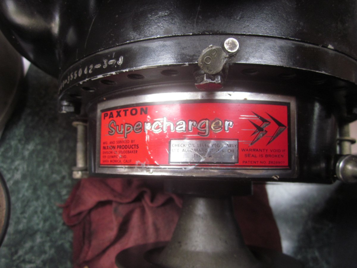

  2. This is the super charger that you got?
    Or is it the older style like this?
    If so they are not flathead specific and the only pics I have found of one so far are on valve in head engines. measure the sixe of the hat and we can better suggest a carb, probably a 4bbl is what it is set up for and ues you will need a lower pulley that accepts the drive belt.

    Carb hat ID is 4 3/16"

    That would be the same basic super charger as used on the Ford 312 or the Studebaker 289. You are going to want an intake that will accept a holley or carter carb. You are probably going to want to run an electric pump and regulator. If you keep your boost low you will be fine with a standard regulator but if you plan on really pumping some air a boost sensitive regulator might not hurt.
    If you didn't want to go with a single 4 you could run trips or two carbs and make up a manifold to hold multiple hats for your carbs. You are going to need a carb or carbs that are set up for blow though unless you build an air box the completely encases the carb.

    Look for a web site called VS57. It has pics etc of the Paxton on flathead Ford V8s. The original Paxton or McCulloch supercharger was the VS57 designed for the Ford flathead and introduced in 1953. The SN60 is practically the same except they eliminated the variable speed feature.
    If you could find or make brackets like they used you would be in business. Do not need the long arm tensioner because you don't have the movable sheave (pulley). If you could make a flat belt drive with a modern spring loaded tensioner it would work better than a Vbelt.

    Thanks for the info so far. Here is what I have. May be more pieces in the pile of parts that came with car.

    You will need to add a pulley on the crankshaft to drive it. Stock carb is fine, you will need to richen the main jet and be sure the bowl vent is pressurized.
    NO carb or internal mods needed with a supercharger.The high pressure air does the business, superchargers are expensive but you don't have to shell out for other speed parts and you don't kill your idle and low speed power.
    A free exhaust can't hurt, like duals or a larger exhaust and muffler.
  10. I think that carb hat is too big for a stock carb. I don't know where he is going to find an intake but you can buy a smallish Holley blow through carb cheap enough.
    Its too bad it is not a wet blower, it would be cool to mount the carb on the suction side of it.

    If you look at old pics of original installations on early fifties flatheads they don't use a bonnet. They have an L shaped rubber hose that goes from the blower outlet to the top of the carb . You could use a rad hose, there is no gas just air going thru.
    This is something people don't get. If you double the air flow by pressure, you double the size of the carb, the manifold passages, everything. You don't need a bigger carb and a bigger cam may actually be counter productive. A cam with a lot of overlap allows pressure to blow thru and out the exhaust. Stock everything is fine.
    If the blower by itself isn't enough I would start with a more open exhaust or even headers, then maybe a cam with more lift but not too much duration and maybe a bigger carb (not too big) and clean up the ports.

    You said the carb hat won't fit and it won't. It is made for a small 4 barrel. I am saying he doesn't need a carb hat for a flathead. The blower outlet is the same size as the stock carb, all they used was a smooth rubber hose like a rad hose. You would need to find one the right size with a 90 degree bend.
