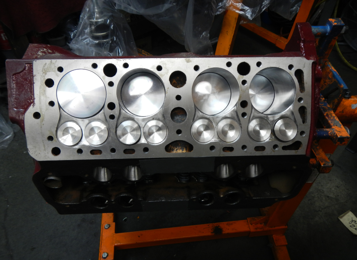

  25. Bandit Billy
    Joined: Sep 16, 2014
    Posts: 3,639
    Bandit Billy
    Before
    During
    After
    Just like building a car, make a plan and stick to it. Try not to change gears in the middle to avoid costly errors. Do the homework and research. These motors cost a fortune to build up, but they're worth every penny.
    slim38 and GreaserJosh13 like this.

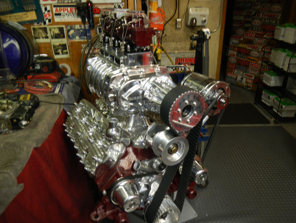

    If you look closely at this flat motor, you can see that it has been filled with aluminum for fuel racing Now you can bore exhaust ports anywhere you want to. 27973648_1839305436093212_2931293851900889814_n.jpg
    Bandit Billy and GreaserJosh13 like this.
