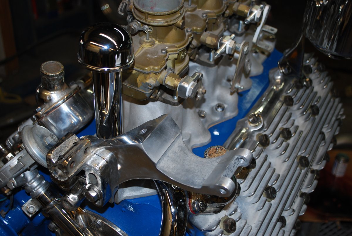

    Hey guys. I'm building a 8BA , my first (always been partial to the 59As) for a customer. Anyway, we have an Offy triple intake on it. He brought me a Powergen for it as well as an Offy left side offset generator mount. I got it all mocked up and I don't see how it's going to work, the generator still runs into the carb at the fuel fitting and I'm not seeing an easy way to get a radiator hose on. I realize the Powergen is slightly bigger then a stock generator but I don't think even a stocker would fit. How are you 8BA guys dealing with mounting a generator on with triple carbs? DSC_0275.JPG

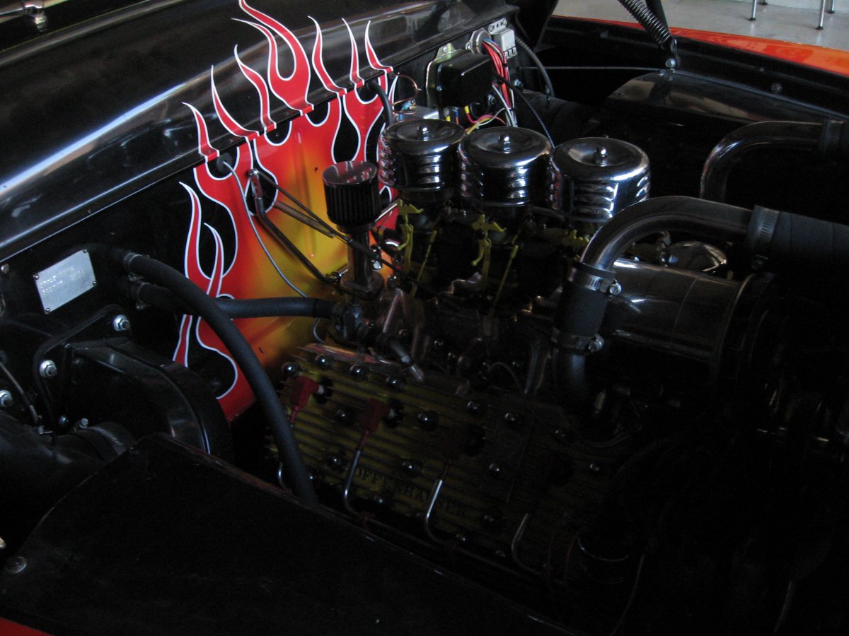

    H and H flatheads sells an offset generator bracket for the 8BA

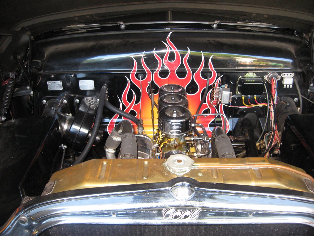

    I have a stock generator and use a bracket that is offset to the passenger side. Sorry, thought I had better pictures. 088.JPG 089.JPG

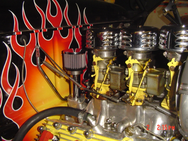

    Let's see if this is any better. Not too good at this shit!o_O

    You will have to modify the water outlet configuration. That's all I got.

    Stromberg sells a banjo fitting that fits tighter to the carb than the one you have now. And somebody (maybe vintage part, I have an old one on the shelf) sold a water neck with a more sideways slant to get the hose around the side of the generator. Check the usual suspects for one of those (Speedway, Flathead Jack, H and H).

    Thanks for the replies. I had opted for the left mount since the distributor is on the right, I see now it would of worked better on the right.
    I did see they sell water necks that point outward instead of straight up, that's an easy fix. The necks on it now were in bad shape anyway, customer had them chromed but they still look like sh-- so no loss in my book.
    Since I can't return the mount we bought (of course I polished it before I tried it) I think I'll try cutting it up and extending it a bit to clear the carb fittings I have now. Hate to spend any more money on more parts if I can make what I have work.

    Got it fixed. Cut the bracket in two and added 3/4" to it to move the generator out. Barely touches the banjo when the bracket is all the way down, clears just fine when it's pulled up to tighten the belt. PIA, next time right side bracket.
