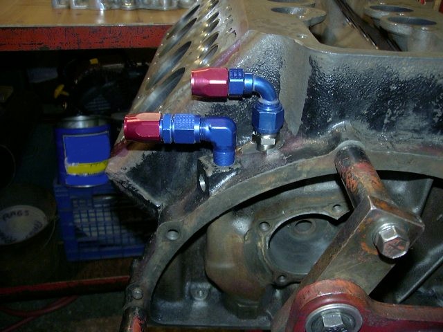

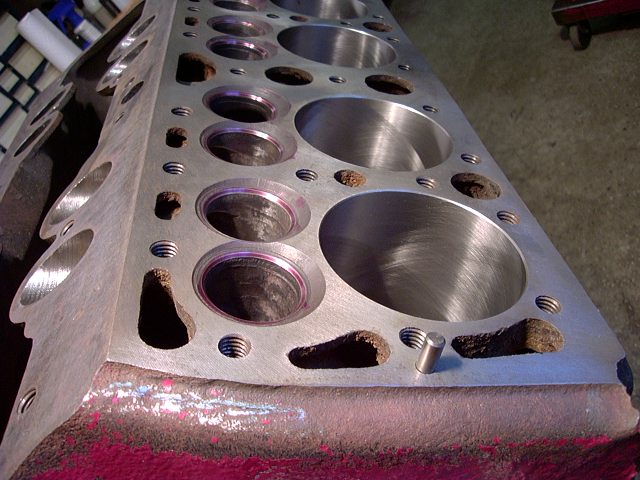

    If you click on the link below the photos you can read about a build that worked out real well, had some high-end mods performed, 95% oil filtering, heads/gaskets "pinned" to block, same setup as SBC with 5/16" doweling. (See photos below)
    Thanks, Gary in N.Y.
    P.S. We do all our own balancing in-house, the Eagle cranks balance up easier! That build should produce about 150 HP, but would require the metric rings! Here's a shot of the Eagle 4.250" crank, the oil filter mod, and the pinned block/heads. We feel this is very important with aluminum heads, it helps extend head gasket life.

    Do you have to drill the gasket for the dowel pin? If so do you use copper or the graphtite? I will talk to my Machinest about doing the dowels. I am going to do the metric ring pack no matter what displacement I take this to

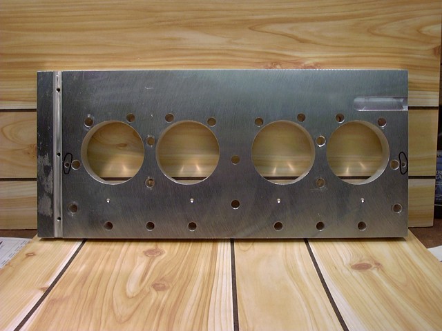

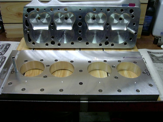

    What we recommend for a really good performer would be the block-plate finish hone (mandatory here), the metric/moly ring pack, coated cam brgs, this tightens up the cam to brg clearance slightly to help with higher oil pressure, an M-19 Melling oil pump, and a set of bronzed-lined guides (machined for Viton stem seals, photo below) along with some stainless valves. They do not have to "racing" valves, just stainless. Staying with the 1.500" valves is fine for most builds.
    I would NOT build any Flattie without the block-plate-honing in the program, period! The head-pinning would be a customer choice, not mandatory. I also would machine the casting ahead of time for the 95% oil-mod, whether it's to be functional or not! It's easy to do in the Bridgeport with the empty block.

    RE "Ans. The pinning job sounds real easy but it's highly involved. It is done with a fixture incorporated into the block plate we use for honing."
    Curious - How much do the cylinder walls distort when the block plate is torqued?
    Had one made for some 4 cylinder race motors I used to build but
    First time I have heard of a flathead engine builder using one.
