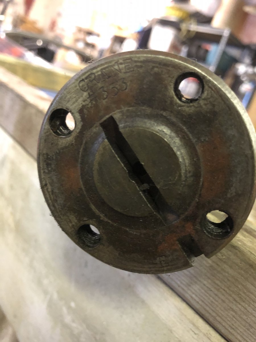

    I had this used camshaft donated to me from another hamber. Anyone know anything about these? I’m in the process of building a flathead powered 32 roadster highboy and wondered using this cam would be a good choice.
    Anyone have the specs? Google provided little help.

    The best thing to do is to put it into your block & degree it in to see what you actually have!!

    Check the lobe lift with a set of mics or 6” calipers. A lot of cam ID numbers were the lobe lift.

    I had a NOS version of this cam. I have the specs somewhere. I'll look for them and post them. It is a very cool short track cam. Should run well on the street.
    Crane 353-2 (accleration track)
    Lift I 353 E 331
    @ .050" In Opens 7 Closes 43
    @ .050" Ex Opens 46 Closes 2
    Lobe seperation 112 In 108 Ex
    Duration 230 In & 228 Ex
