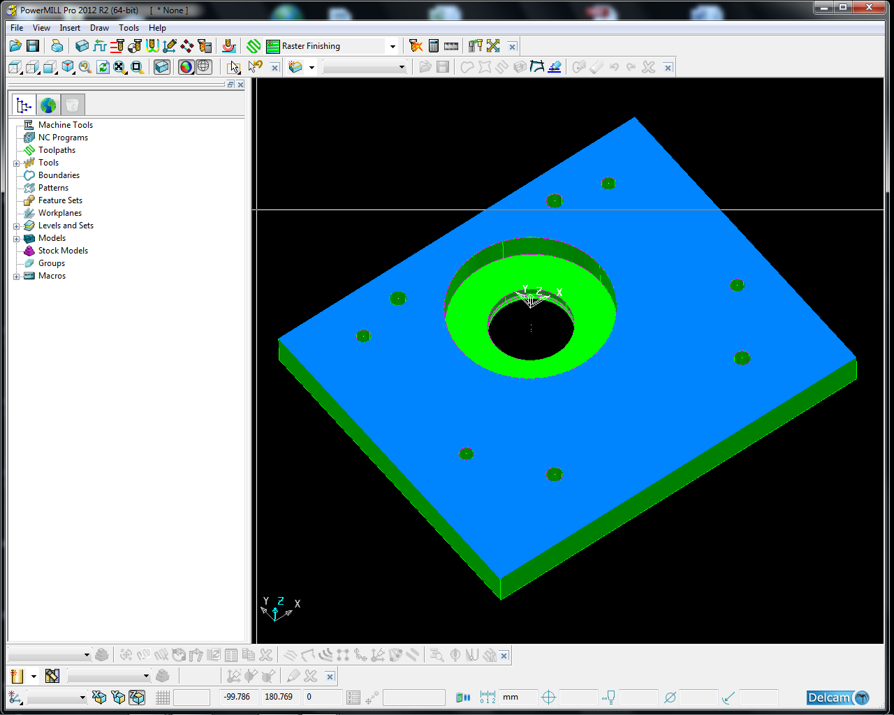

    I agree with Flat Ernie I am a fan of a bushing vs bearing. Nice adapter would have saved me a lot of time and engineering on mine adapter2.png

    Agree on the adapter! I built mine, a lot of work. I may go with the bushing, I have had pilot bearings fail, although it wasn't the bearings fault!!
