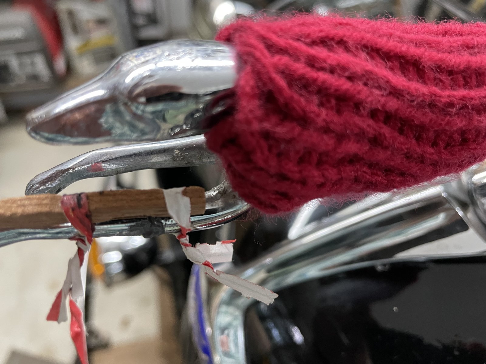

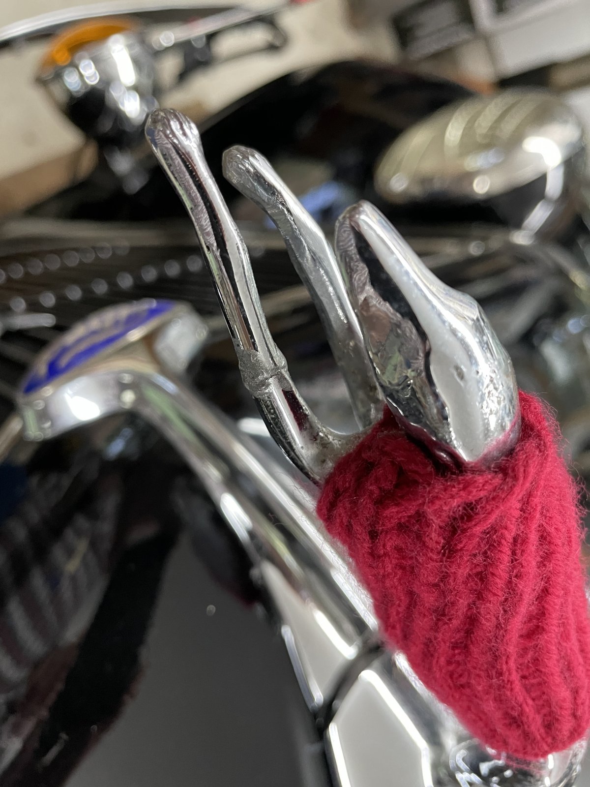

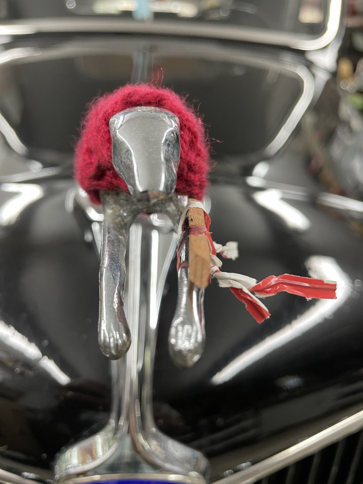

    The greyhound on the radiator cap of my '35 Pickup was something that came with the truck installed by the PO who knows how many years ago. In the over 16 years I've had it, I have become attached to Fordo as he leads the way wherever we go. I even had my wife knit a couple of sweaters for Fordo to help keep him warm on the colder days and prevent sunburn in the summer. Over the years, many have stopped to take pictures of Fordo in full dress.

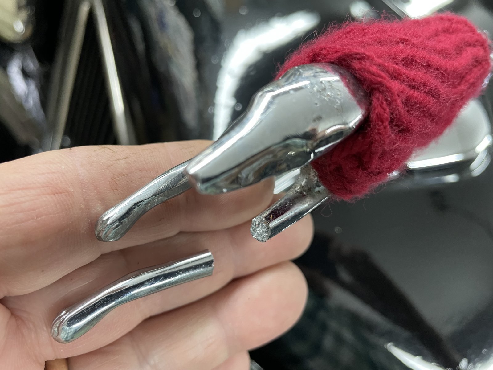

    Unfortunately, a week ago, after working under the car, I came up quickly and bumped my head on Fordo's left front arm and broke it. Realizing his race career may be over but having the benefit of seeing my neighbors work with three different retired race greyhounds as rescue dogs, I figured there had to be something I could do to help out Fordo.
    Below is a series of photos to help show the process from break to epoxy mend & splint to paint touch up of the epoxy to new soft cast and finally Fordo back out on the road again.
    I think I see a smile back on his face:rolleyes:

    Years ago, I did a similar repair on a friends '34 Greyhound. I used a Dremel tool to drill a small hole in both ends of the break and cut down a small finishing nail to use as an interior pin. A little JB Weld and it lasted years...until he wrecked his '34:(.

  14. My friend broke his dogs leg years ago and JB welded it back on, made a small cast for it out of same JB weld and painted the cast white. Everyone who looked and noticed it made a comment. It's still like that on his 33 3 window to this day. Mitch
