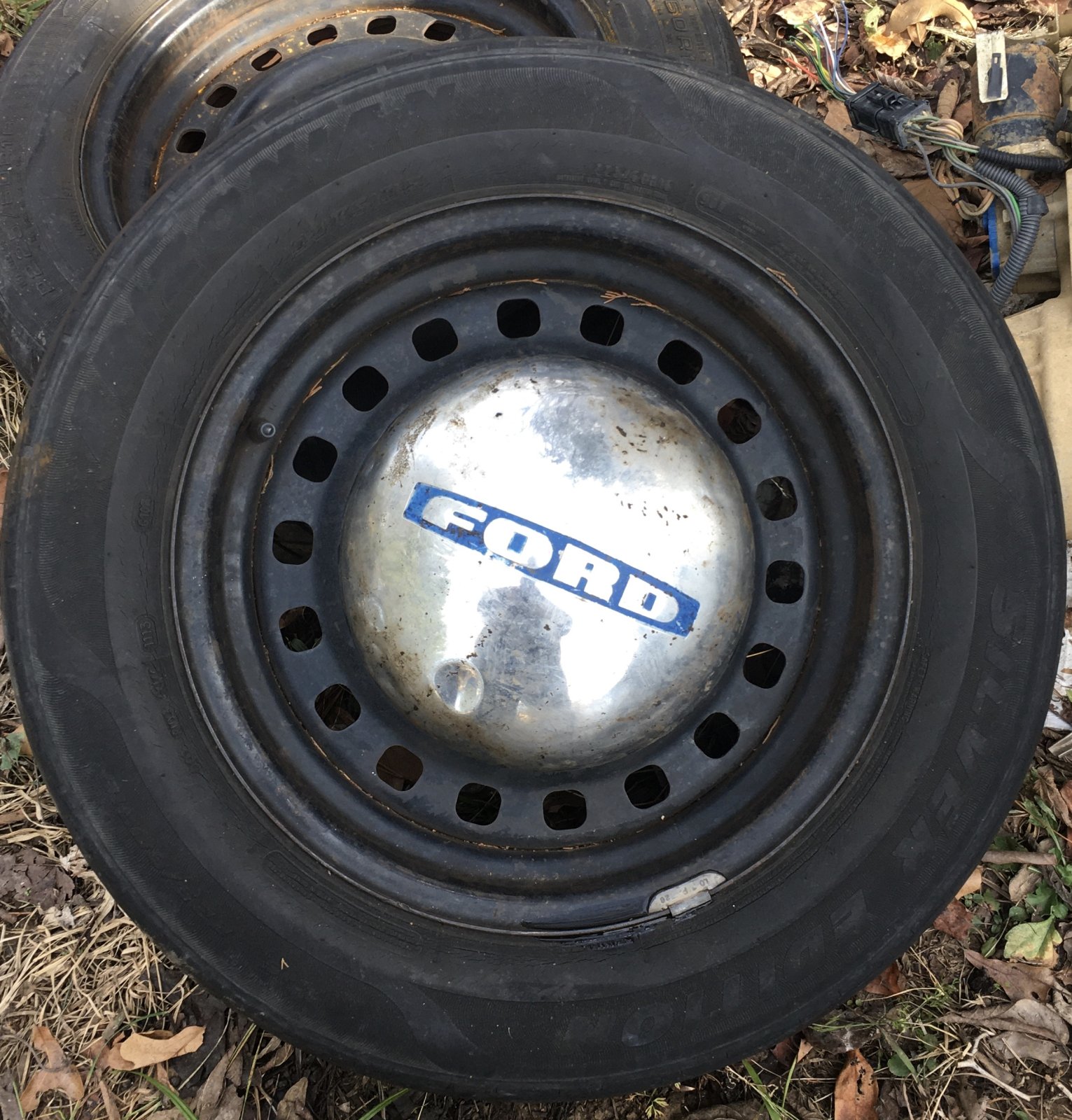

    I have some 1940 ford 10.5” hubcaps that I want to use. I have ford 5x4.5 lug pattern and 16” crown vic steel wheels. I could use a 17”or 18” wheel but not smaller than 16”. The hubcaps dont fit the wheels I have now. I have looked and cant find a wheel in the size I want with the lug patten I need that will take the hubcap.
    What options/methods do I have for making these hubcaps work?
    Thanks

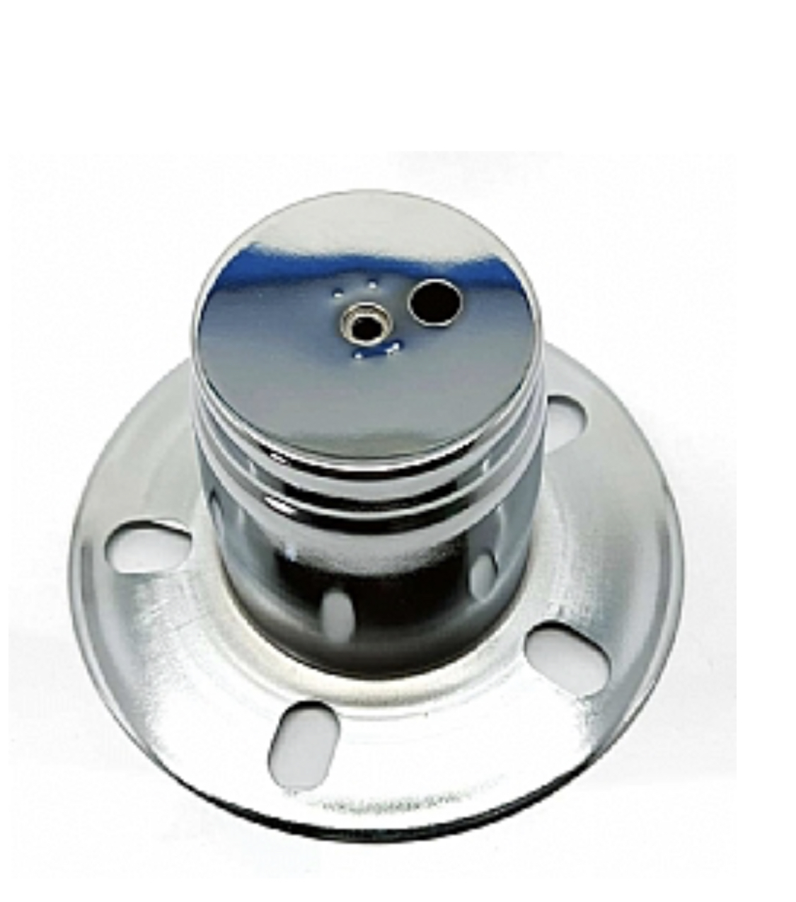

    From the center of the cap to the lug nuts is 9” deep. Originally I thought I could use the f150 or police center cap that clips onto the lug nuts and some how make this hubcap attatch to it.
    But at this point I am out of ideas. The 2 problems I have is there is no recess in the rim for the lip on the hubcap to go in so I cut the lip off the hubcap now the distance from the police center cap to the old hubcap is huge

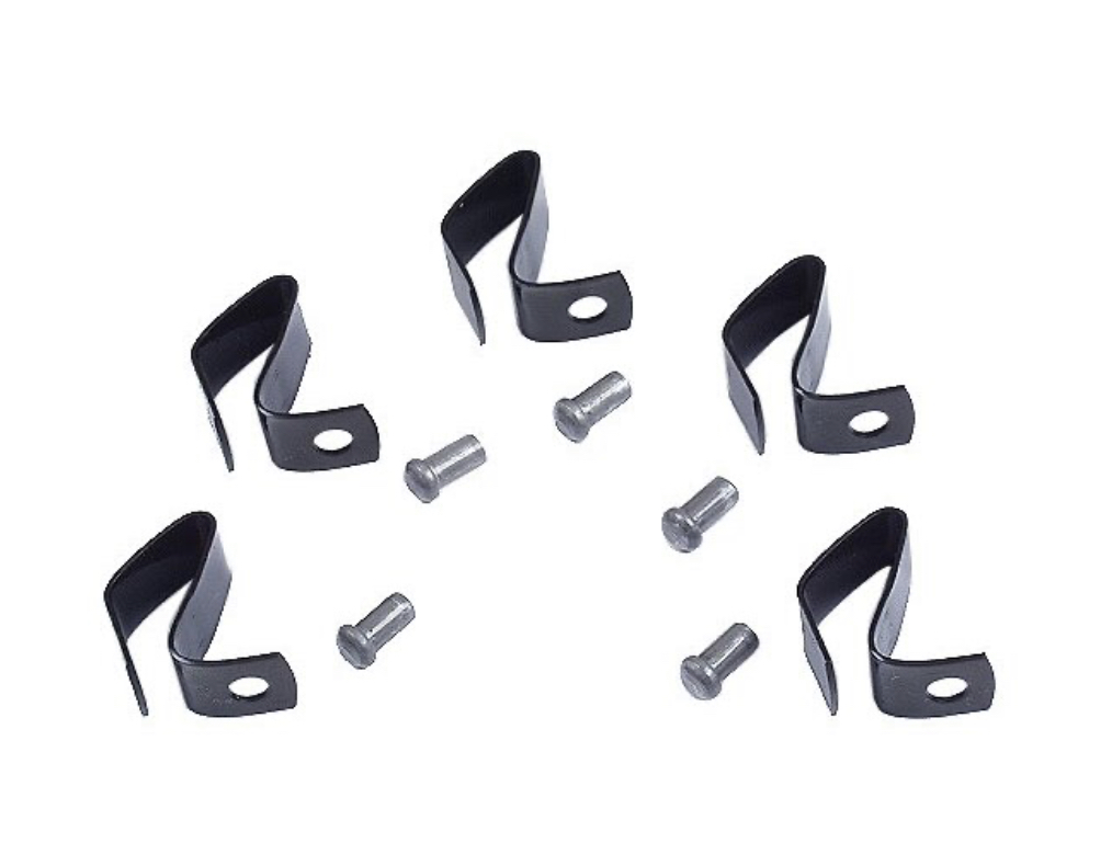

    These early VW hubcap clips are available cheap and could possibly be adapted to fit your wheels and caps.

    I'm looking for same solution for chevy wheels. Ability to run a 16" steel wheel and use a 14" or 15" factory style hubcap. @Jim Bouchard I like the clips

    I would need to get different rims for those to work. Getting different rims is an option if I could find a rim that would work

    Mount one of these to the wheel and bend a piece of flat stock to fit inside the hubcap. Bend it in an arch to closely follow the dome of the cap but on the inside and weld a stud in the middle, then screw on the hubcap till it’s tight against the wheel. It would take some figuring but fairly easy, once you figure out the first one the other three will be easy.

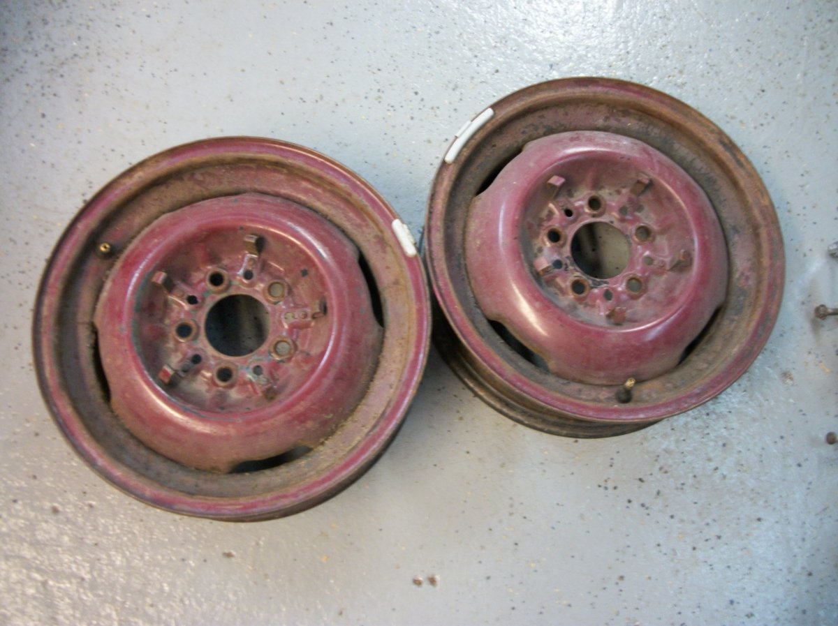

    I used a set of 1940 Dodge 16' X 5' rims on my Sedan Delivery when I first built it . 30's-40's Mopar rims use a 4.5 bolt pattern same as later model Ford 8', 9' rears (& Mustang II's) and bolt right up. The Mopar rims use "clips" to hold the hubcaps on, so I simply cut the centers out of the Mopar and Ford hubcaps and mounted the Mopar centers (with PL400) into the Ford caps so they were held on with the clips.

    I am not understanding this bit

    The Dodge and Ford hubcaps are almost exactly the same size.
    I gently pried up the edge of the Ford caps and removed the centers.
    ...and installed the Dodge centers into the Ford Caps, gently tapped down the pried-up edge...and they now clipped onto the Dodge rims.

    Also, I used some PL400 to guarantee that the Dodge centers were tightly secured to the Ford caps. Ran them for years with no issues.
    Hope this helps
