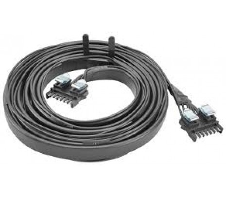

    You could use trailer wiring kit or something like this. Its listed as chevelle wiring harness. hi210.jpg
    catdad49 likes this.
