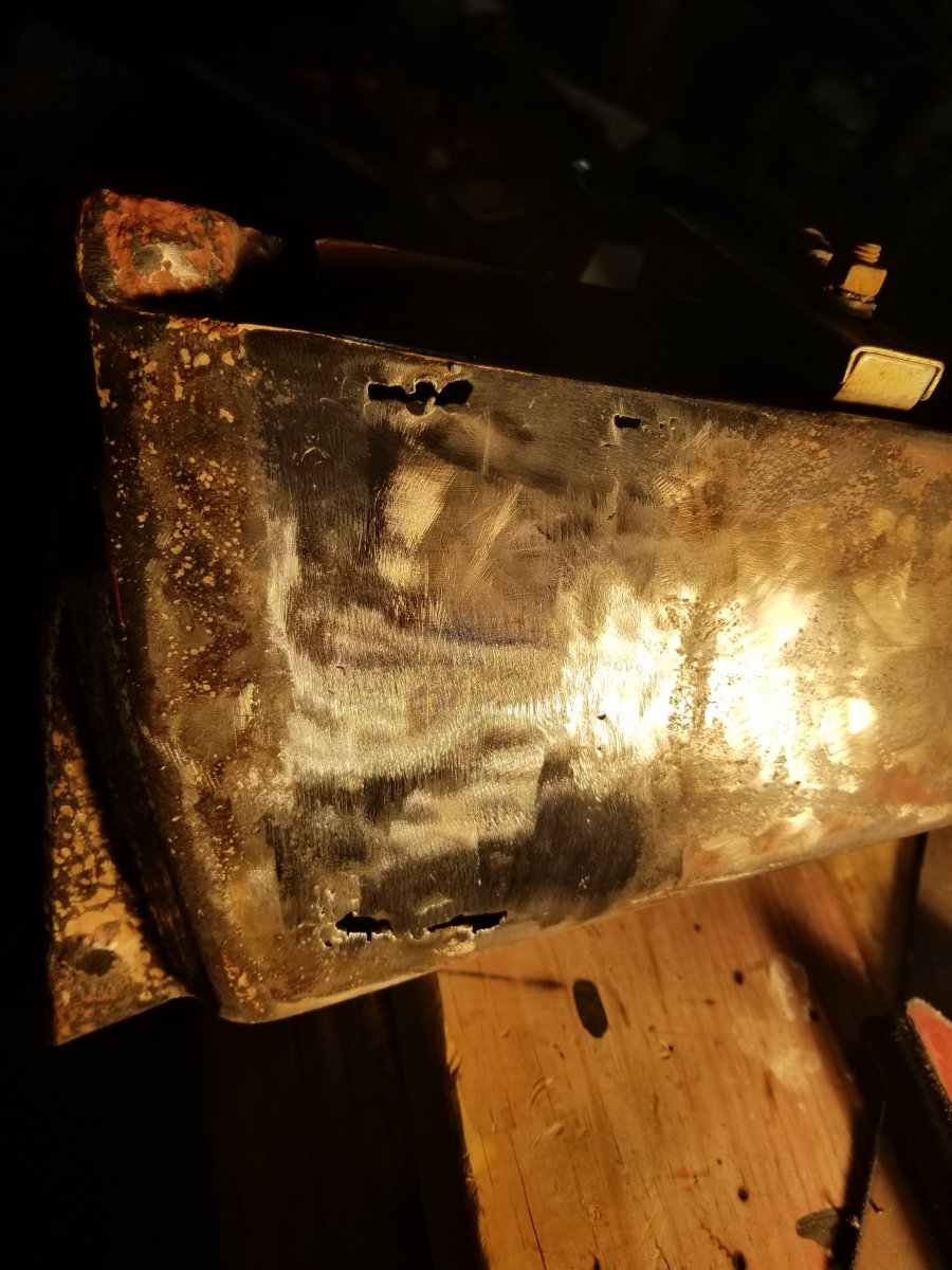

    My Coupe body is totally in pieces from various donors. I just took the roof pieces to get blasted and primed. While they are there I decided to try my hand a some patches that I can do with out having to have the body together. First patch completed today the bottom of the A pillar. Don't laugh at my hack job cutting the area out haha. I did it with a big cutoff wheel. Need something smaller, dremel maybe?
    Anywho, I got the patch in and ended up chasing some thin metal area blowouts and couldn't close a couple holes. I was using .030 wire. Will .023 be kinder on these areas? If not I will just cut more out. Stay tuned folks I'm sure I will have lots of questions a this is my first real ground up build. 20180424_150358.jpg 20180424_155656.jpg 20180424_162842.jpg

  2. .023 with gas is better and back it up with some copper or brass bout 1/16" thick.

    Yes TexasWebb is right on.
    Find yourself a nice size piece of copper or brass and clamp it in place to back up your weld when filling a hole as a result of thin material. Be patient. Let the weld cool before adding the next round.
    Move around on your patch to prevent warpage cause by too much heat in any given area.

    Will give it a shot. Just grabbed smaller wire. Thanks

    I use ER70S6 023 wire . Get your self some scraps and practice on that. Brass or Copper back works great. All the MIG welders I have used I tend to pulse the trigger when welding thin metal. It just takes practice, on a pice of scrap practice stacking beads and you will get the hang of it. Watch Jody on welding tips and tricks he has a new video every week , he does MIG Stick and Tig.

    Your finish welded and ground patch looks very good to me. I only use .024 on sheetmetal, I think it's much easier to deal with on thin stuff.
    Chasing blowouts is fairly common on rusty stuff, sometimes it means you're not cutting your patches out big enough, but when you're doing a box section and you can't see the back side, that gets much harder to judge.
    Better to blow it out and find the thin spot so you can fix it than to never find it and have that be the first rust-out to come back.

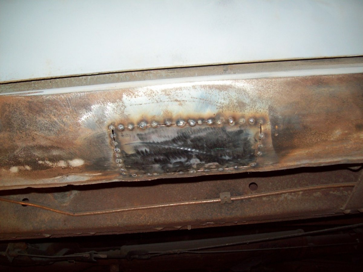

  18. I don't have any finished pictures before grinding but on my '51 this is the tacked in section. 106_0066.JPG
    You want to do small areas and move from top to bottom side to side every spot.
