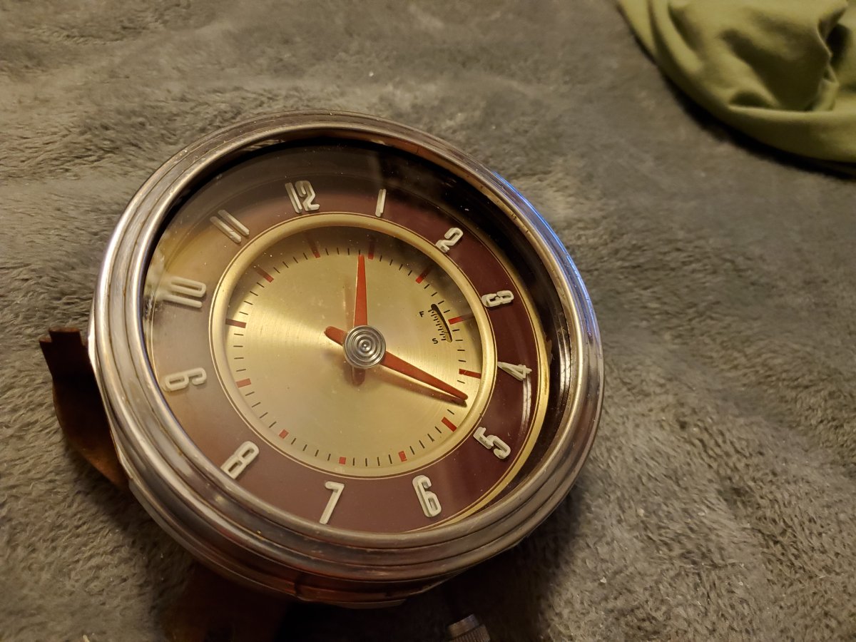

    Actually its my second attempt. First attempt wasn't centered.
    I put a 1946 Mercury dash in my 1935 Ford 5W . I wanted a tach but there's very little space so I converted the clock to a tach using a cheapo AutoGage tach. I needed at tach with a removable needle so I could use the long hand from the clock. This matched the speedo . The numbers are all I could find. Seems gothic number decals this small are uncommon. My plan was always to send the glass out to get numbered as factory for that 3D look. Anyone know of a HAMB'R that does such ? I found a guy on Ebay but like to support the HAMB when possible.

    Looks real good! And honestly, the numbers aren't that dis-similar to the factory clock numbers, I would run those without issue. I might ditch the big RPM lettering on the face though. How did you get rid of the little slot in the clock face?

    I had two clocks and used the best of both. The other clock didn't have a slot. I agree with you on the RPM. IMO its a little big. On the new glass it will be smaller as will the numbers.
