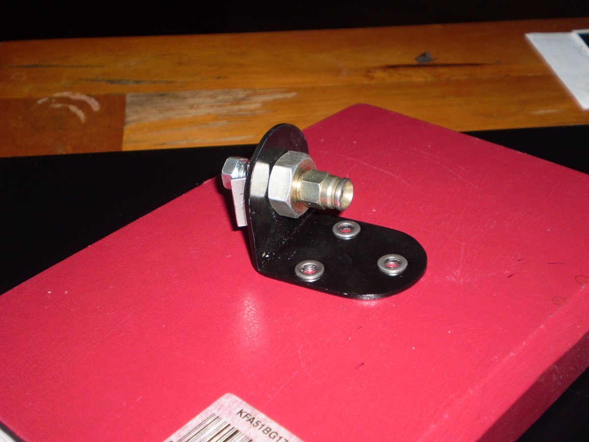

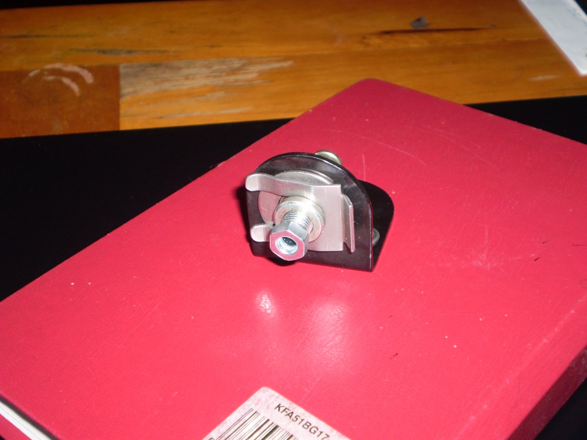

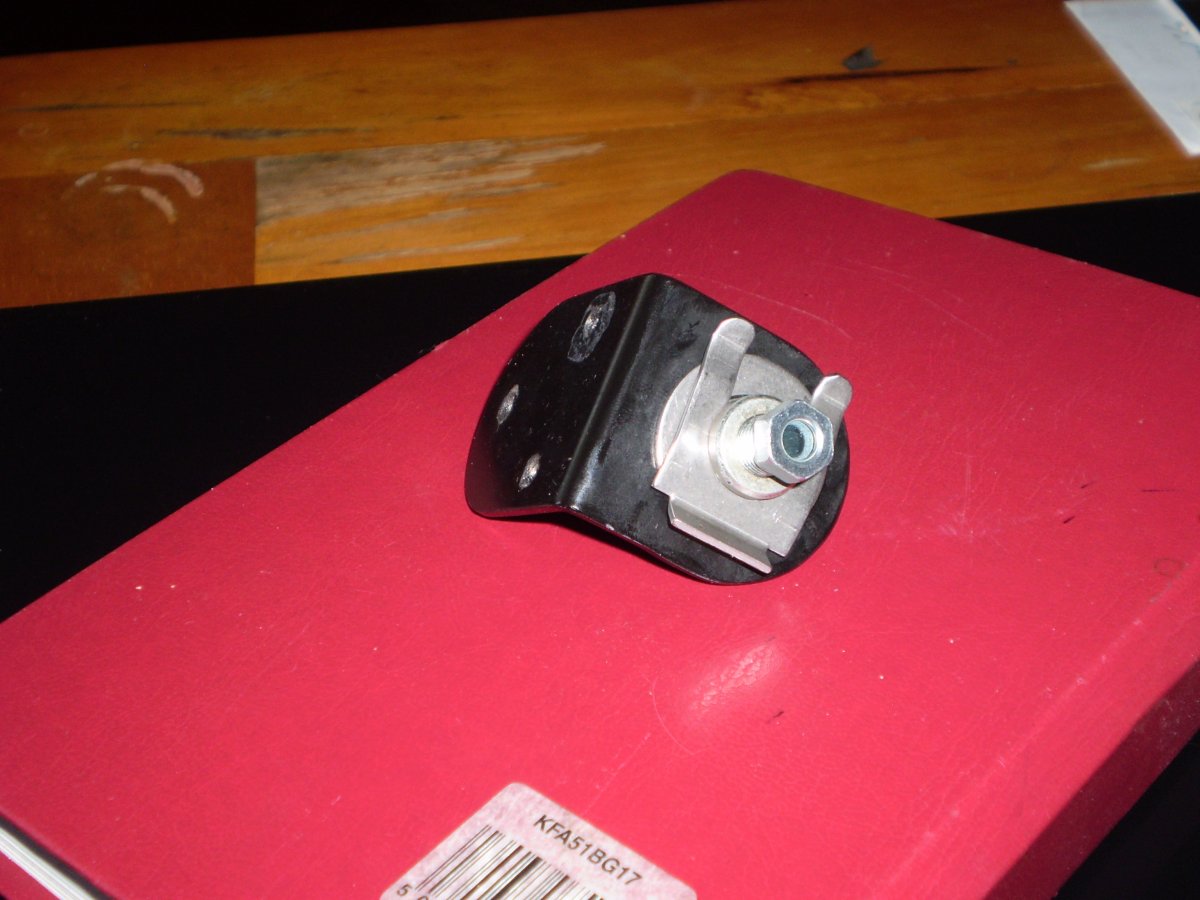

    brakeline support bkt 002.JPG bracket by owner/ducafe to hold brake fitting.fitting required 3mm bracket to make the clip work,but made it in 2mm steel and used a 1mm thick washer in s/s around the fitting to protect the paint brakeline support bkt 001.JPG brakeline support bkt 003.JPG stainless clip is from TOTALLY STAINLESS
