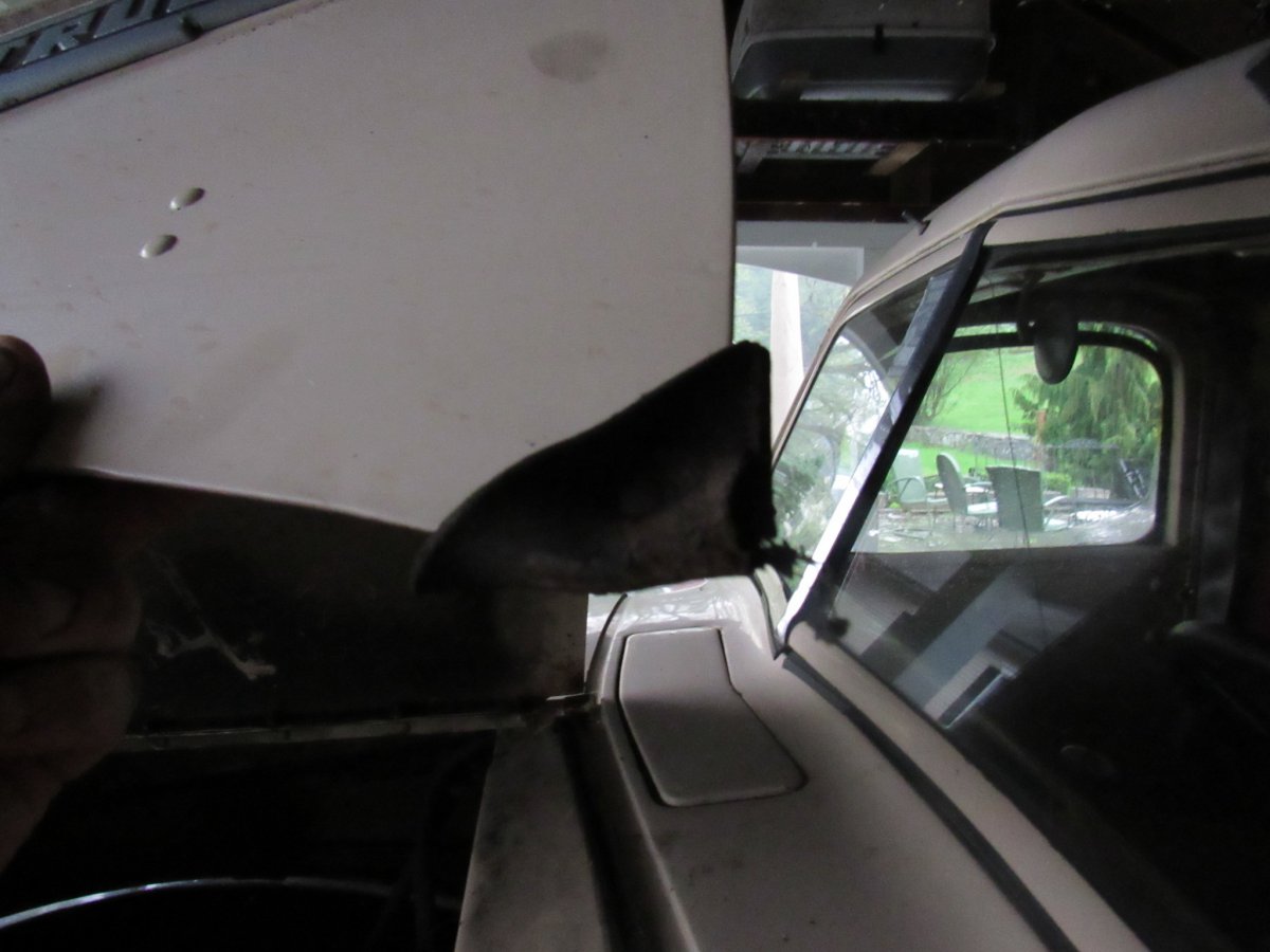

  15. the rubber ones I bought when I first built my truck lasted about 4 months before they started to fail. these leather ones have been on ever since, and now that I look at them they are really tired. I guess after 28 years and over 100k miles I shouldn't be too critical. IMG_5031.JPG IMG_5032.JPG

  16. Nice patina, or is that mold?:p Sorry I have been in the house too long.:confused:
    Bowtie Coupe likes this.
  17. yep, that same stuff that grows on the tree bark.........maybe I should wash it..........
    Bowtie Coupe and ct1932ford like this.
  18. NOOOOO!:eek:

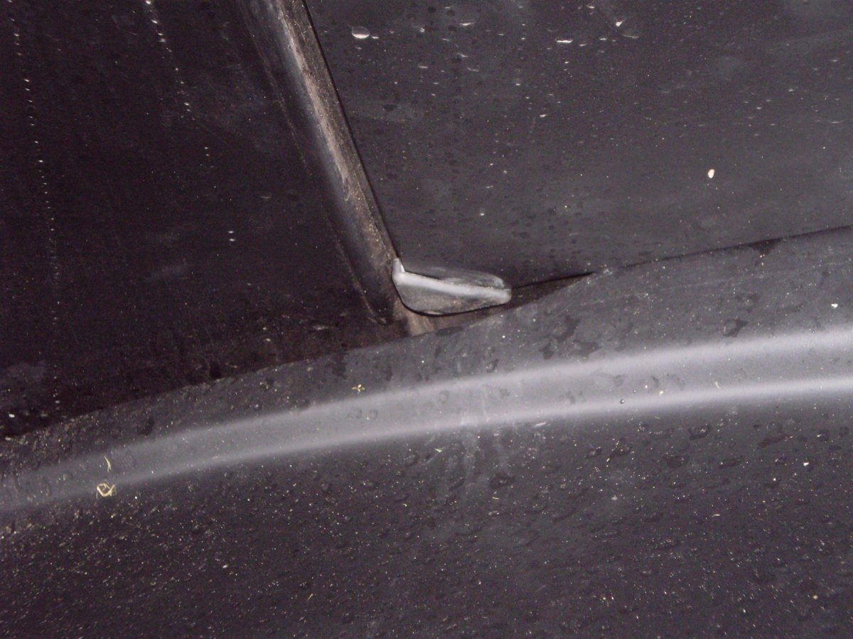

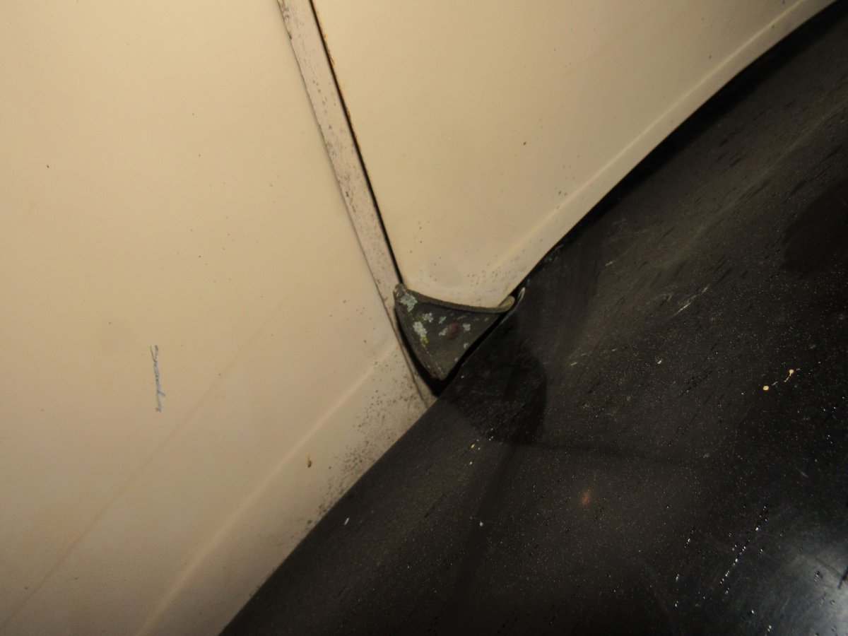

    one is better than the other might try impact glue maybe superglue rubber hood corners 001.JPG rubber hood corners 002.JPG

    wayne the rubber looks like its not sitting right..the edge of the hood should sit into the grooves in the rubber.![​IMG]
  21. Wayne67vert
    Joined: Feb 23, 2012
    Posts: 108
    Wayne67vert
    Yes, it won't stay seated. I need to drill out the rubber hole and use a rivet to hold it.

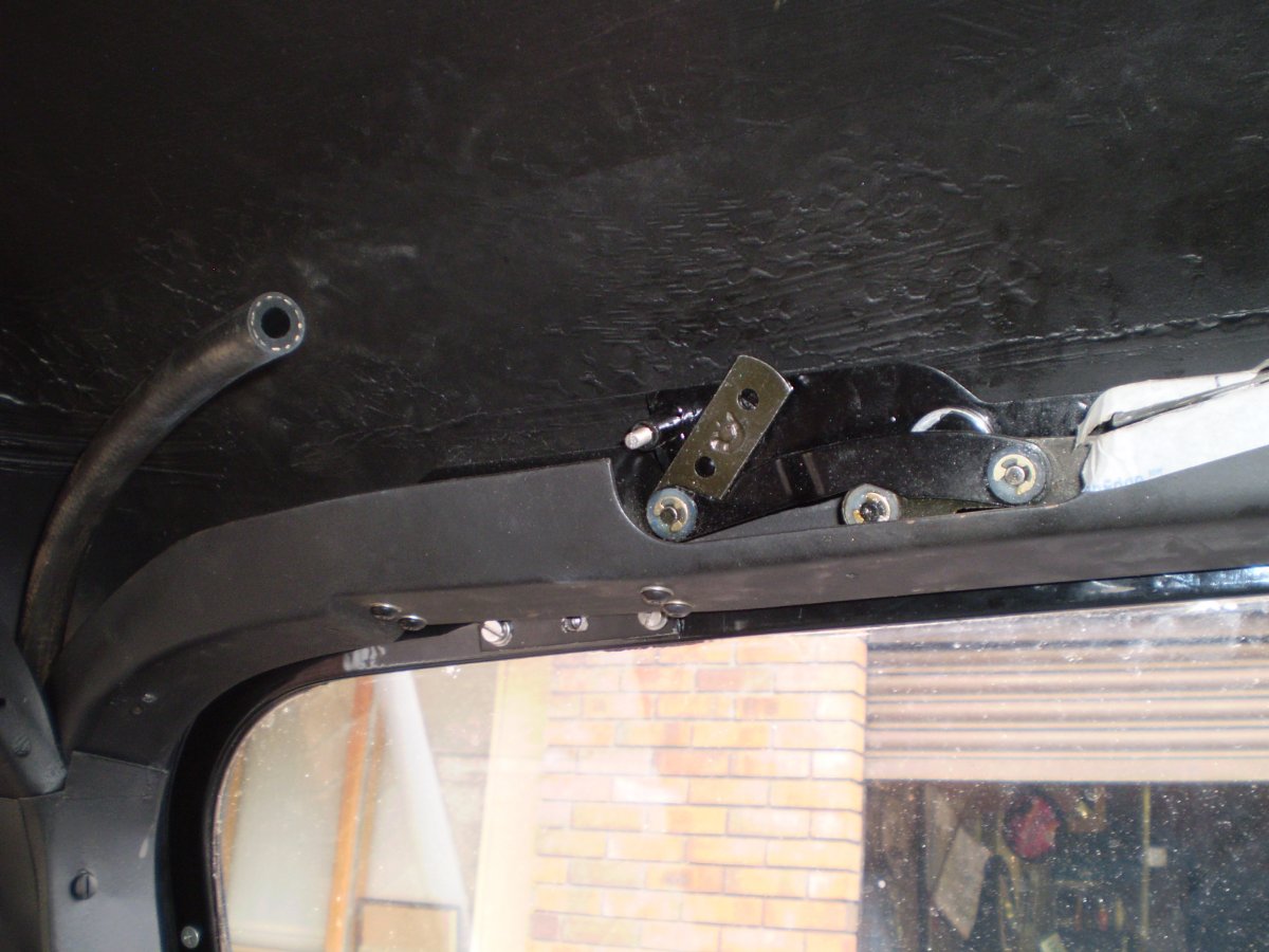

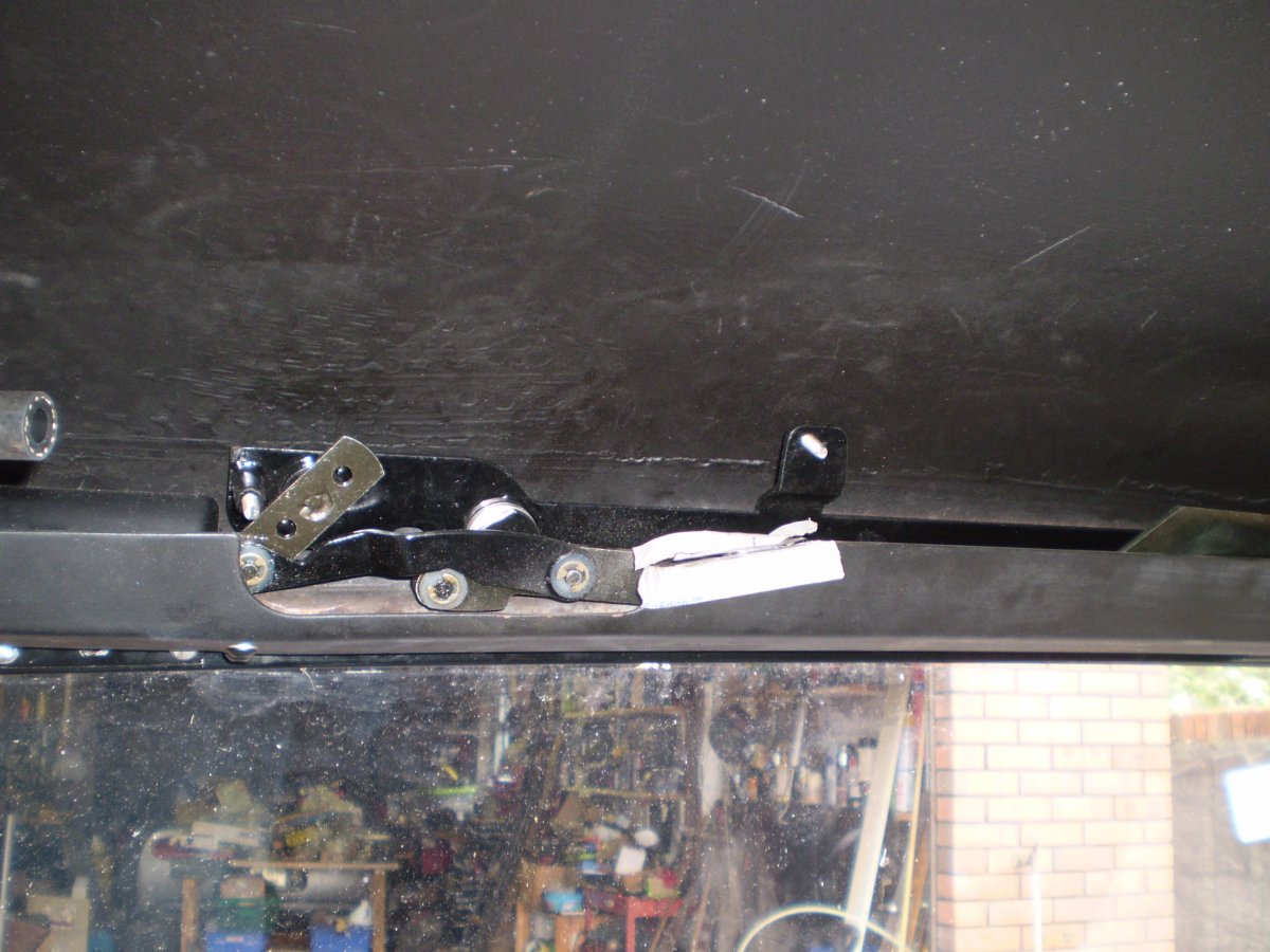

    today made a start on fitting the Newport wiper kit.purchased the switch with intermittent delay.fiddly job and definately a 2 man operation involved taking out the screen to mark the cab for the holes .they had to be opened up to suit the new kit came with a good metal jig to mark out the holes.truck had vacuum operated wipers ,couldn't rely on those.nearly done just some wiring and fine tuning to finish.thanx ciarain.

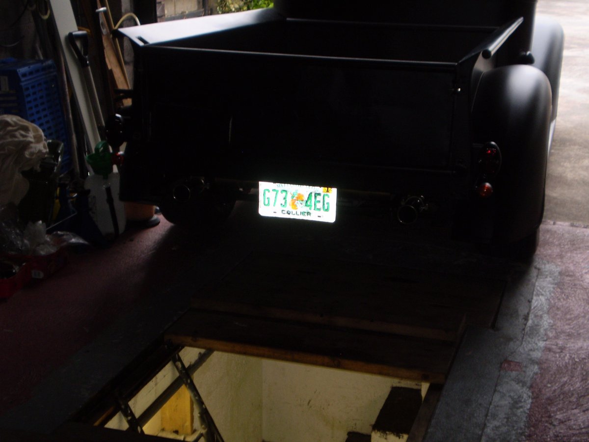

    did a bit to the number plate bkt today.got it assembled but needs paint and some finishing off.number plate light is in the rear bed crossmember .if I dropped the fuel tank I could have done this quicker but its half full and that's a rare occurance. rear no plate trial run 002.JPG to keep it compact fuck it just realised with the rear bumper fitted it will be in the way 1 step forward two steps back.have to dry run the bumper tomorrow.
