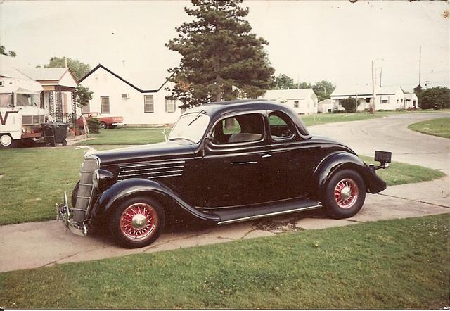

    I love spoke wheels, I had a set on my 35, they where red with chrome spokes. :D
