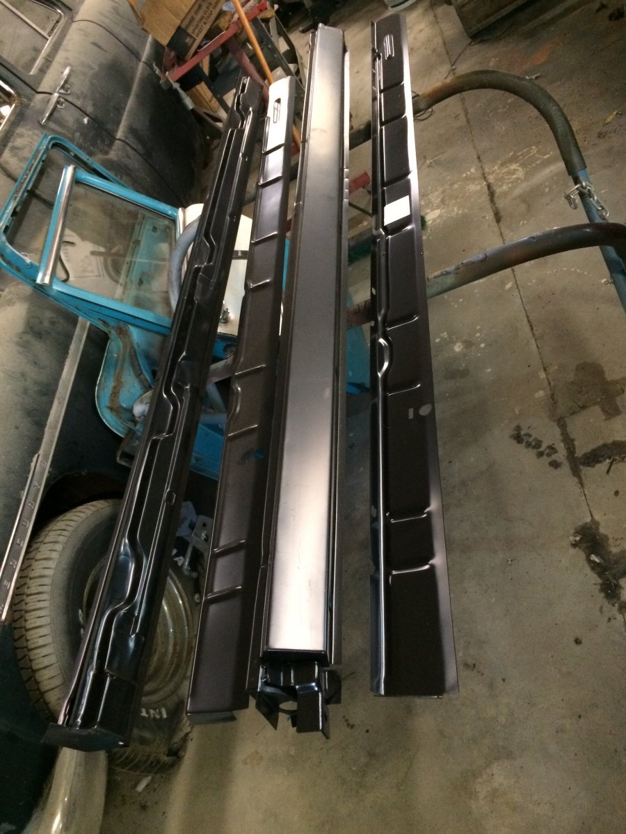

  1. These inner and outers are supposed to be correct full replacements. We shall see

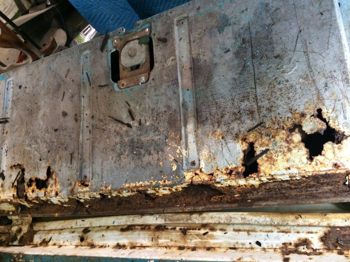

  3. Feel like I hit the lottery with this rear floor

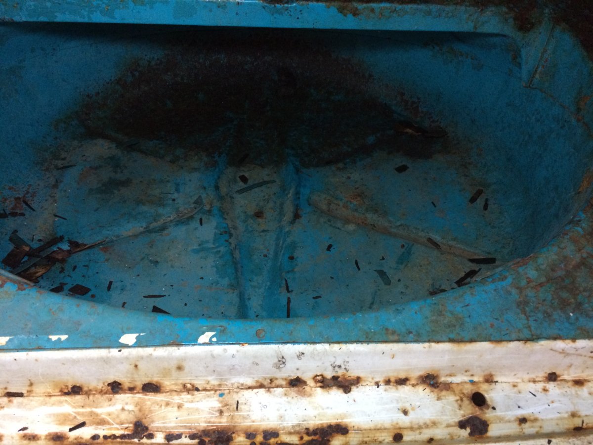

    Here is the worst part. The inside of the rear gate is bad

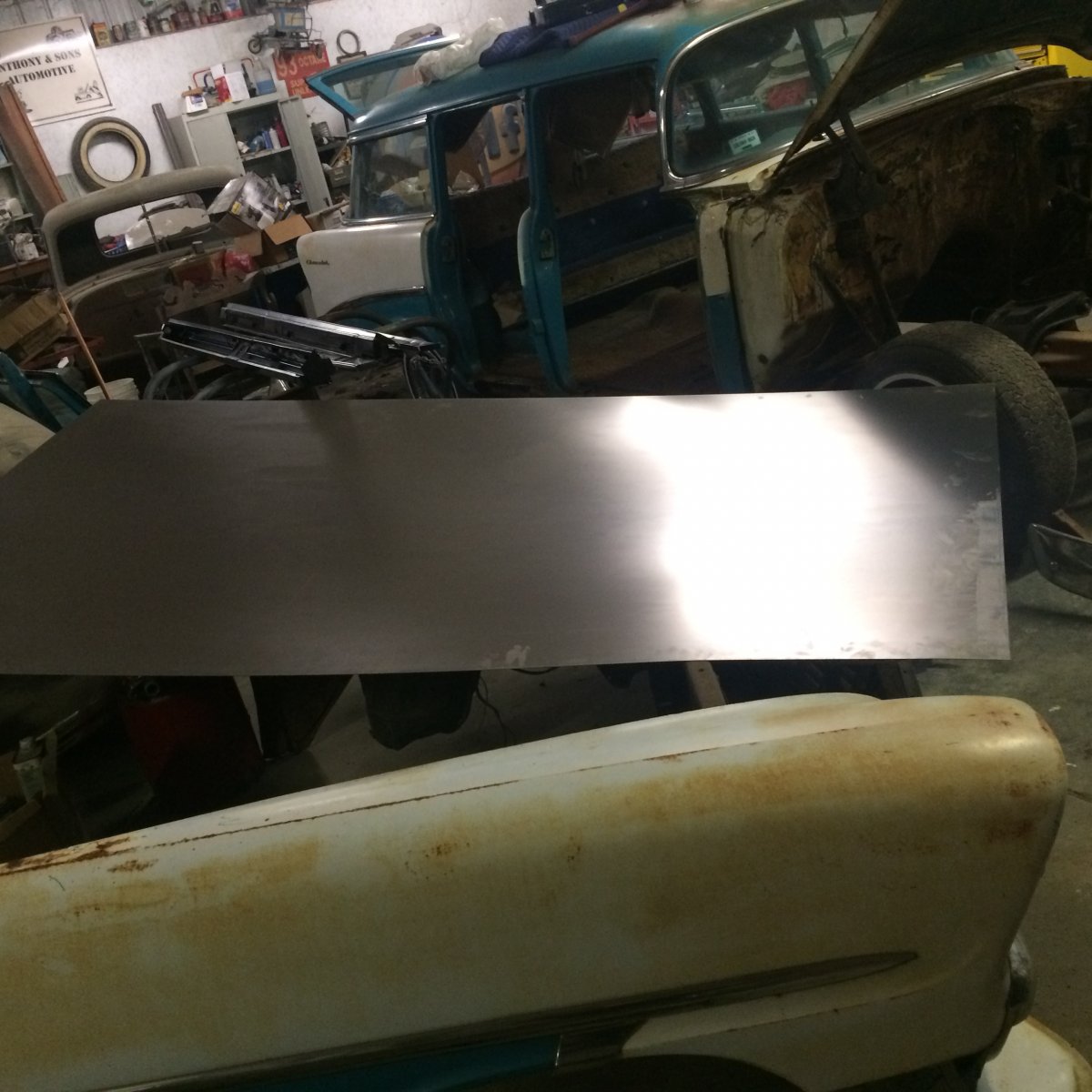

  11. Got the rest of the sheet metal parts today
    That should finish the floor, rear gate and dog leg

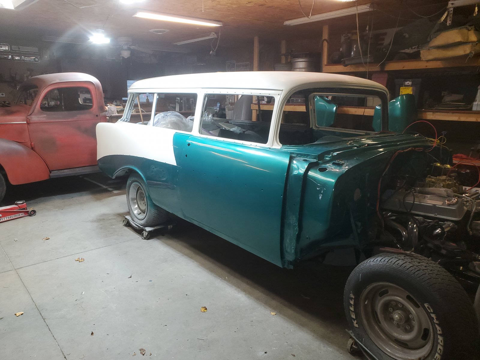

    Here is my 56 that I've been building for a few years. Like you, my wife likes old vehicles too, you can see her 40 Willys pickup behind the 56.

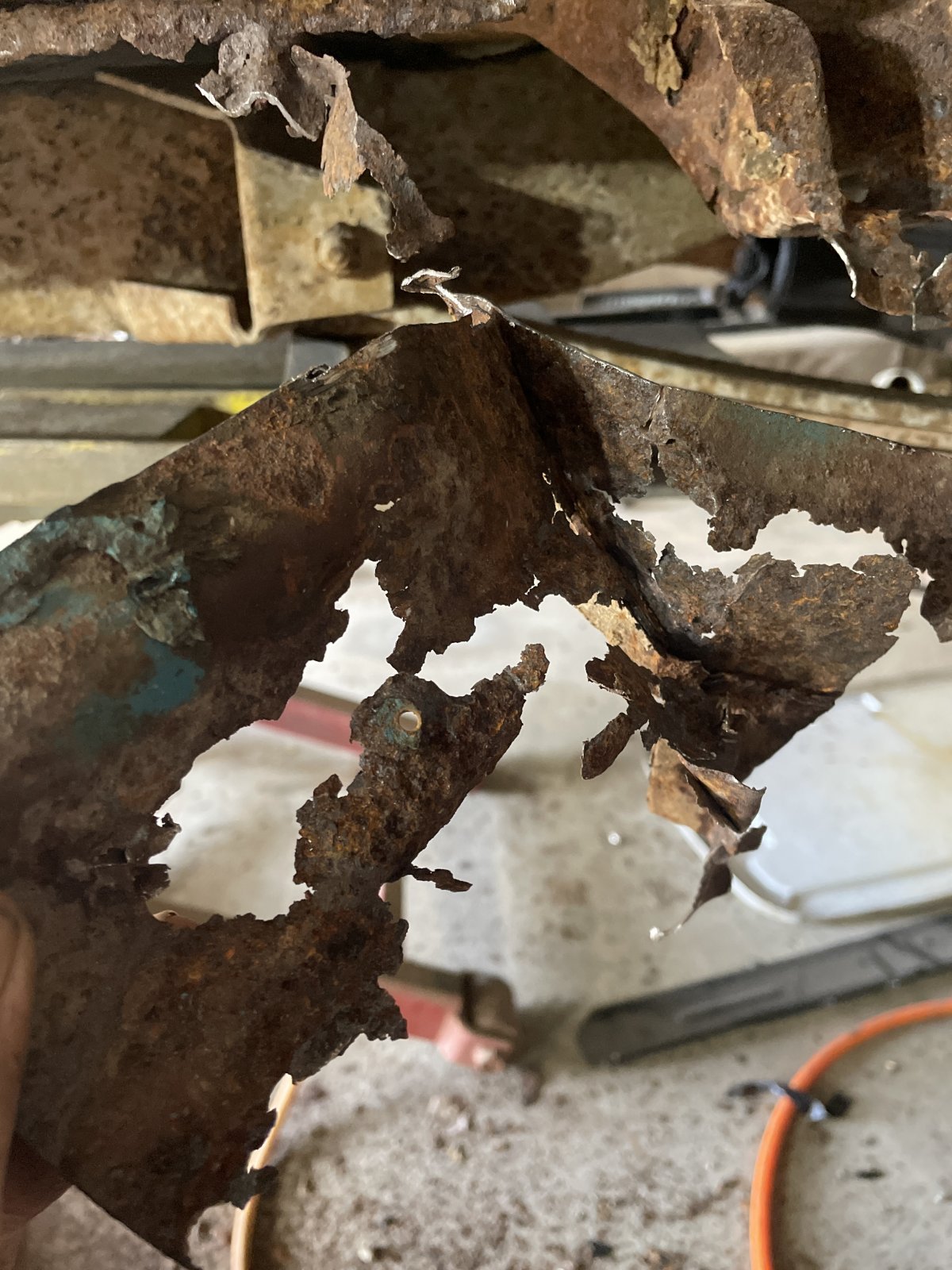

  21. Messing with the dog leg.
    BCEC8BF4-4567-41A2-9A38-87B51629C326.jpeg B8162A39-028D-4109-89FA-8B573F90BAFC.jpeg 9BB4997B-E28D-4D69-9225-101CC5A52933.jpeg

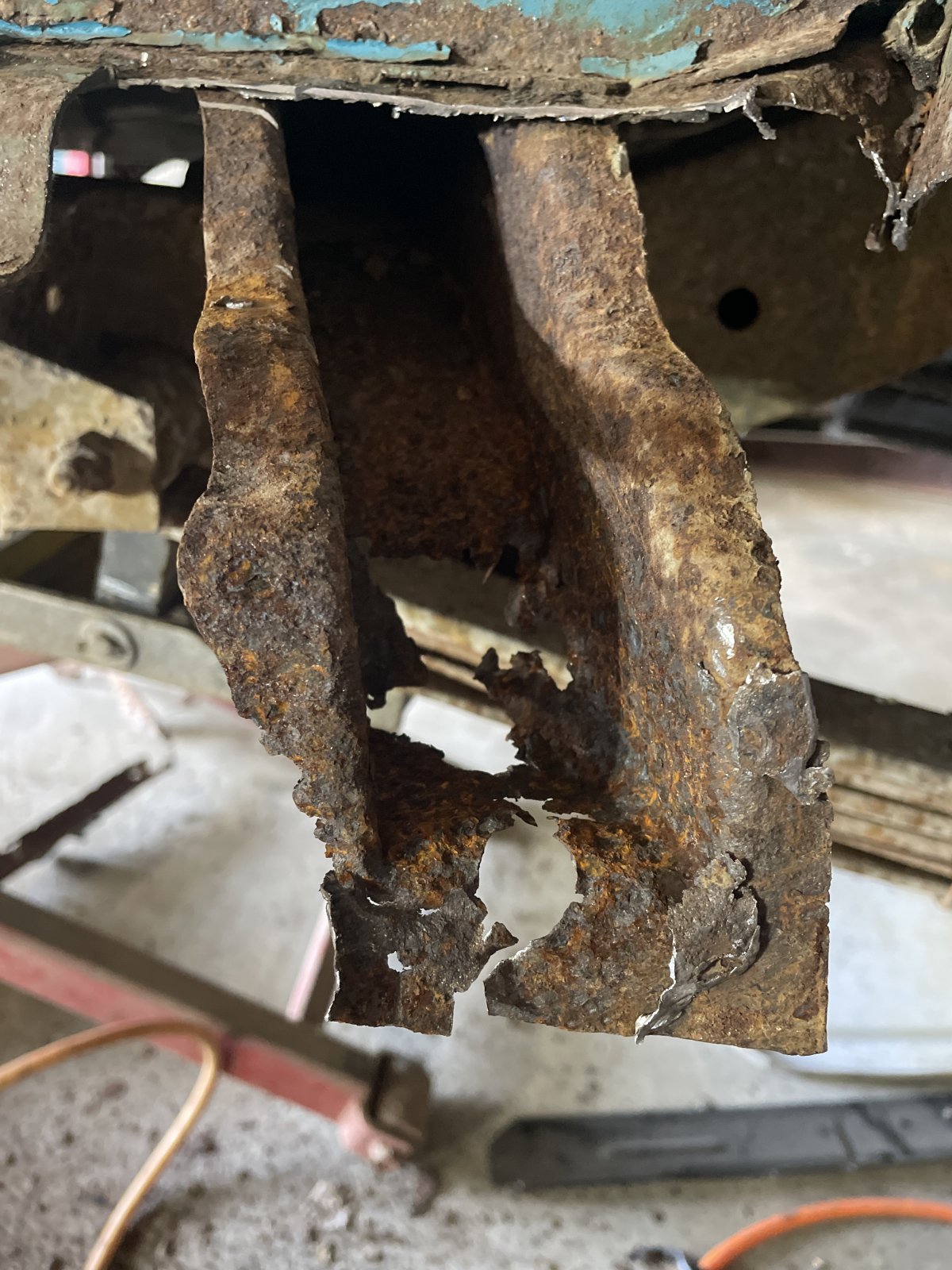

  22. E63F79AD-C2F0-4FE3-94BF-8B8F70994E2C.jpeg The inner dog leg. Gone.
    it won today. But I’ll be back tomorrow

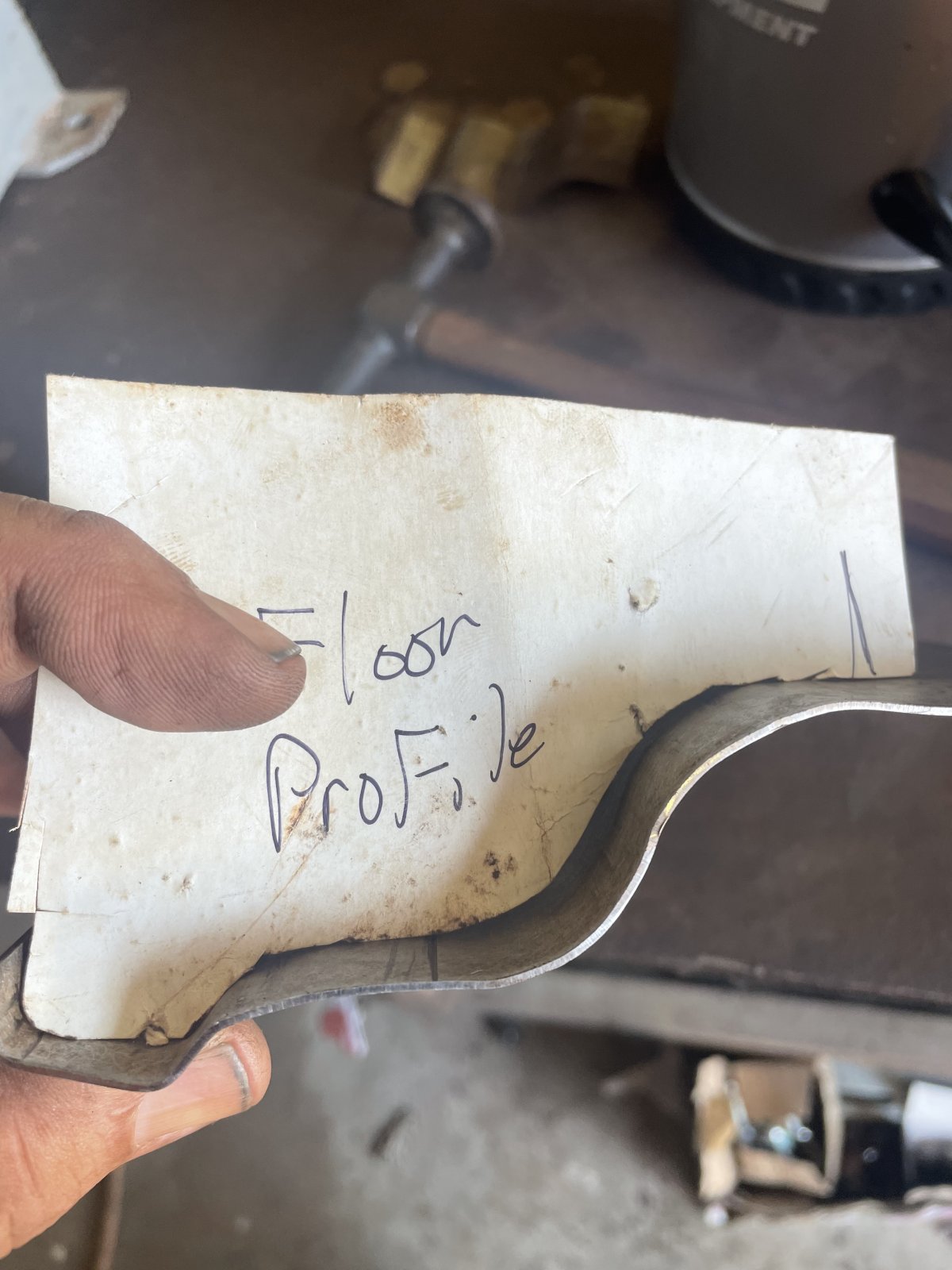

  23. Spent 1/2 the day cleaning off my work bench. I haven’t bent much metal at home for a while.
    Either at a friends shop or school. I rounded up my tools from other shops and school as well.
    so after lunch I picked a part and tackled it.
    The floor piece between the seat frame and rocker was gone. So I made a simple profile pattern and overall shape pattern from the other side.
    D38684F6-B3B6-4D75-8976-99EE0D6EEB58.jpeg DA61F65A-64F8-409A-93D3-4B0D378F401D.jpeg
    Scribble marks figuring out the bend then made a practice piece.
    figured out the bend sequence.
    the radius doesn’t follow out to the end and hammered that shape after bending.
    the folded the flange down.
    Pic looks a little funny. I usually DA sheet metal before I bend it.
