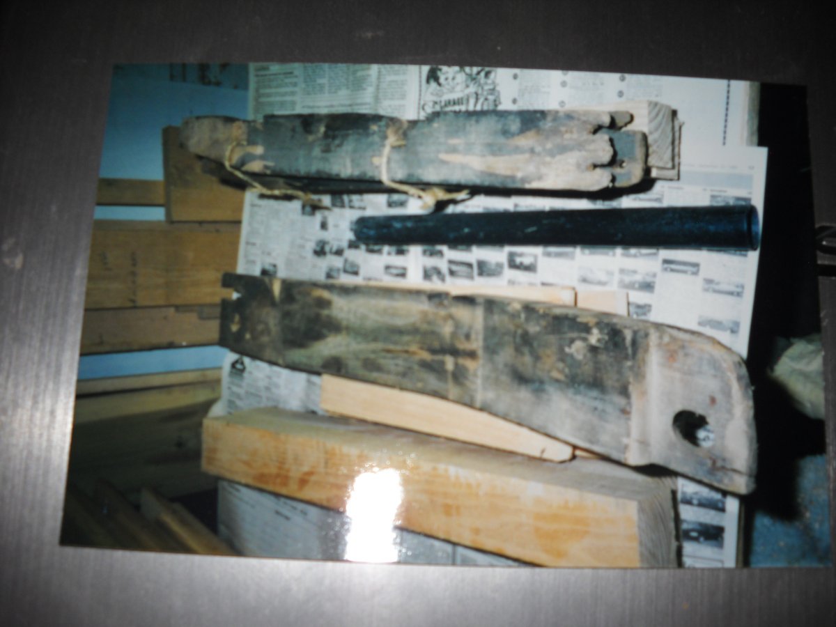

    That is a very good fit in pic's. Great pic's. of that also! On the metal rap around the seat Is that a flange, or is that a piece of the seat wood still attached? (I have copied these pic's to your file on my computer, so I can go in and adjust the pic to see better.)

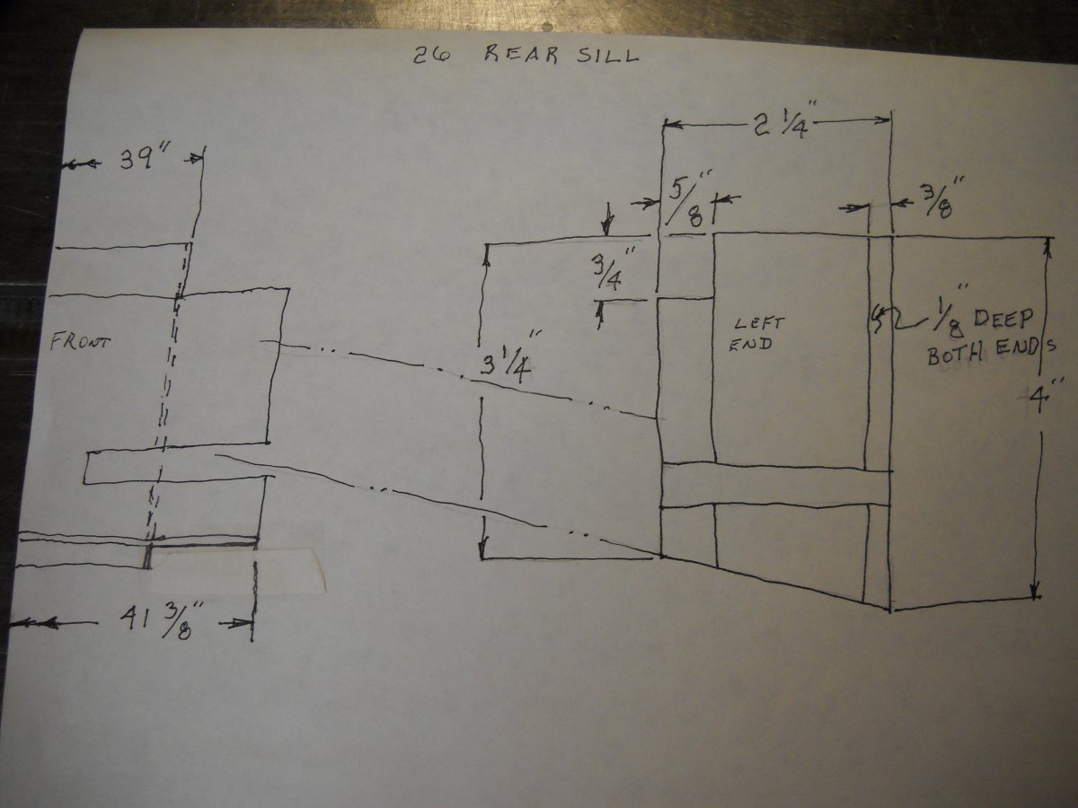

    When you said "The back is 4" high and the back is 3 1/4"." You were referring to the rear sill? 2 1/4" front to back and 43 3/4" max length. The 1/8" x 3/8" rabbits for the sheet metal to fit in really tells me a lot!! I can now make my rear sill cover!
    I am sorry that I got you off track for the dims. that I needed, but the last ash that I picked up is not the quality of what I bought 20 years ago. Lots of nots and crooked grain next to them. I can utilize this part of the board by laminating it between two good boards like in the rear sill. I'll get the rear sill for both cars glued up and let them set for a month or so incase there is some movement.

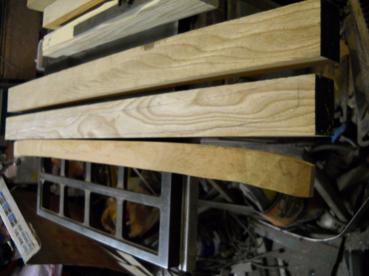

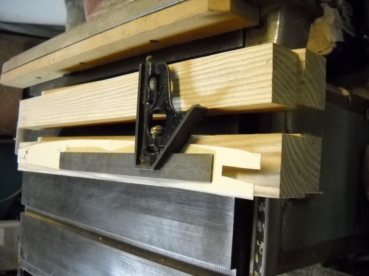

    I spent this morning prepping the rear sill boards for gluing. The pore quality center board(s) cleaned up pretty well. I did run into thick and thin on almost all of the boards, It came out with two to three passes on the planner each side of each stick. They must have planed these green. Also got the seat front support(s) blanked out and brought down to 3/4" thick. Will put in the notches to fit down into the rabbit in the sills, the small tongues on the ends, and the bevel on the top next. Did a lot more just setting looking at boards, trying to figure the best cutting and gluing. Got to think about the longest pieces first. Like the big "S" pieces in the trunk and work my way down to the sandwich block size.

    A lot is to be learned by just looking and handling these pieces. The seat metal has a small piece of wood still in it. It is held with screws. Glad you are making progress.

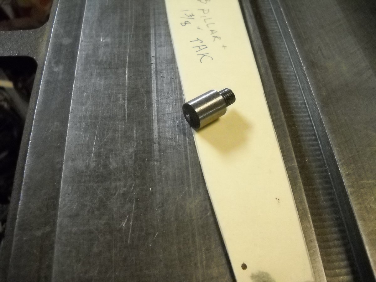

    I spent the day with my son prepping a new flywheel to drill and tap for a 10" clutch. We got the old one dialed in on the mill so we can take measurements for holes in the new one. It will be a while before we can get back to it.

    "A lot is to be learned by just looking and handling these pieces." You are so right there! And a person can lose a lot of it in 20 years, have to relearn!
    I found a few more blocked out ash. The short ones are the B pillars, but the longer ones confused me, so kept throwing them back until one rolled over just right... They happen to be the rear belt rail. I've got two trunk hinge pivot bolts started, just have to put the screwdriver slots in.
    I also skeached up the rear sill as I think that it is. Sorry about the quality, but may drafting boards left many years ago and my CAD program left about the time that I retired! Am I thinking right on this?

    As far as I can tell that looks good but don't cut up any good wood using my measurements. I get there and I think I know it all. I get home and It's all gone again. I edited the last post with measurements to put captions on the pictures so they make a little more sense I think. It took me hours to do it for some reason the pictures were not staying put.

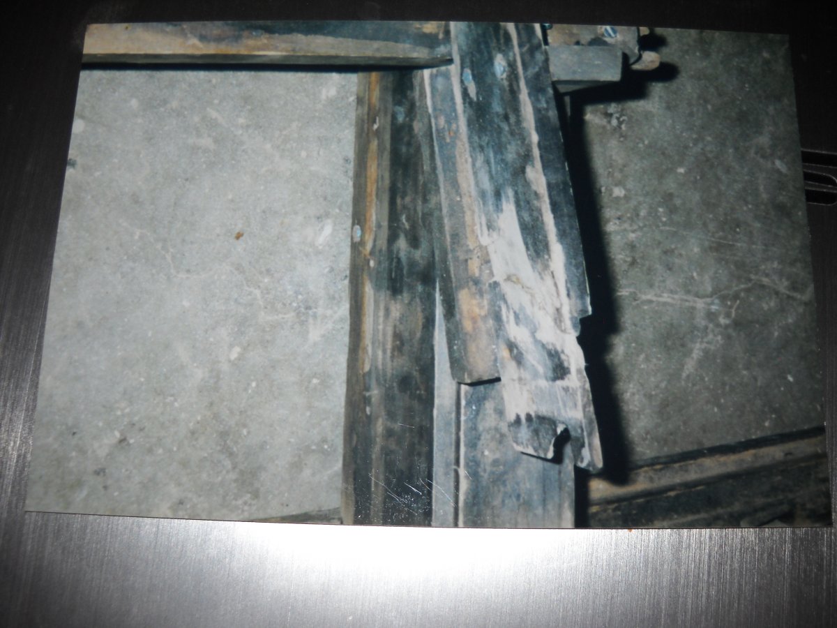

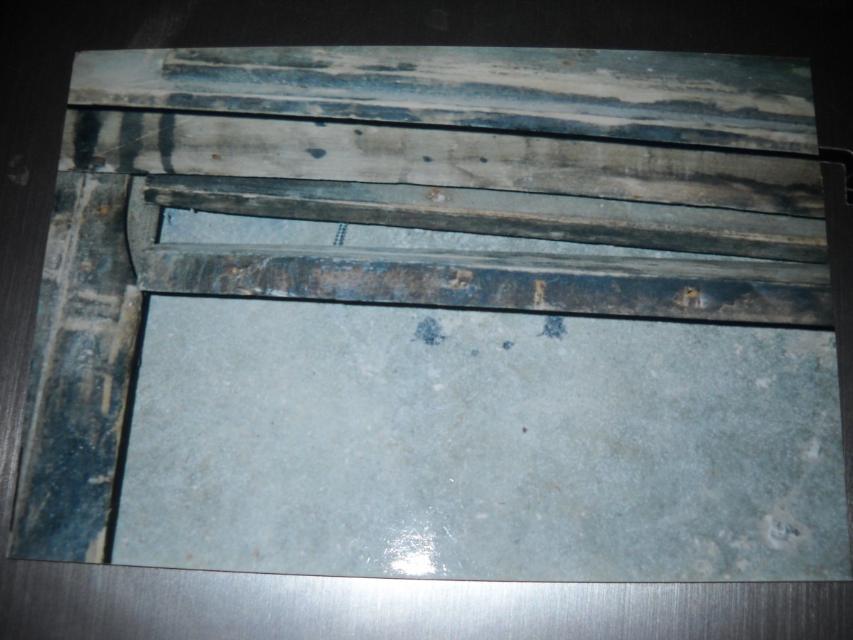

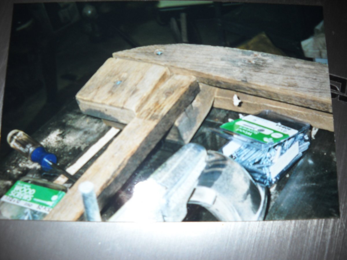

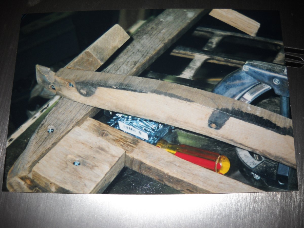

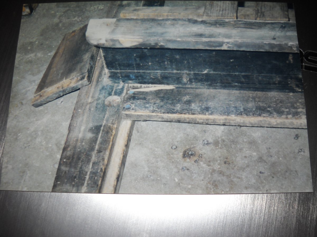

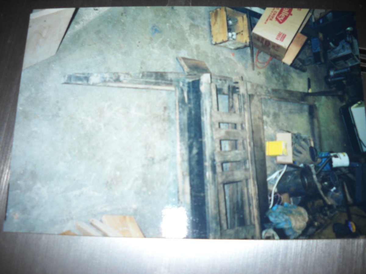

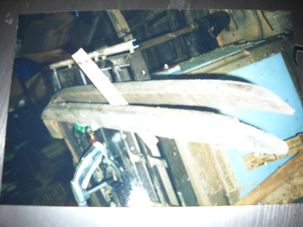

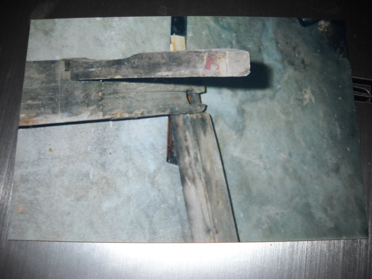

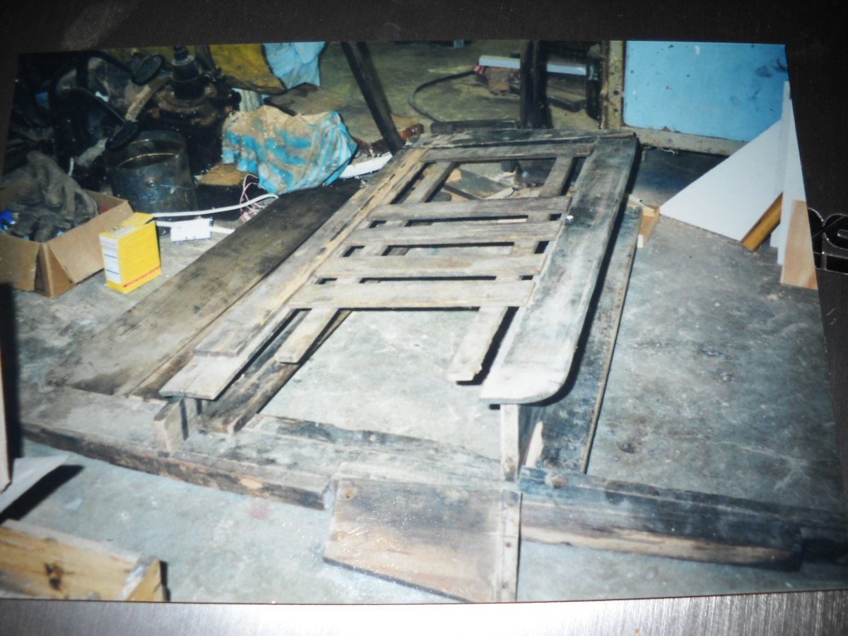

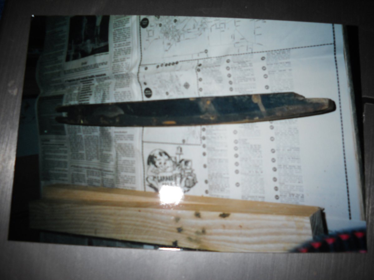

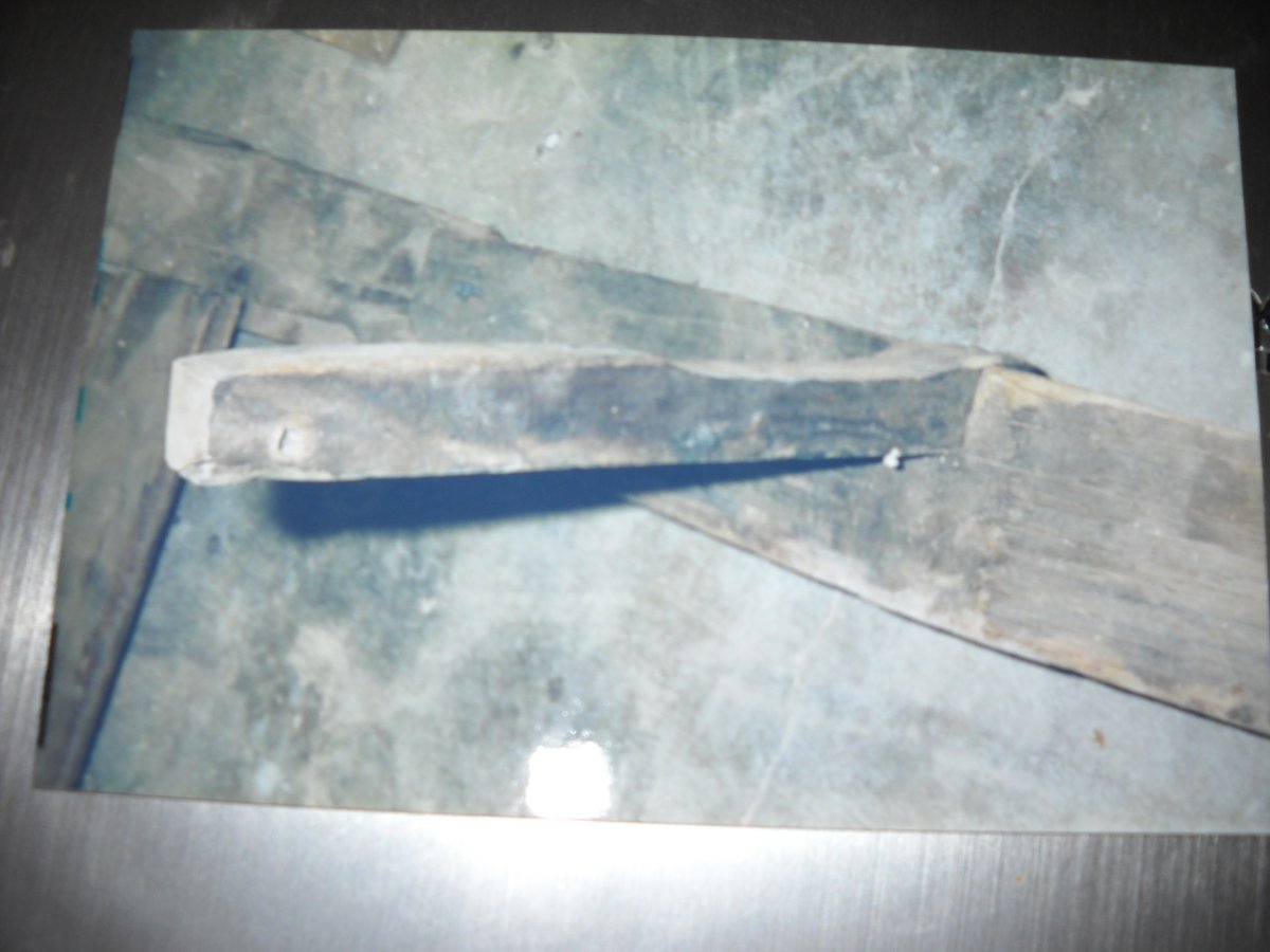

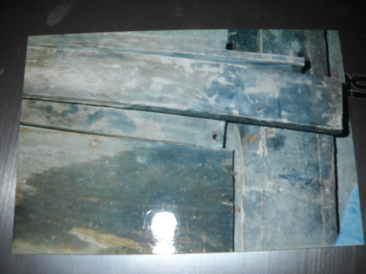

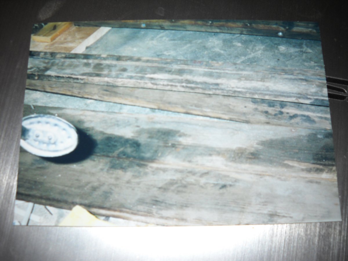

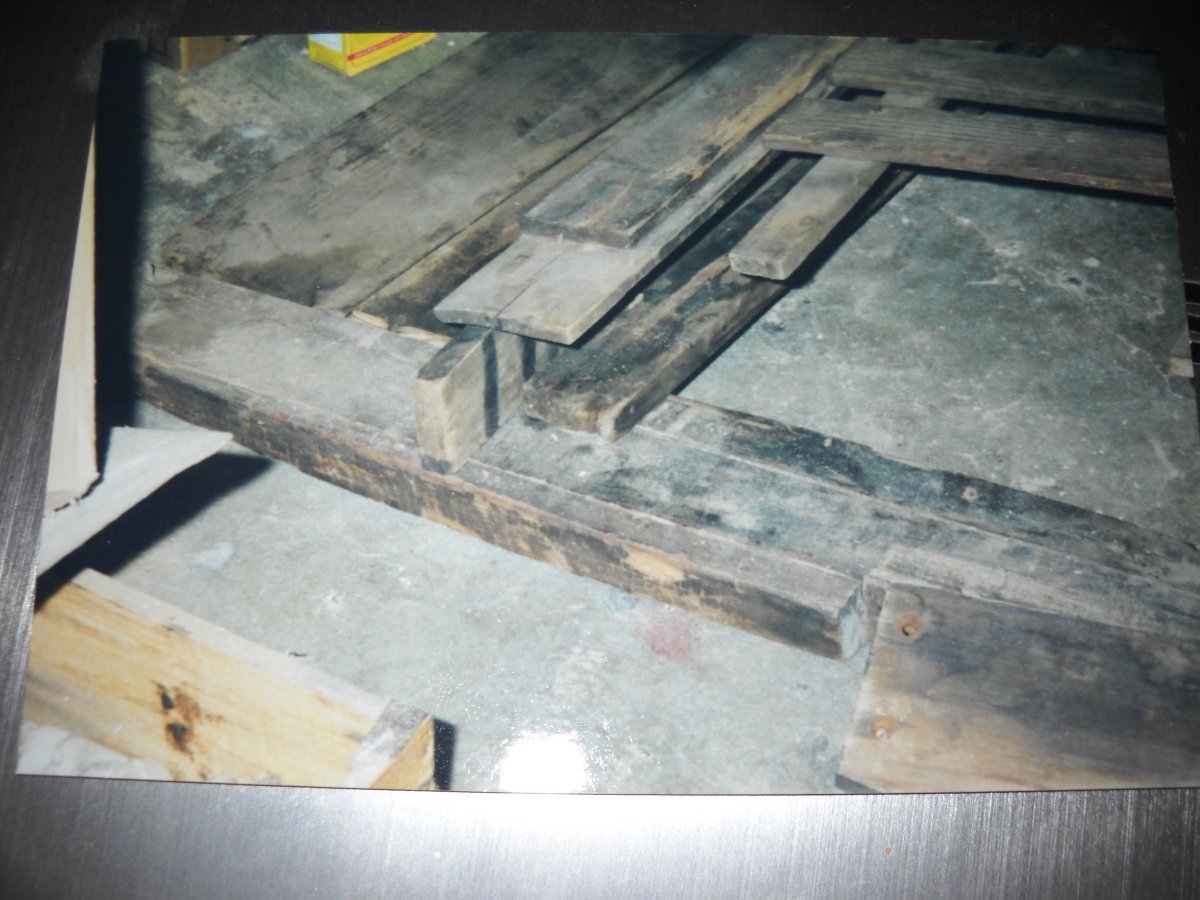

    I finally found the pics that I had taken of Ray Holland's 1925 roadster wood. Got a few up on the other sight, but it would not take the second or third page.

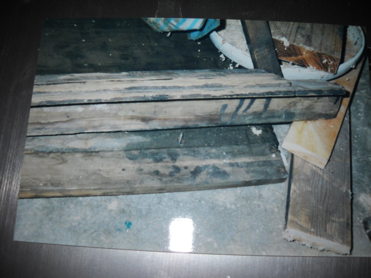

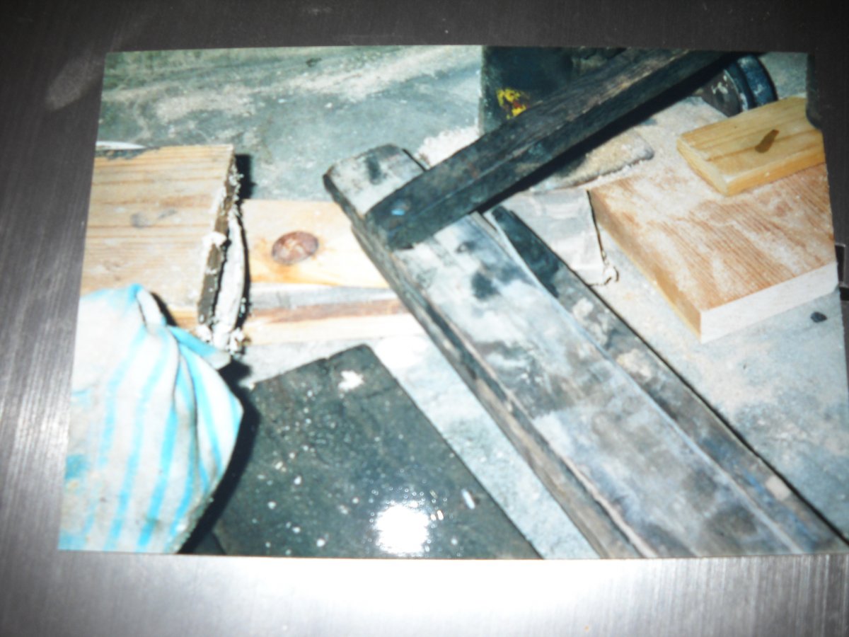

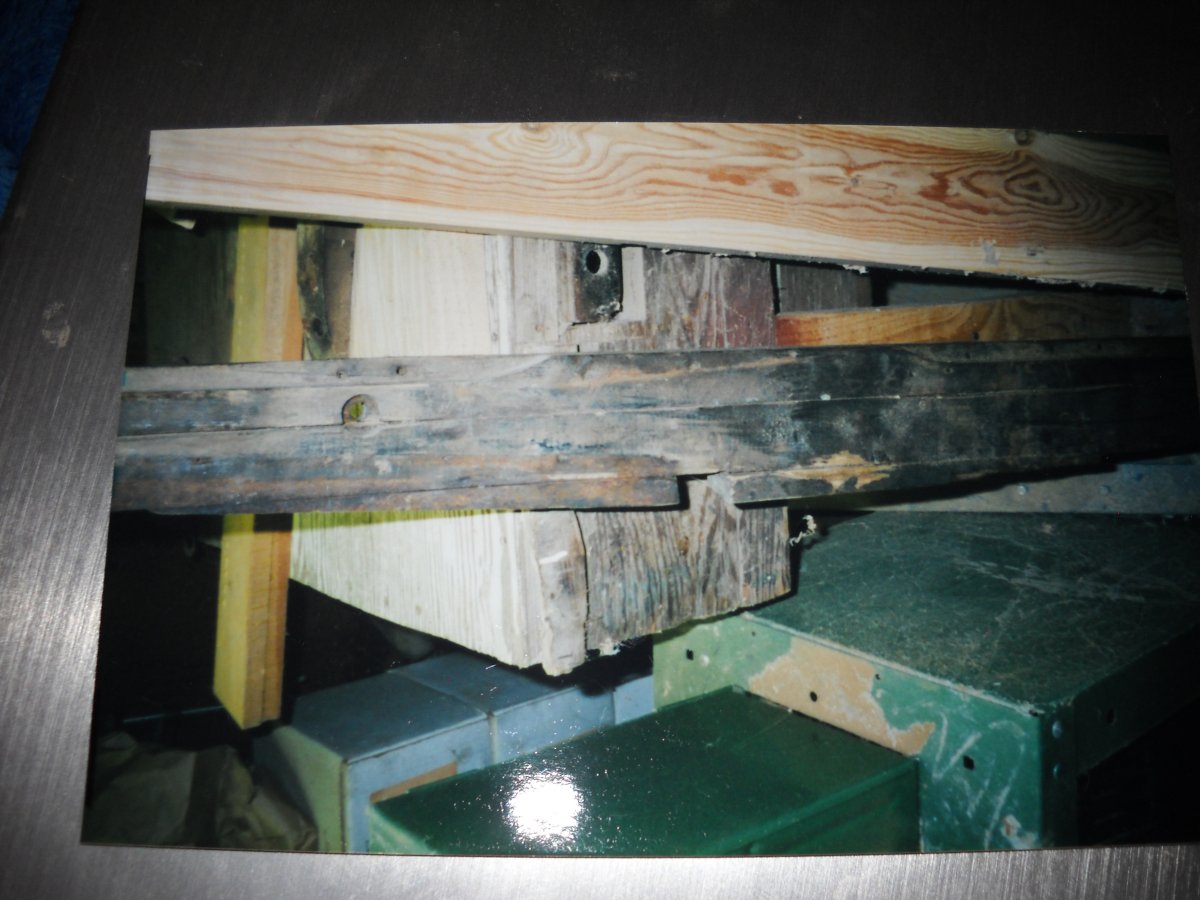

    More 1925 roadster wood
  10. grumpy gaby 2
    Joined: Aug 10, 2019
    Posts: 462
    grumpy gaby 2

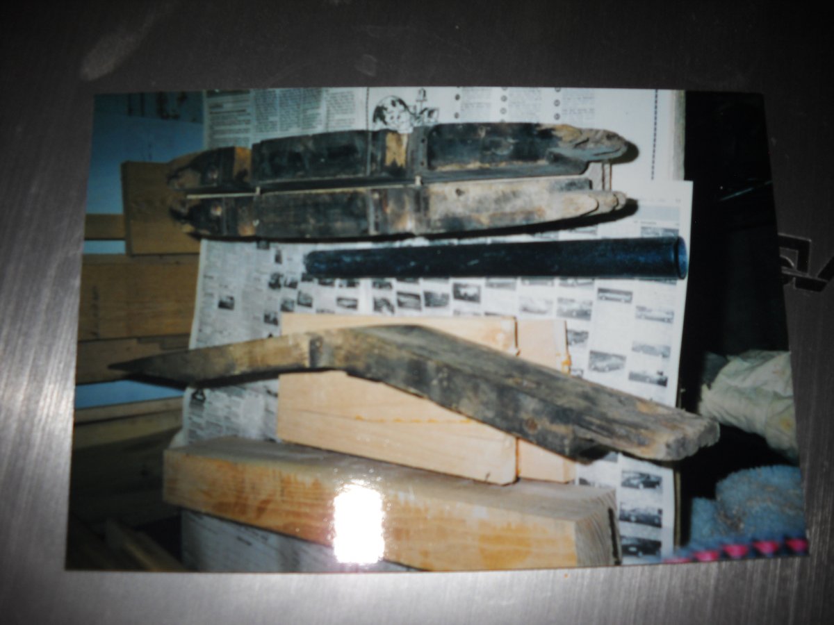

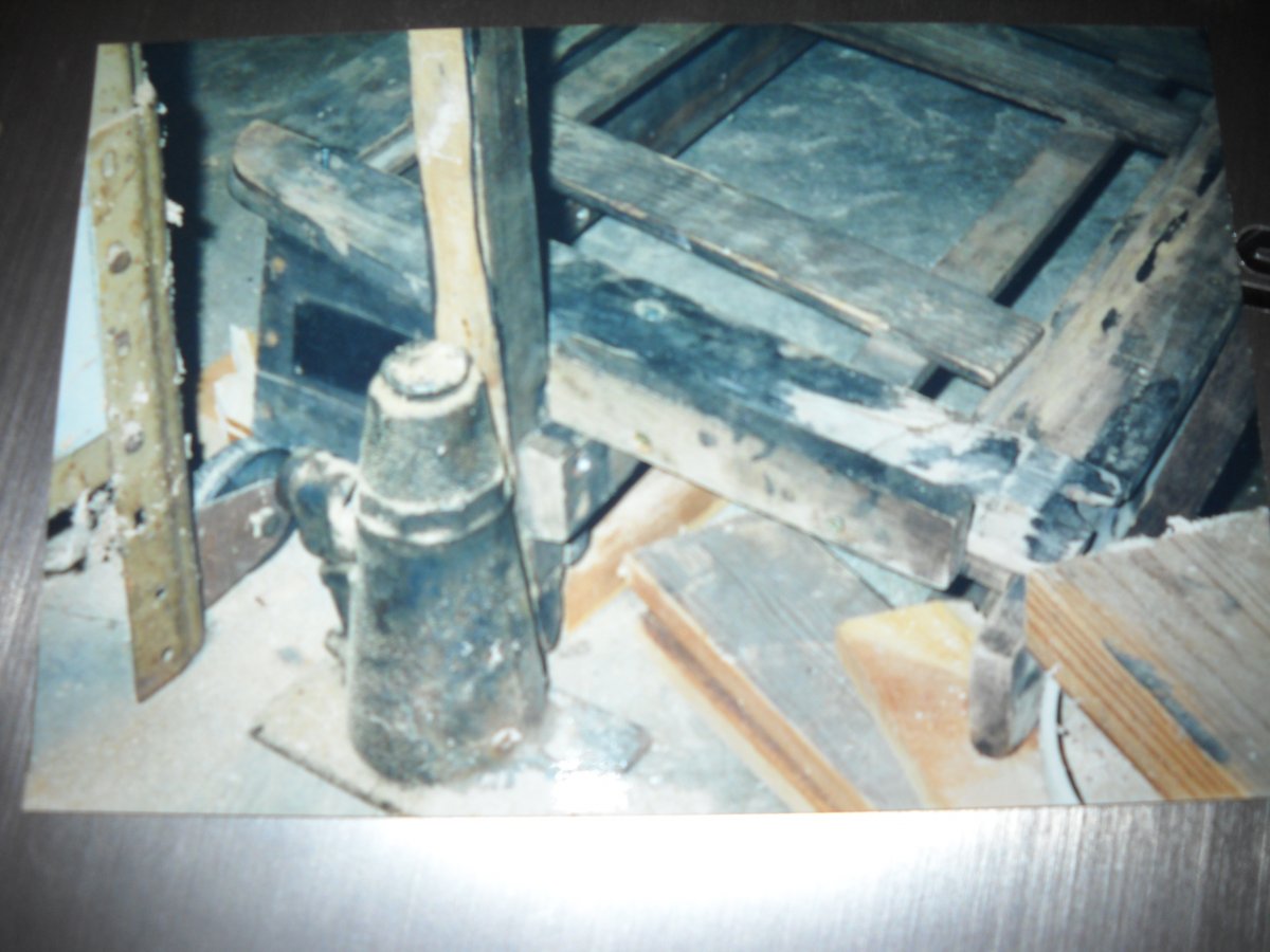

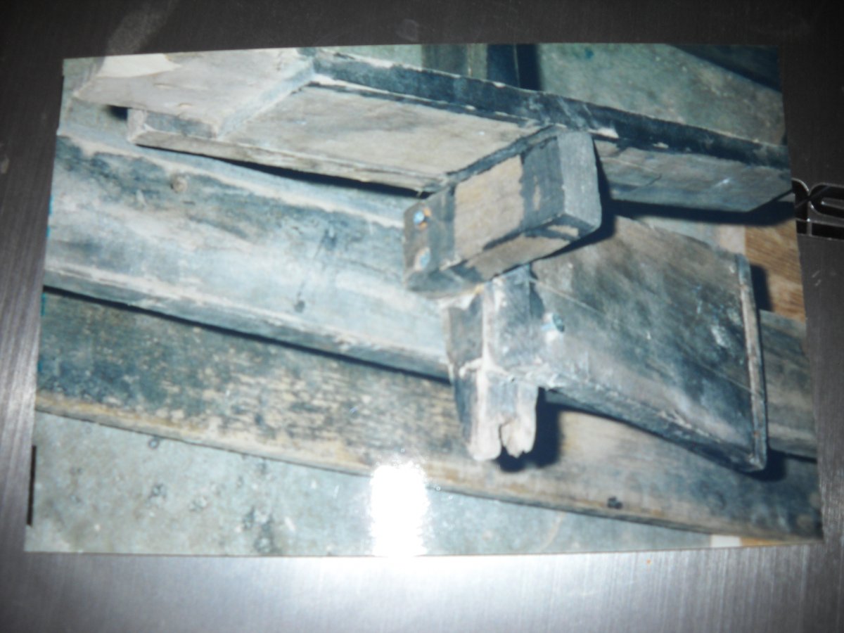

    page three 25 wood
  11. grumpy gaby 2
    Posts: 462
    grumpy gaby 2

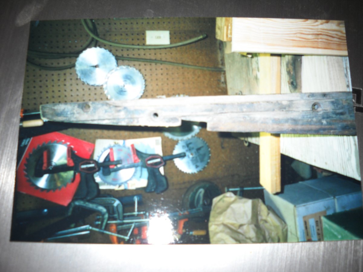

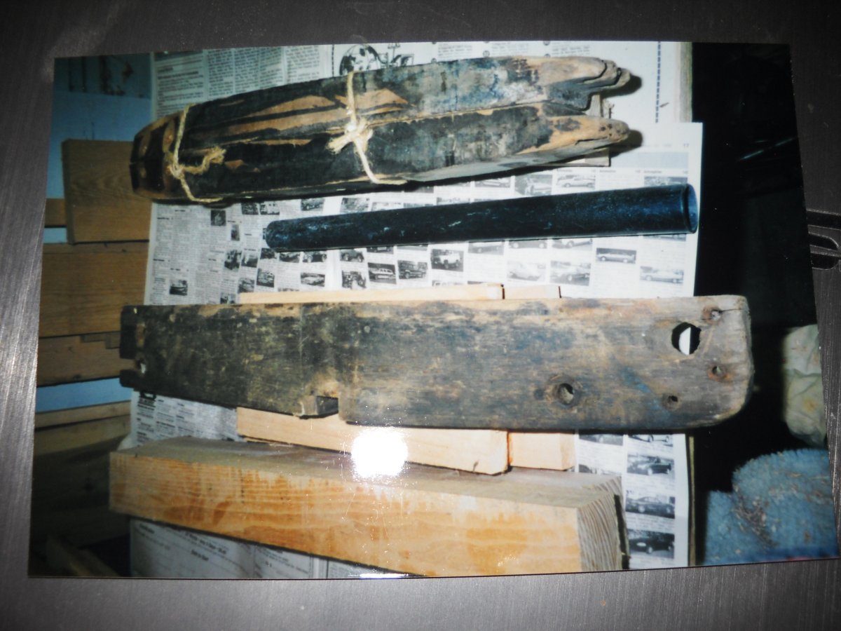

    page 4 25 wood
  12. grumpy gaby 2
    Posts: 462
    grumpy gaby 2

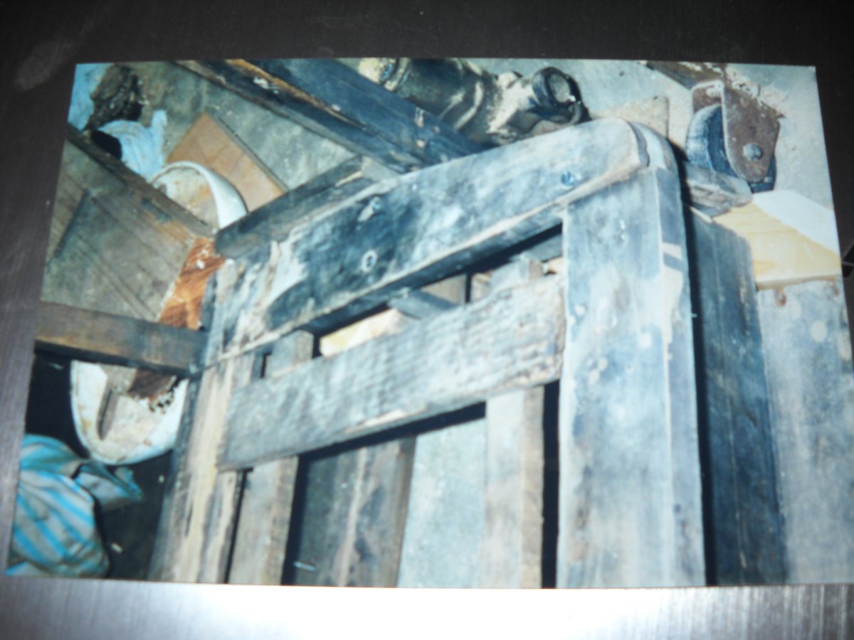

    page 5 25 wood

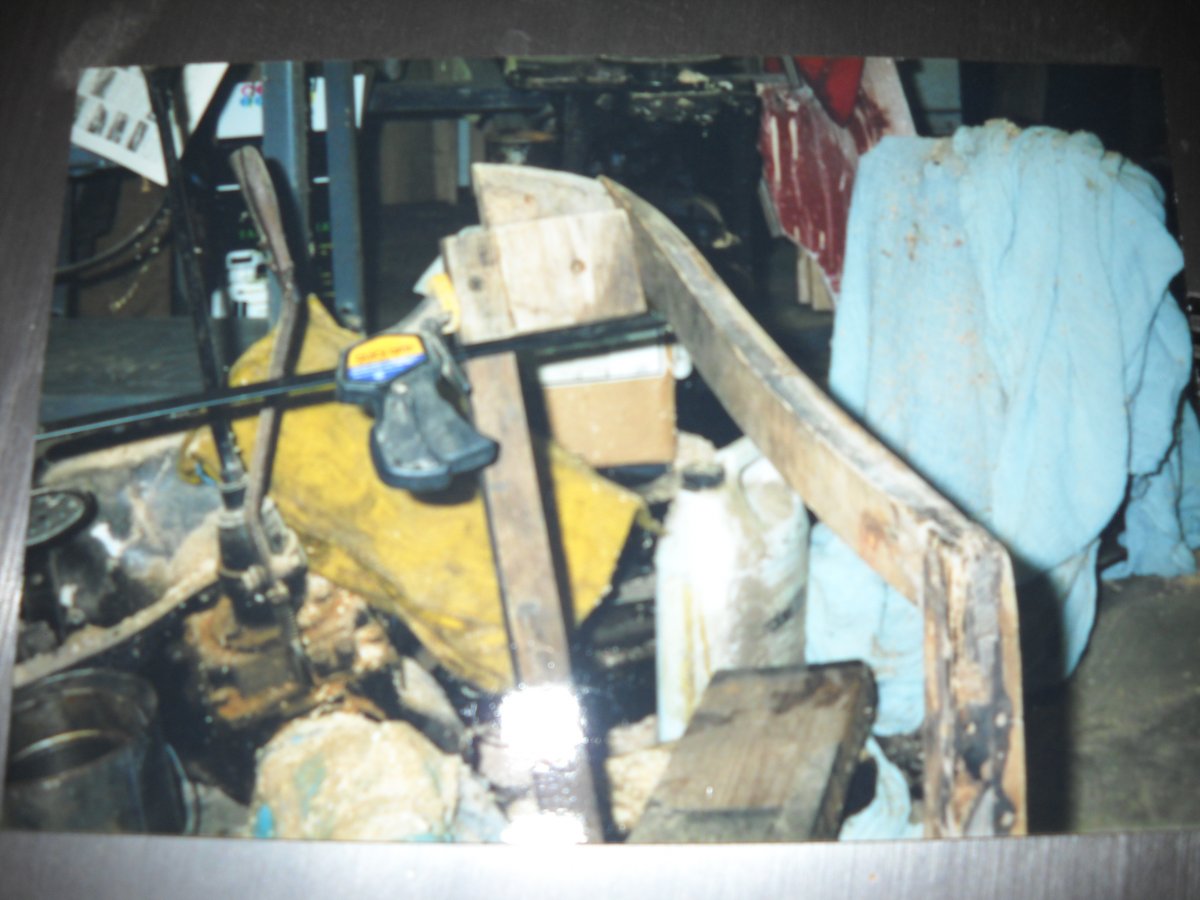

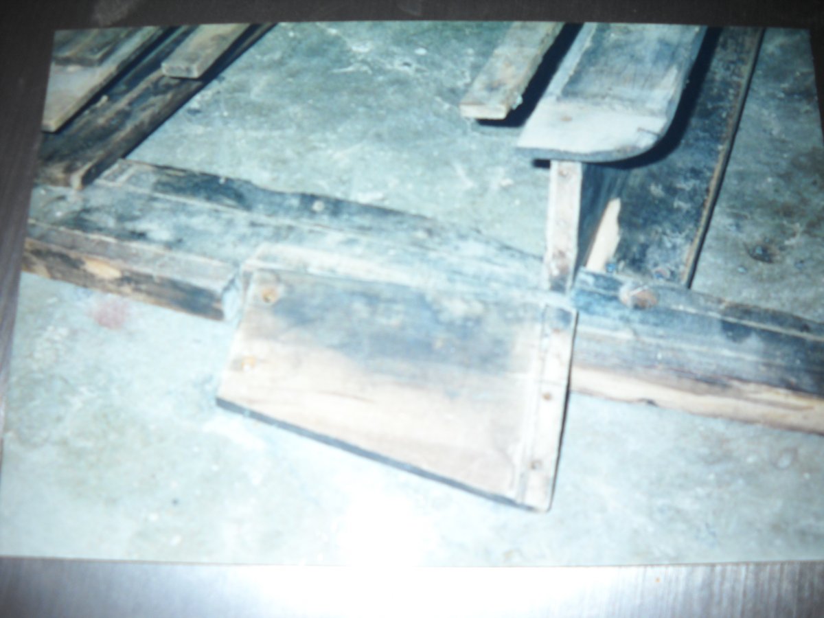

    page 6 25 wood

    page 7 25 wood

    Man that is a lot of wood pictures. Some of it looks familiar but some doesn't. I am missing a lot in the floor and seat area. The seat back and front of the trunk seems to be gone from mine. I'll have to study these some more. I got the parts I ordered and am happy that the metal sills under the doors are the right ones. I'll have an extra of those. These were the last two the seller had. I haven't been able to work on the car or tools for a few days.

    I am kinda a one eyed jack right now, just put every pic up. I will have to go back and maybe delete some and blow a few up and lable the parts. I looked at them this morning, kinda overwhelming! It's really not that bad. I found a piece that I had forgotten about. The tack strip along the seat bottom to hold the quarter panel upholstery!

    I think an archive of pictures here may help us and hopefully someone else. Even if someone chooses to replace the wood it might help to know what was there and which areas had support. There are a few more of these showing up at TROG and other events. Some are even being treated like Chevys.
