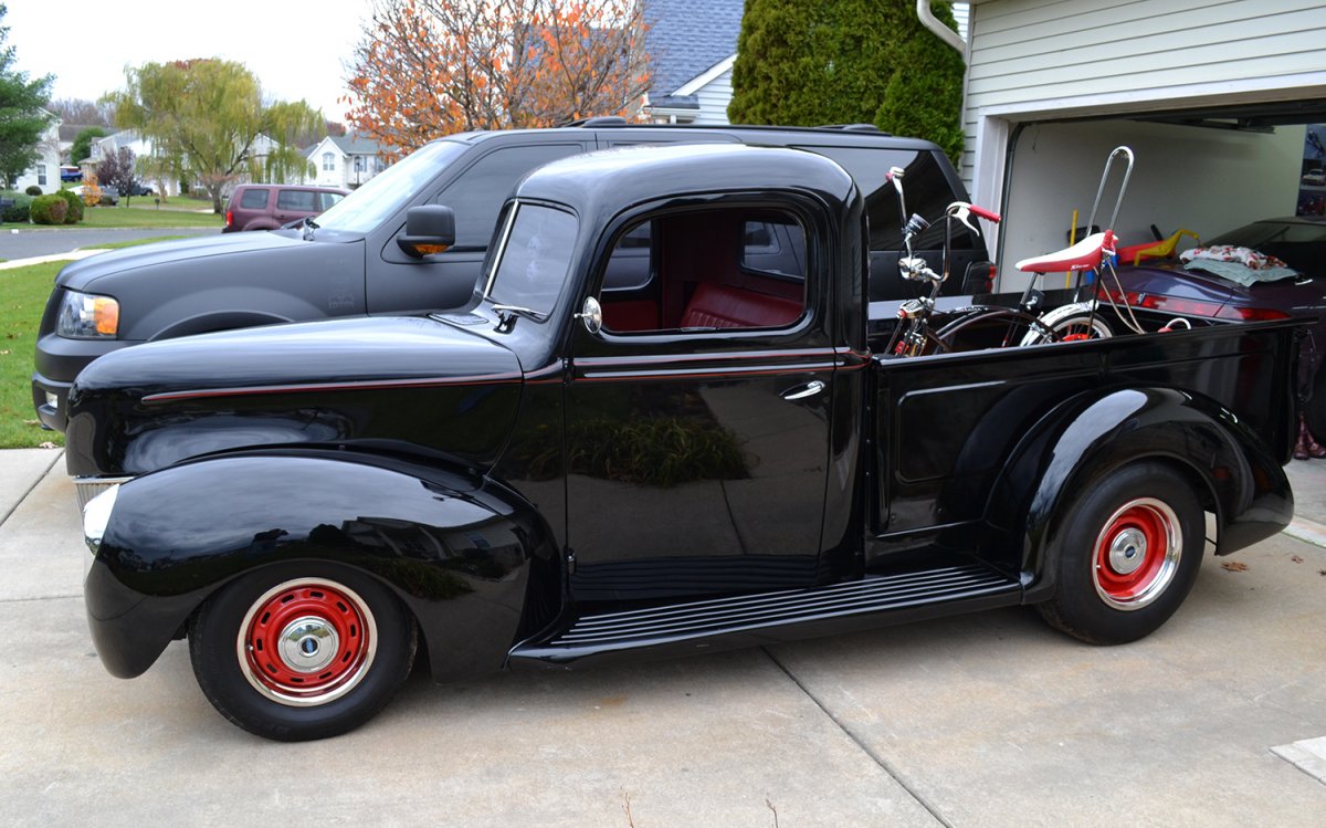

    Just picked up a SWEET 40 Ford F1 and the grill is currently being rebrazed and now I will need to chrome it. Any GOOD TRUSTWORTHY chrome Guys in the South Jersey Region? Thanks Guys in advance. DSC_0304.jpg

    If you have an original Standard '40 Ford grille, it is pot metal. Pot metal is very expensive to chrome as the pits require more difficult processes to repair than a regular steel part. Not sure how you are brazing pot metal, so maybe your grille is a '39 Deluxe, or maybe an Argentine repro from the '70's.
    Bob Drake sells a correct repro grille that is already chromed and it might even be less costly than having your original pot metal chromed. Most Bob Drake parts are a good fit.

    Oh here is the grill
  20. alchemy
    Joined: Sep 27, 2002
    Posts: 20,527
    alchemy
    Yep that's an old Argentina 39 style repro. Look at Bob Drake for a new one like I said.

    Nice car, it deserves a good chrome grill. Those South American ones don't even re-chrome very well. Get the Drake one!
