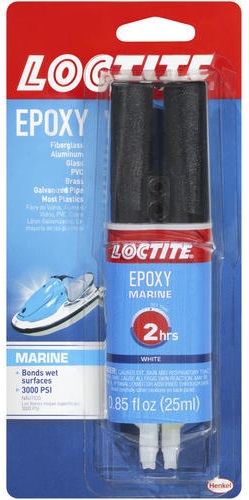

    Grind it real good in v shape screw it to some small peices of wood to hold the shape and position you want and use polyester resin and Matt and glass over screws and everything. When it cures dremels out screw head and release it will hold perfect shape. Then grind back side and add a layer to that and let cure. It will be a sturdy repair then grind down and do body work with mar glass and body filler. Glue and epoxy will fail fiberglass is so easy to do. Mix resin. Brush lay and roll.

    Actually, we glued it with one of those two-part repair kits (I forget which brand) up in the crack, then after that cured we ground the backside to a V and laid in resin and matt. We did absolutely nothing to the topside, exactly like we indented to do. Since most all events were shut down last summer the car has only travelled about 120 miles, but I'd say that's ten more miles than some of you guys said it would last. ;)

    I'm not sure if this stuff is still available but when I was working at a GM dealership about 40 years ago, they had a body shop. They would do Corvette repairs with this black tar like stuff that had two components in quart cans with a genuine GM part number. I would borrow it from the parts department and patch things. It worked great.
