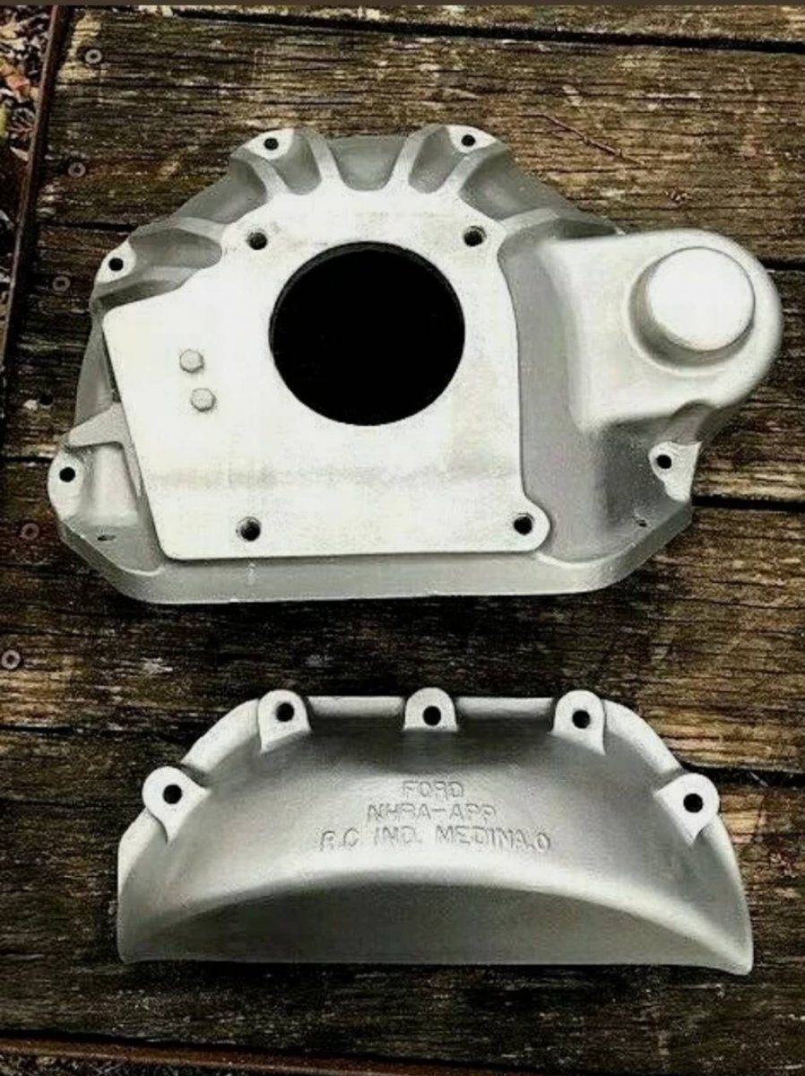

    Thanks for that, this is the Bendix style RC Ind bellhousing that going to be installed. I've asked Hayes (Holley) for clarification and waiting to hear back. A quick search of FE forums indicates a 460 may work however I'm not commiting to anything yet until confirmed. Screenshot_20190611-112454_eBay.jpeg

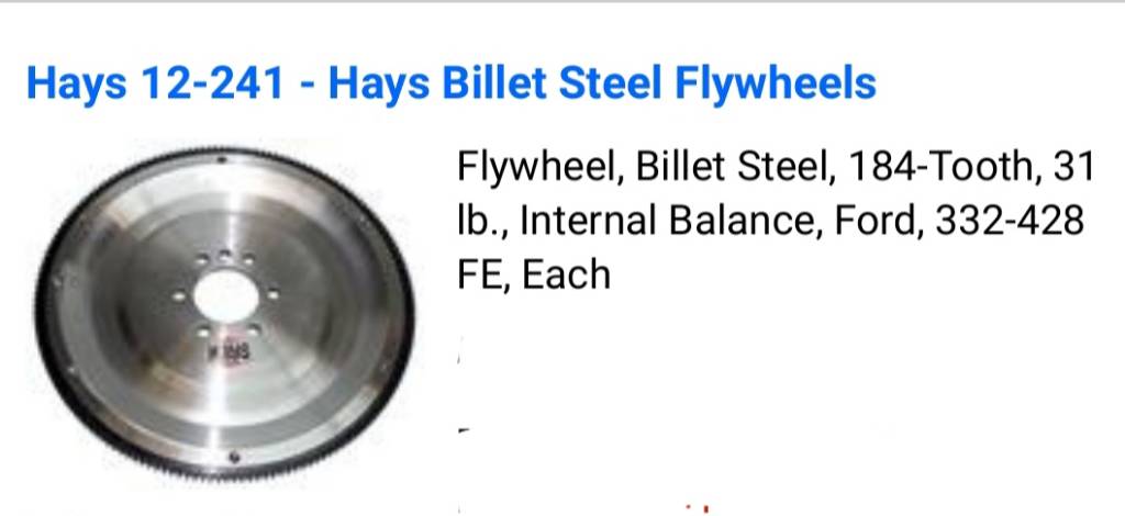

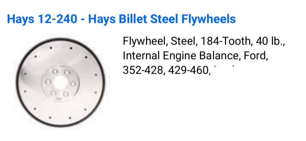

    It looks like the difference might be the weight, 12-240 is 40lbs 12-241 is 31lbs.
    Any suggestions as to what would be best weight for my driver. 20190629_185351.jpeg 20190629_185317.jpeg

  10. The main problem with that early style bell is that it's going to limit your transmission choices and may not be compatible with what's in the car. That trans bolt pattern cuts off at '64, the '65-up versions won't bolt up. I'm not a fan of the early Bendix starters either; I've had more than a few starter drive failures, which is why Ford replaced them.
    Flywheel weight is a trade-off. More weight will store more energy, making taking off easier and smoother perceived operation, but will markedly slow throttle response. Put into a racing perspective, a road racer will like the lighter wheel for faster throttle response, the drag racer will like the heavier wheel for the stored energy at launch.

    I've the earlier and narrow T10, hence the early and narrow RC Ind bell. My later 66 390FE had the later style starter. As the car is 64 I want to use the correct era parts so I posted photos of car in my albums. Car currently has earlier narrow pattern OEM Ford cast iron bellhousing which I'll keep when removed along with flywheel, clutch disc, throwout bearing and pressure plate.

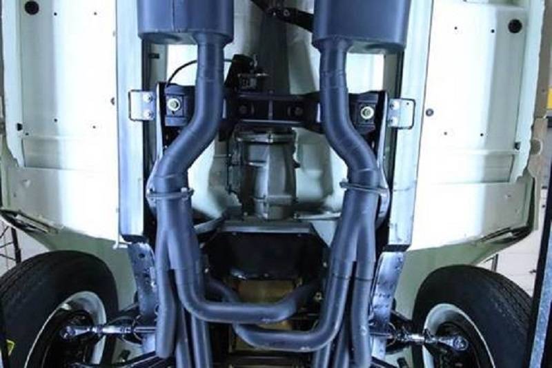

    All sorted, new 4.56:1 gears. I had the flywheel / clutch assembly balanced and it works a treat. New block plate and longer dowel pins.;)

    Well. that 427 sure looks pretty....... and I agree.. the early bell looks correct.
