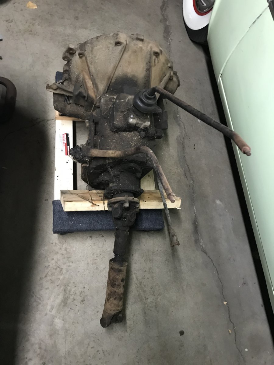

  18. Yep, this is slightly derailing this thread but what the hell, it’s been solved anyways

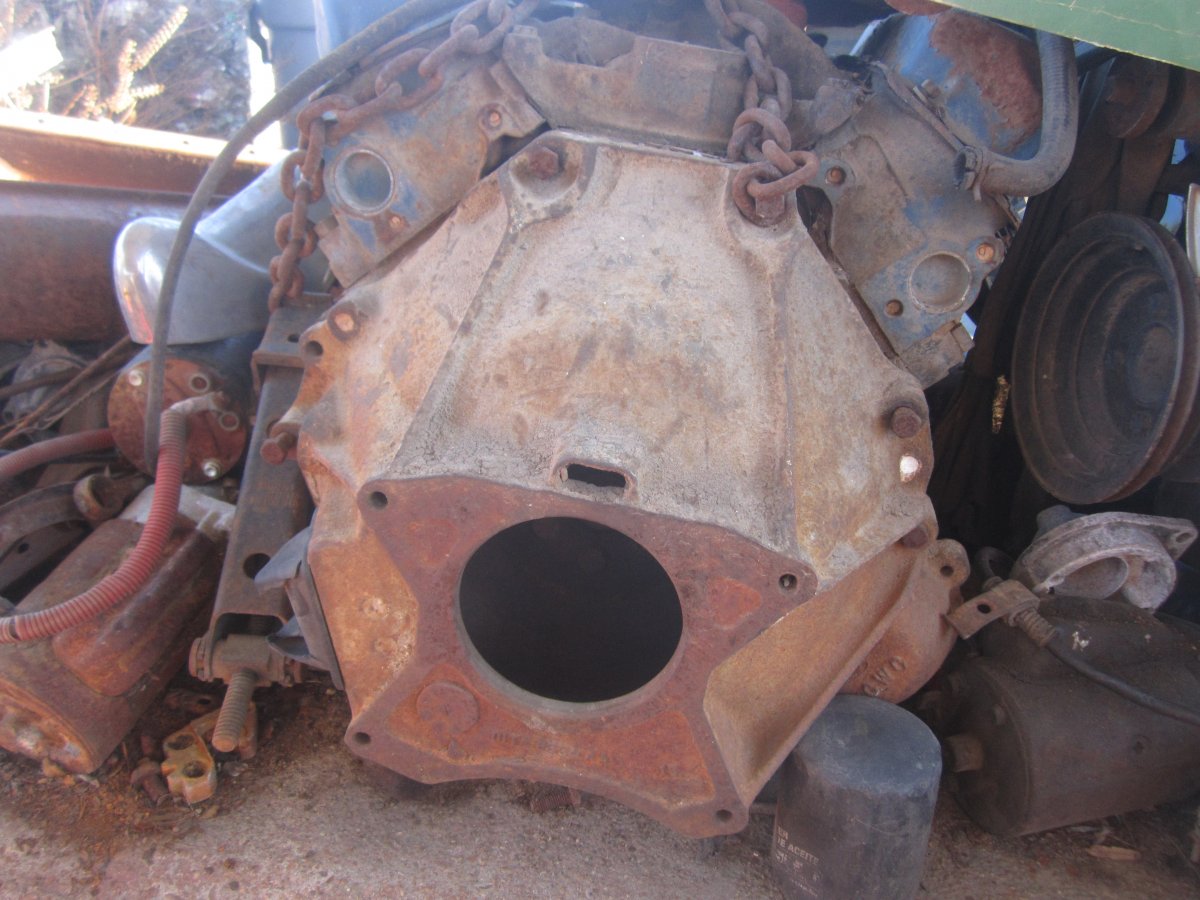

    1965 was the first year Ford used FE’s in pickups. 1965-66 F250 4x4 and F350 used the same three point mounting system that the earlier trucks did. So, I found a local 65 F-250 4x4 fairly cheap that had a factory FE in it (well, In the bed), bought it, jerked the trans and bellhousing out and sold the truck again the same day. This bellhousing will bolt into the 60, and update the trans to the NP435. All of the transfer case linkage will also line up with the stuff in the 60 as well. Kind of a neat deal.
    Beings the 428 also came out of a 65 F350, it has the front mount and timing cover, all I need to do is a little fab work to make it fit the older truck crossmember and bam- an FE bolted into a 57-60 using all ford parts. That bellhousing even has the ears for the slave cylinder, as 57-60 Ford pickups used a hydraulic clutch.

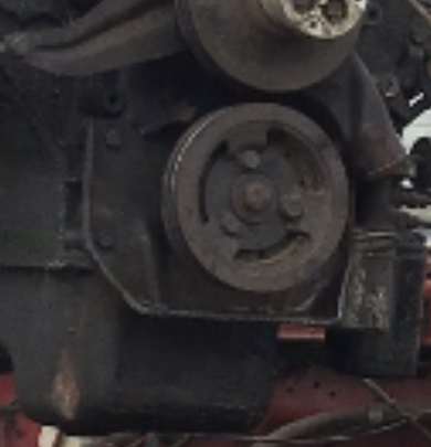

  20. You can see this simple mount here. Needs the timing cover to make it work, however
    kidcampbell71 and Boneyard51 like this.
  21. The truck bell that's used on the 330 -361 & 391 engines must use the larger 14 inch flywheel. because the starter will not reach the smaller diameter pickup flywheel. Ive never seen a small diameter regular FE bell that a F 600 truck trans would bolt to. Not saying they do not exist. just ive never seen one. Ived got a 300 six propane power unit. It uses the same FE bell as a F600. however it has a steel adapter plate and a large diameter flywheel. I took all that stuff off and bolted it to a 250 ford six. was gonna install it in my 66 F 600. When I had the 430 Mel in my 56 ford truck I used a 330 truck bell and flywheel and a 56 granny 4 speed. Now they made bells that bolted a F 600 trans to Y blocks and 262 six engines.

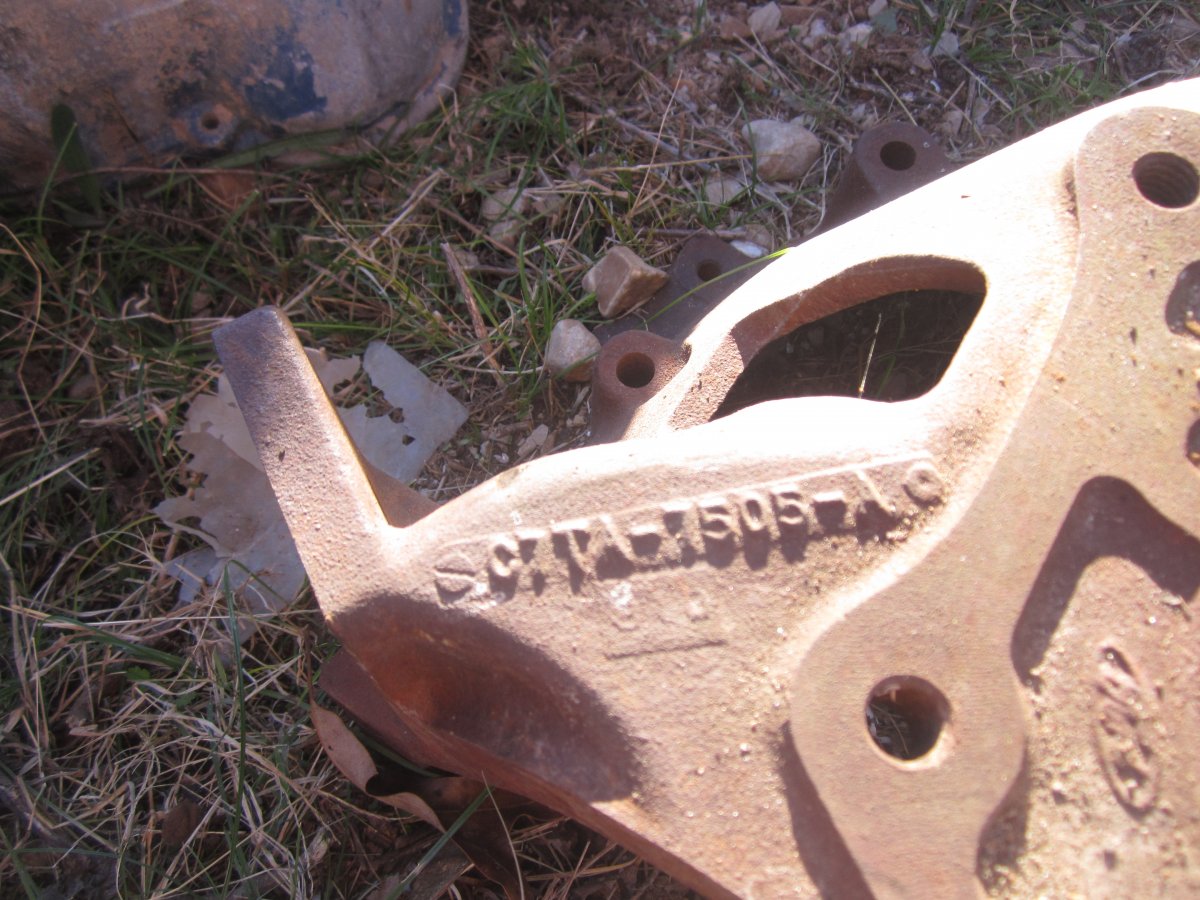

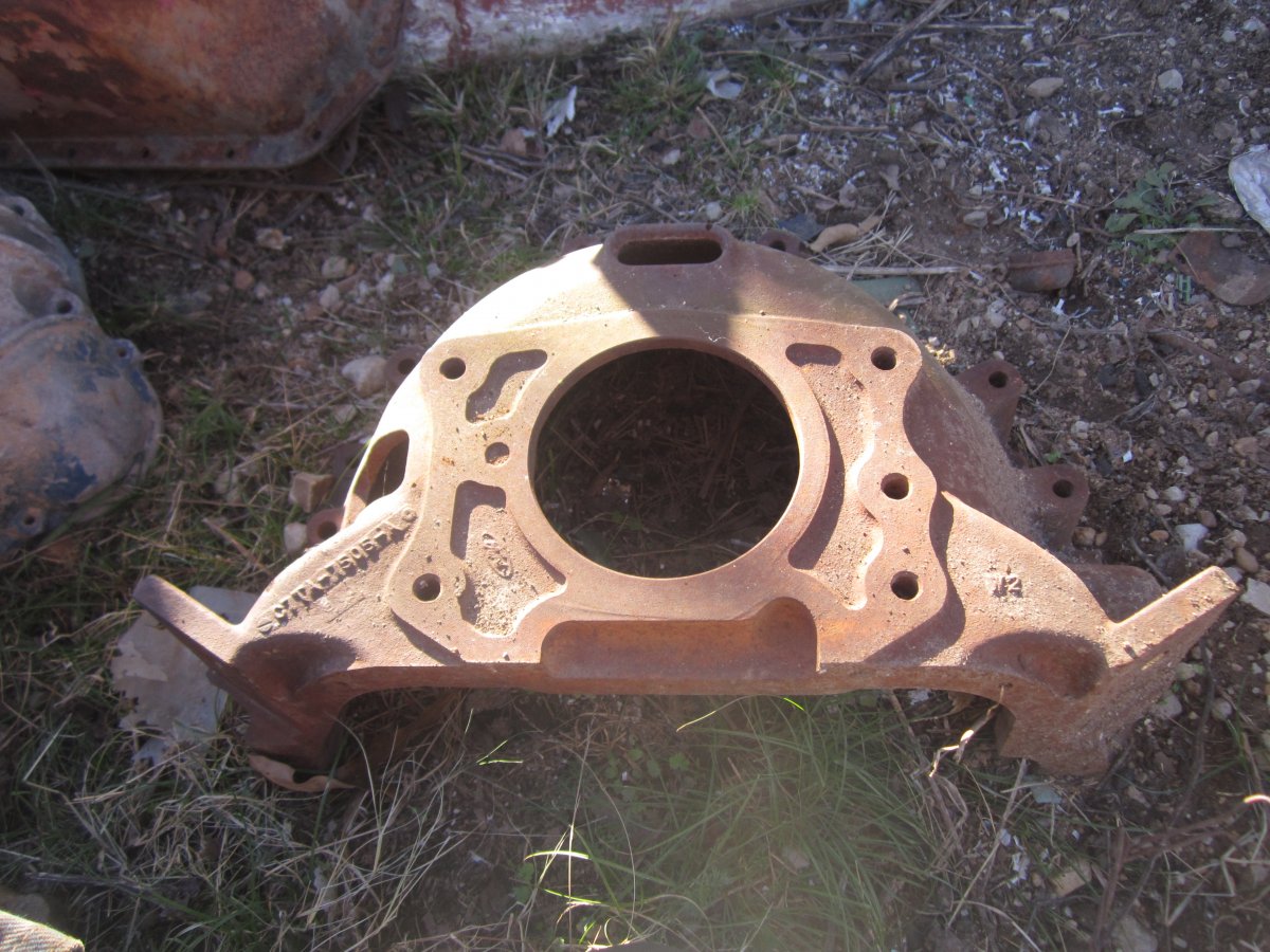

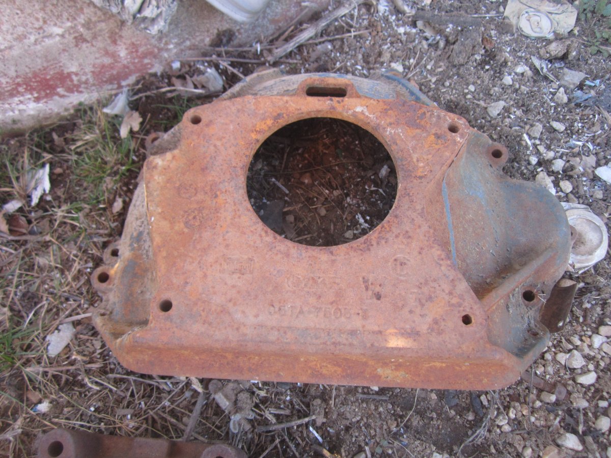

  22. Ok I got pictures. The overdrive 5 speed I have you need to use the F 600 bell that has the trans pattern and rear mounts like the first two pictures. That bell requires a large diameter flywheel and a 14 inch clutch. It also requires a large diameter clutch spline disk. the next picture is a FE pickup bell. and the last is a pickup bell on a 302. You might make a engine plate adapter to adapt a Y big truck block bell to a fe and use the smaller Y block flywheel? you need the rear engine mounts on the bell because there FE# bell etc 002.JPG FE# bell etc 003.JPG FE# bell etc 005.JPG FE# bell etc 004.JPG FE# bell etc 001.JPG isn't any on the overdrive F700 trans.
  23. That first bell you posted is crazy because it looks just like a BW T98 bolt pattern, in fact the whole thing looks just like a Y block or 223 4 speed bellhousing...but the C7 part number tells a different story. Thanks for the pics Old Wolf
  24. Ok Im set them on the tailgate to compare. the F600 bell is about 3/4 inch beeper that a pickup bell. f 600 bell 001.JPG possibly machine a adapter plate from steel and weld rear mounts to it?
    Chris likes this.
  25. Yes I have Y block and 223-262 truck bells that have the same trans mounting pattern as the Bell I pictured. Up until 65 ford used a three point mounting. on the pickups. One in front and two on the bell. In 65 ford went to a reverse 3 point. two side engine mounts and one on the trans tail. However the 1965 F 500 and larger trucks retained the early three point used in all 64 and older trucks. You might find a old adapter to adapt a Fe to the early round half bell flathead trans. and then use a 46 truck ford mini bell and make that work.
    Chris and Boneyard51 like this.

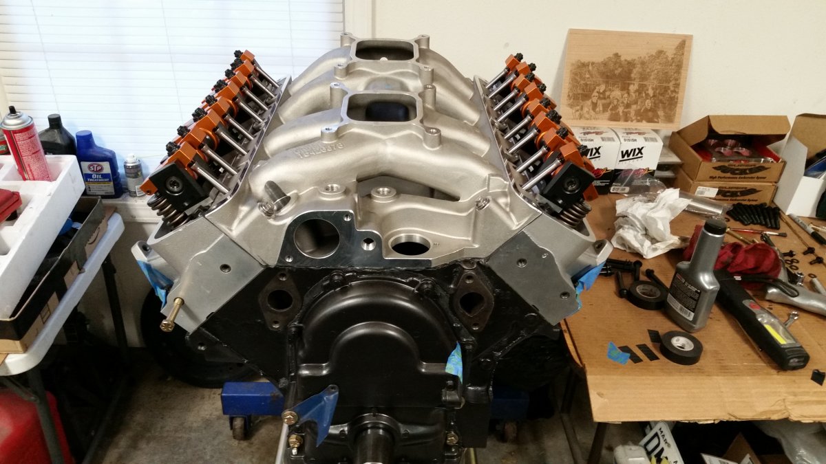

    Back to the regular schedule program.
    Maybe something like this? :D
    kidcampbell71, j-jock and Boneyard51 like this.
