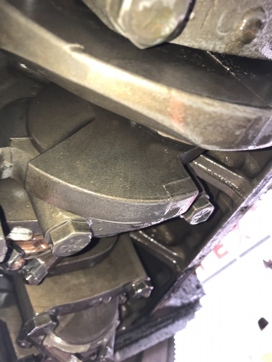

  16. That’s oil dripping off of them...
    on the main cap/bolts, that's the edge of the pan gasket you are seeing

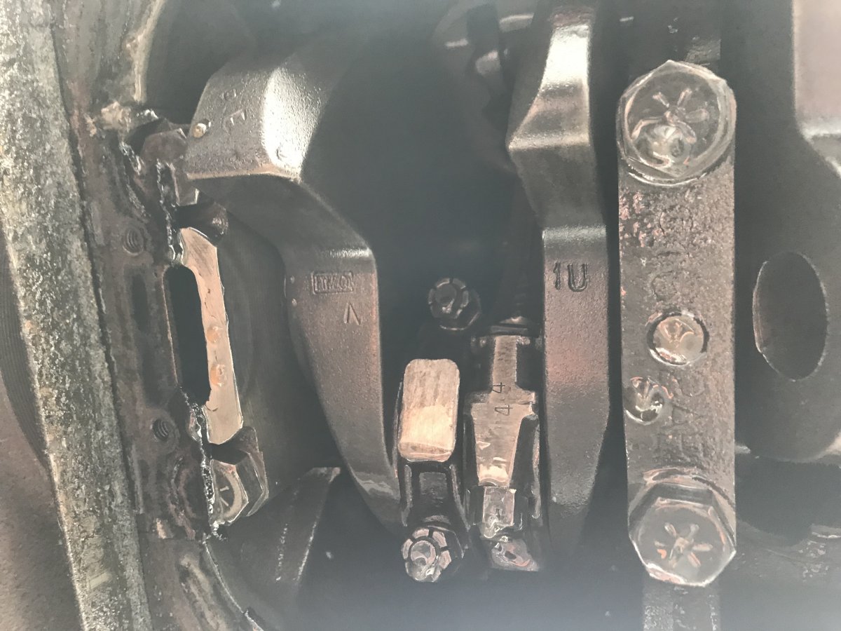

  17. The “1U” and little hatchet counterweight are the tell tale signs of a 428 (or 410)

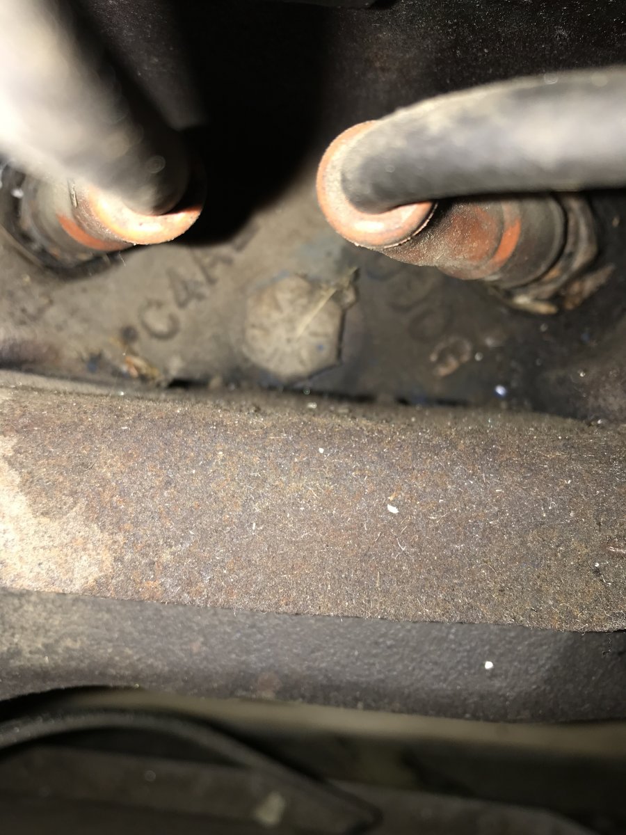

  29. Well I’m a big dummy. The exhaust manifolds are D2’s, the heads are C4AE-G’s which after researching for a minute look like a decent head. So after al that I’ll probably just stick with them
