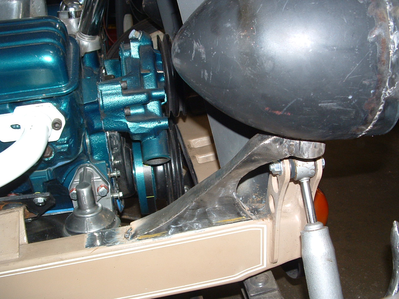

    I cut the center out of a 28-29 model A headlight bar, faced it forward and heated and bent to fit my application.
      176.2 KB
