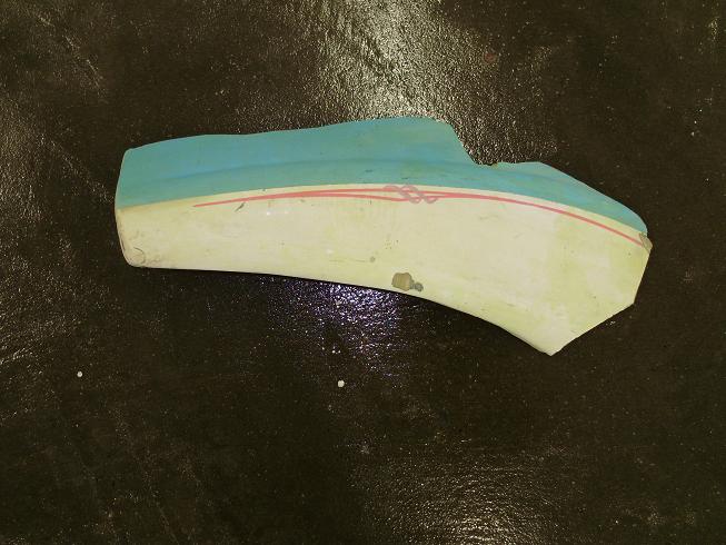

    Pulled off BY HAND:
    And this one...
    Seems like instead of banging the dent out
    They just puttied over it.
