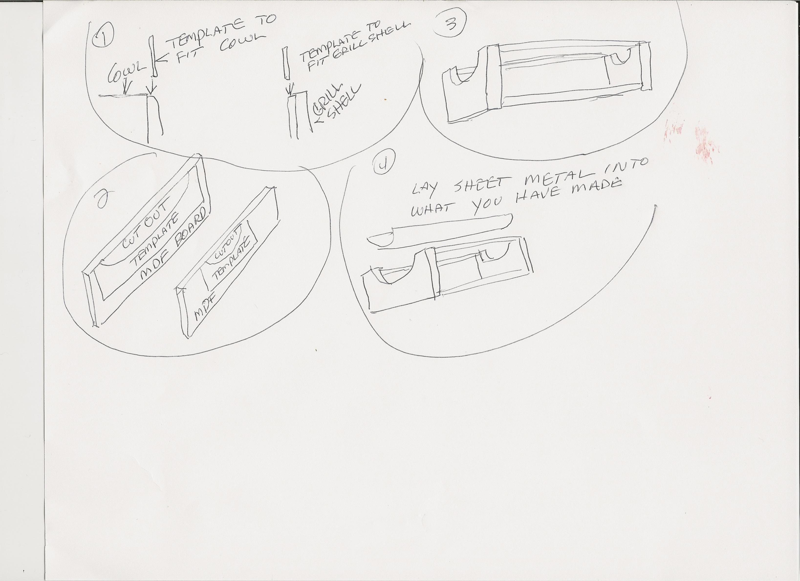

  12. zzford
    Joined: May 5, 2005
    Posts: 1,823
    zzford
    I've done this before. Make a template of the firewall and radiator ends. Make a female copy of those templates. Add a couple of stringers to connect the forms you just made. Of course the ends must be spaced to the length of your new hood. Make sure to put a couple of stringers along the hoods side edges so they will be straight. Lay in sheet metal, I used like 20 gauge. Then lay up your f'glass in the mold. Let it cure, disassemble the mold then trim the new hood's edges. Works great!
  13. zzford
    Joined: May 5, 2005
    Posts: 1,823
    zzford
    Like this...
