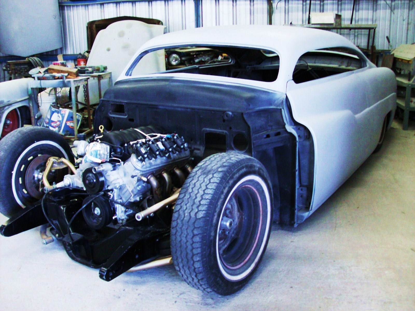

  1. Sneak peak of my next 51 Merc. I have decided to call it the Warrior as we will be showing it and I plan to drive it almost every day. We built one of our high tech style frames with air suspension and a narrowed 9" rear end with large dia disc brakes on all 4 corners. Installed a new crate 480hp LS3 copuled to an mildly built 4L8OE. Made a set of custom headers and with a little tunning it should make over 500hp. I cut the roof streamline style. Took 5" out of the A pillar and slightly leaned it back then took 8" out of the rear. Replaced the 51 merc back window with a ford shoe box back window. I also raised the side window openings 1", buy doing this it gives you more side vison and gives the chop a decrowned look. I also extended the rear quarter window to make a longer / sleeker looking side window pofile.

    Nice lines, they flow like a river.

    i like the profile from the side...should look good when its finished

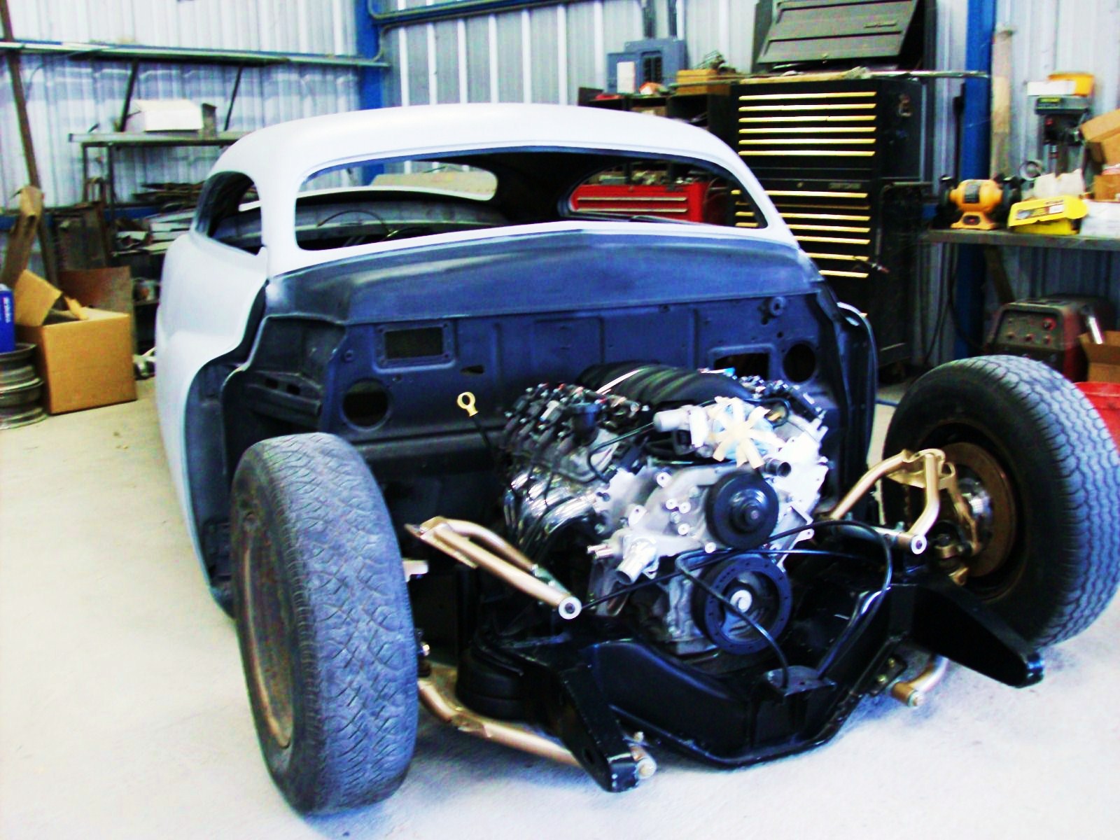

  4. Very nice. Any pics of that rear window. That LS3 can make 480rwhp with a cam swap and headers. :)

    Looks Amazing! I'd like to check out the rear window also, if you have anymore pics of it.

    Sure is purty, flows great. Awesome lines, nice work.
  7. Thank's for the comp :) Heres a few pic's of it from the rear. Hope you still like it as it is cut very low. The Ford back window works well with this style of chop IMO.
    The LS3 has a hotter cam and some head work already done. I do not plan to race it but I might run it at the track just to see what it will realy turn in the quarter.

    SOLID! I think i like it even more now.
