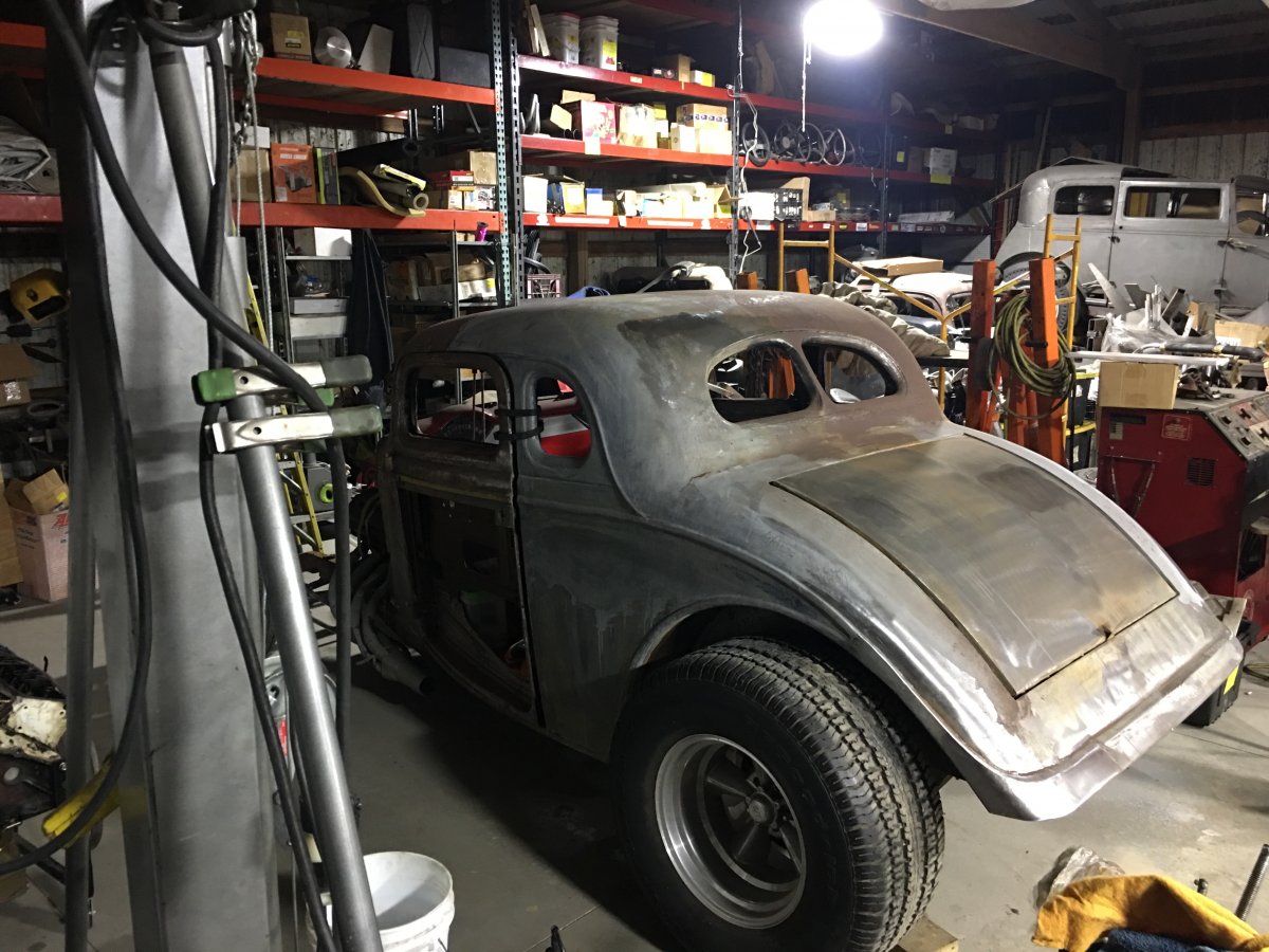

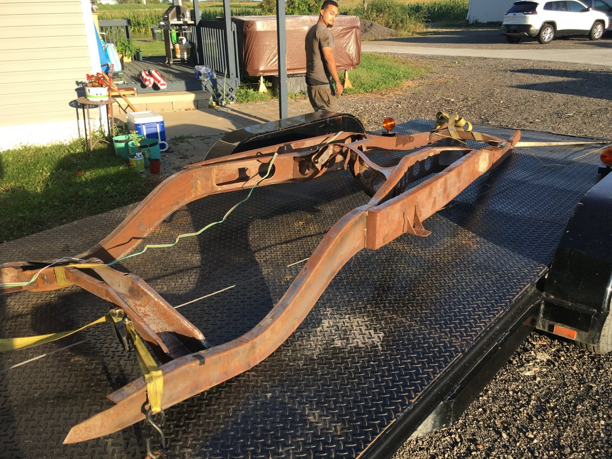

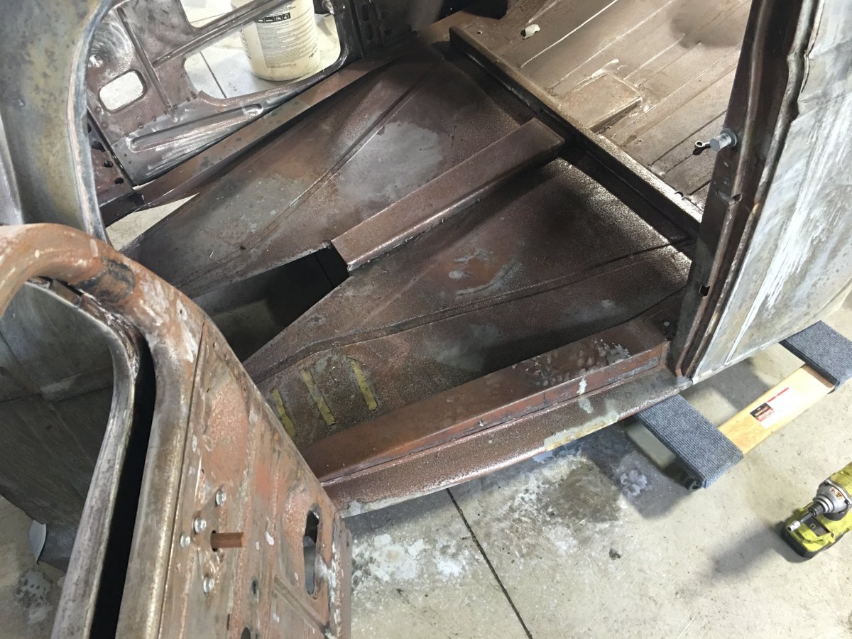

  28. Just for general knowledge
    What would these cost to get these items blasted
    It was all clean metal that turned,
    no paint, no undercoating.
    Body , inside, outside, underneath on s cart.
    Frame and rear axle.
