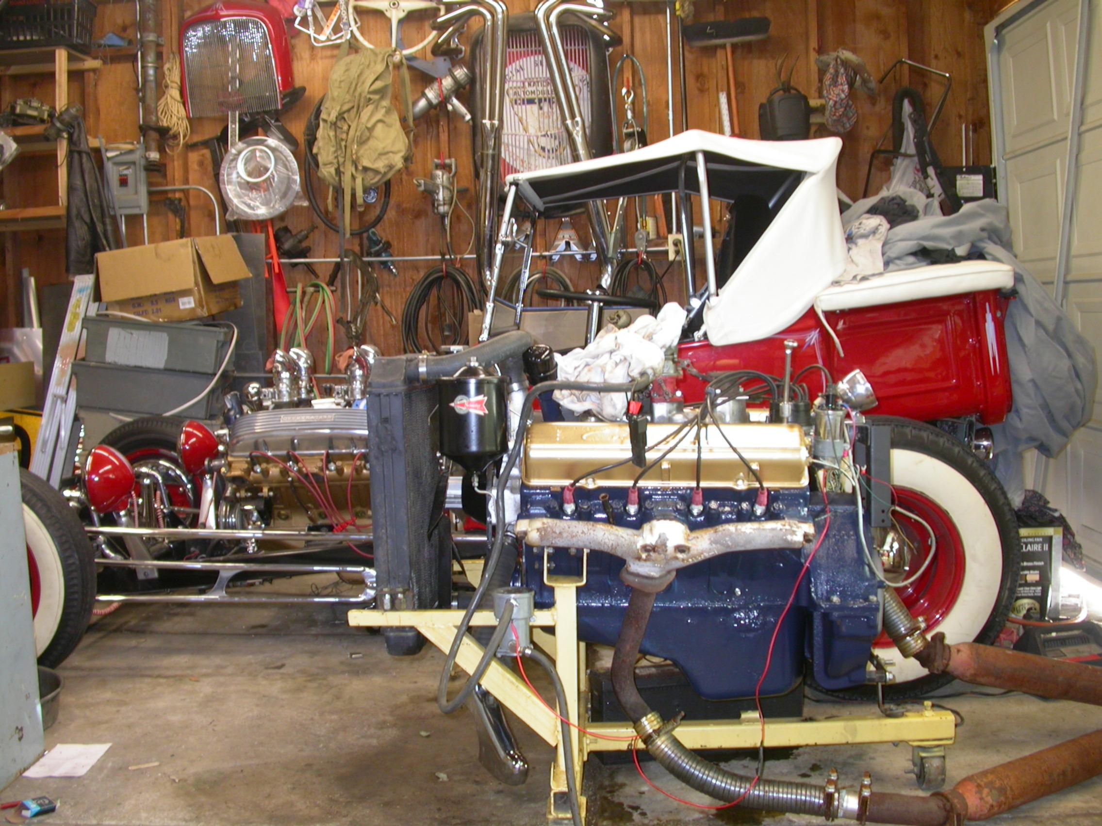

    Here's one I made several years ago, very handy. A friend
    has his big block on it now. Hope to put my Hemi on it!
    Rich

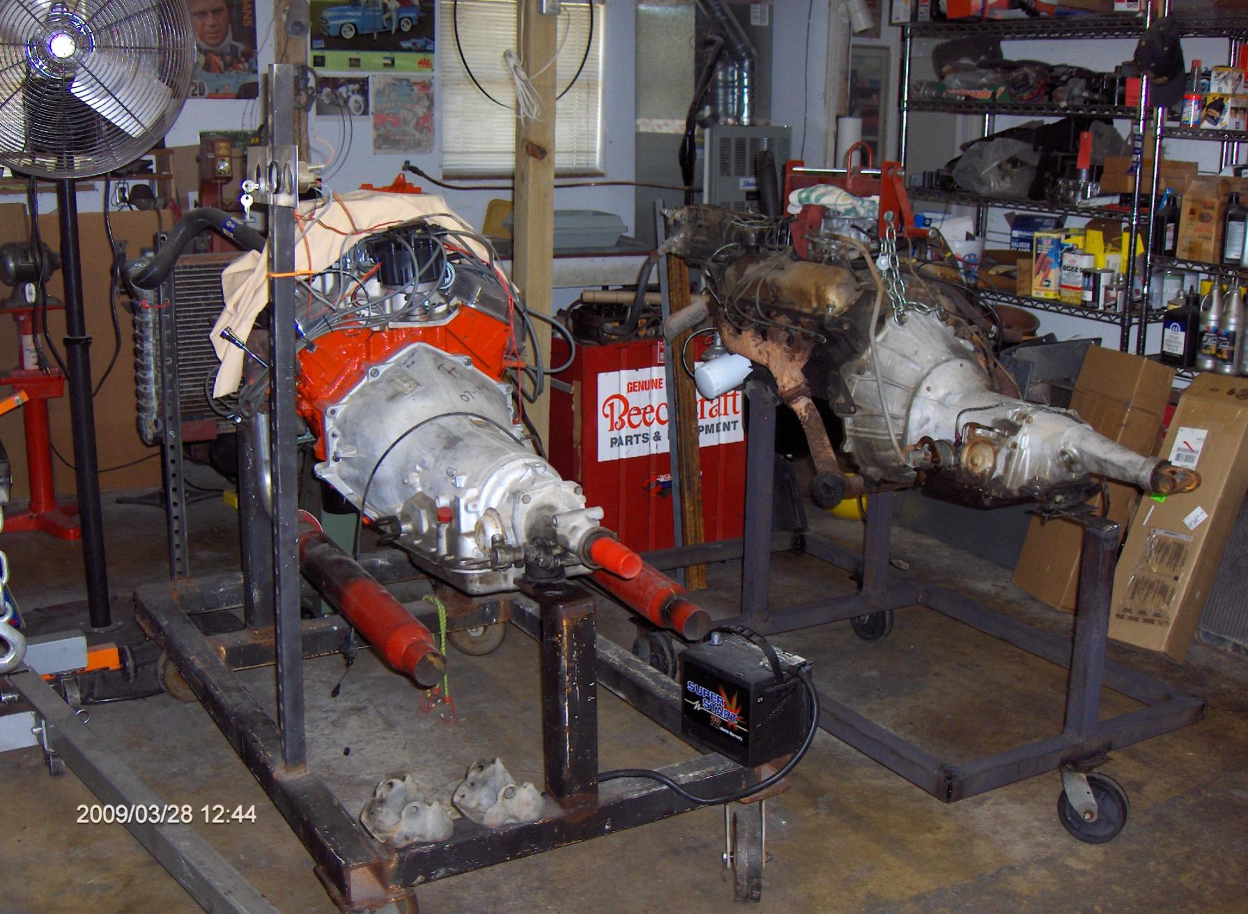

  7. I have built a couple of stands that allow the transmission hooked up and a radiator with gauges, gas tanks and mufflers , Ready for my next hot rod project install , kinda fun to start the engines about once a week or so,,, simple and easy build ,no plans,the one with the chevy 350 is a fresh build with a 700r4 finished , the one with the for 289 and c4 I bought off craigs list , runs great, did not have the radiator and gauges install yet when I took the photo, ,,
