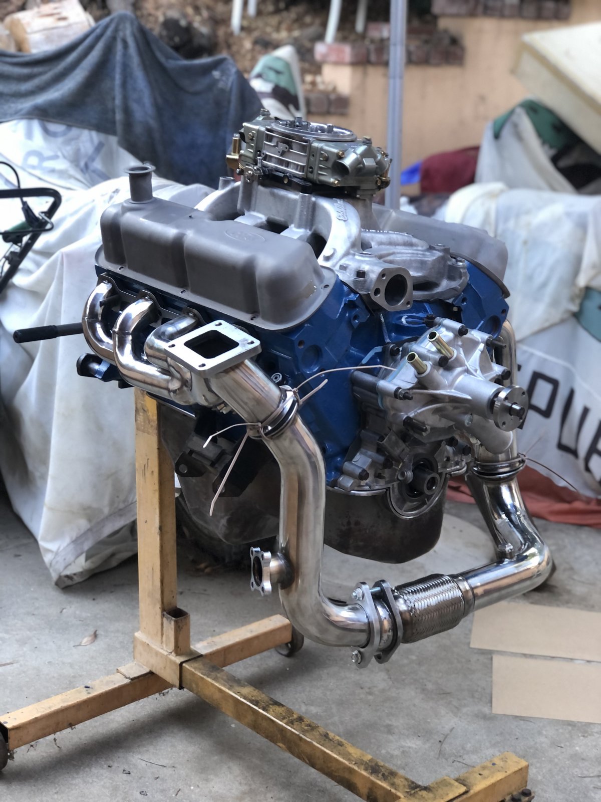

    I Had fun with the 223. I learned a lot while I was trying to make the most power out of it, and it made some good power after I made custom headers and ported the heads.

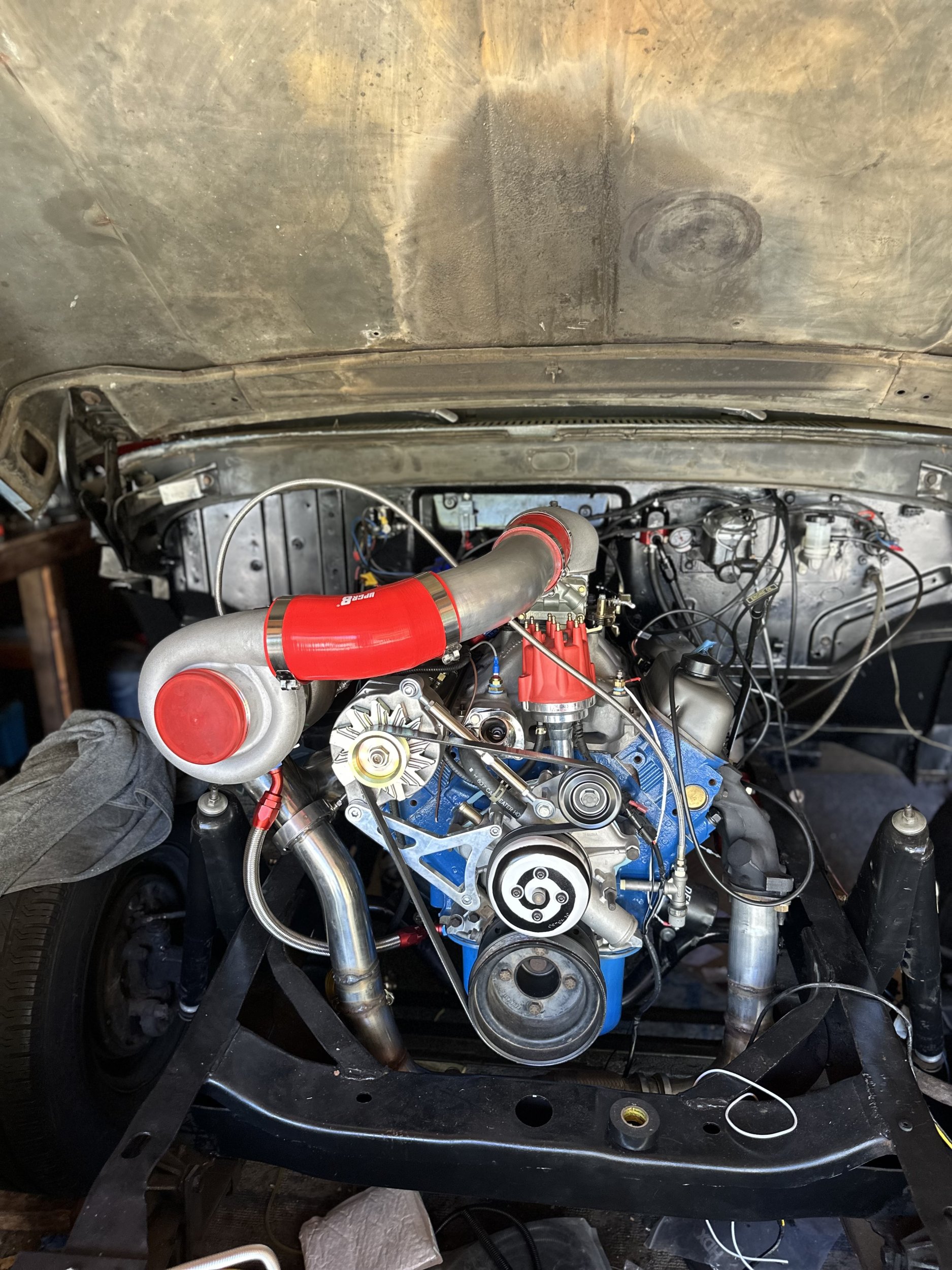

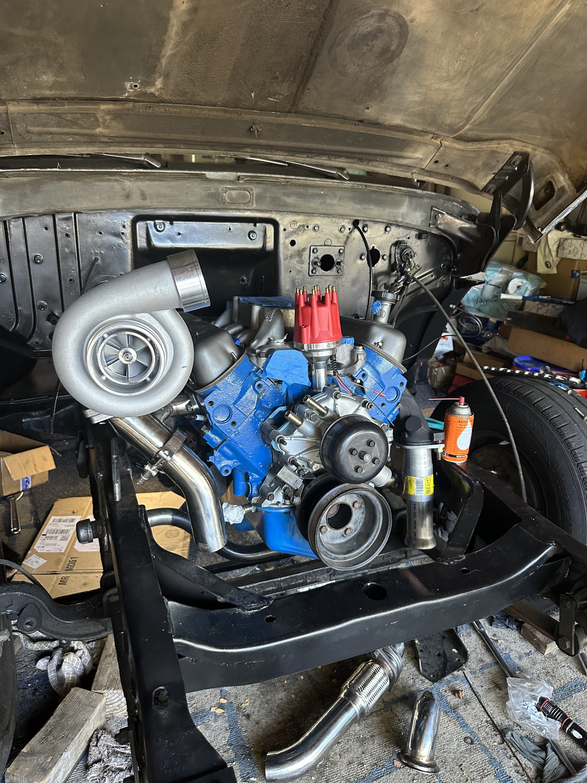

    Now with what I learned from your posts I am installing a turbocharged 351W engine I rebuilt. I’m keeping the truck 3 on the tree still with a top loader 3 speed, and I’m nearing the time of installation.

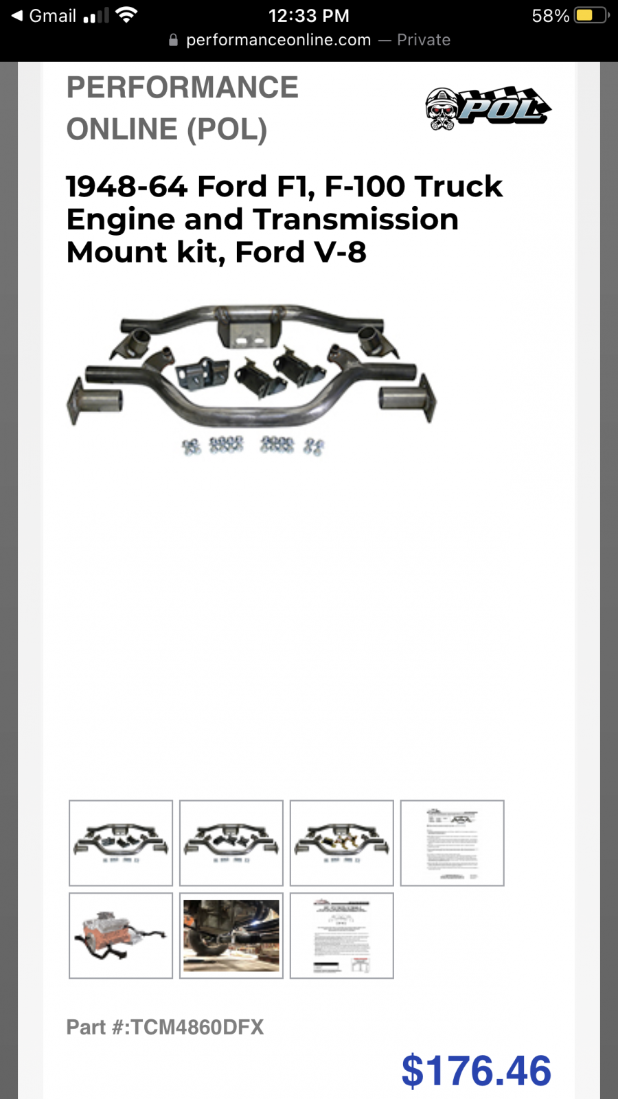

    I plan on using this Conversion kit from POL. It seems like it would be the best in terms of strength.
    Thank you for all the help, Reading back over the messages over the years has helped me get an idea with what I could do with my F100-being my first big project. I’ll post one last time when it’s all together.
