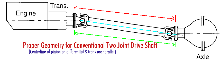

  3. Mr48chev
    Joined: Dec 28, 2007
    Posts: 33,986
    Mr48chev
    The diagrams in Tman's post (#23) pretty well say it all. You want the output shaft of the trans and the pinion shaft parallel with each other no matter how much they are offset from each other.
    The one that says NOT that says high strain bad vibration is what half the spit and whittle club will claim that you have to do to compensate for pinion rise (axle housing twist) when you have hard acceleration. That same bunch has been claiming that for at least 60 years that I know of and they are usually the ones puking U joints on the starting line at the drags or in a street race.

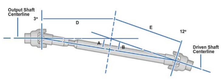

  20. Ebbsspeed
    Joined: Nov 11, 2005
    Posts: 6,257
    Ebbsspeed
    I'm sure happy I understand how all this stuff needs to be, and try not to get into these discussions because they always turn into a shit-show. I do need to point out that the "W configuration" is valid. The diagram below is from the Spicer web site. I think they know most of what there is to know about u-joints.

  26. gimpyshotrods
    Joined: May 20, 2009
    Posts: 23,333
    gimpyshotrods
    The imaginary line through the transmission output shaft, and the imaginary line through the pinion shaft should (with a few exceptions) be parallel when viewed from the side, and from above.
    The angles made between those two imaginary lines, and the imaginary line through the driveshaft, should have the same absolute-value (with a few exceptions), when viewed from the side, and should be set to the minimum (as close to a straight line) that best-construction-practices allow.
    Pinion offset is fine, however, for each joint degree, when viewed from above, induced by the offset, decreases the permissible angles, when viewed from the side.
    No up, no down. No convergent angles meeting at the center of the Earth. No perception problems.

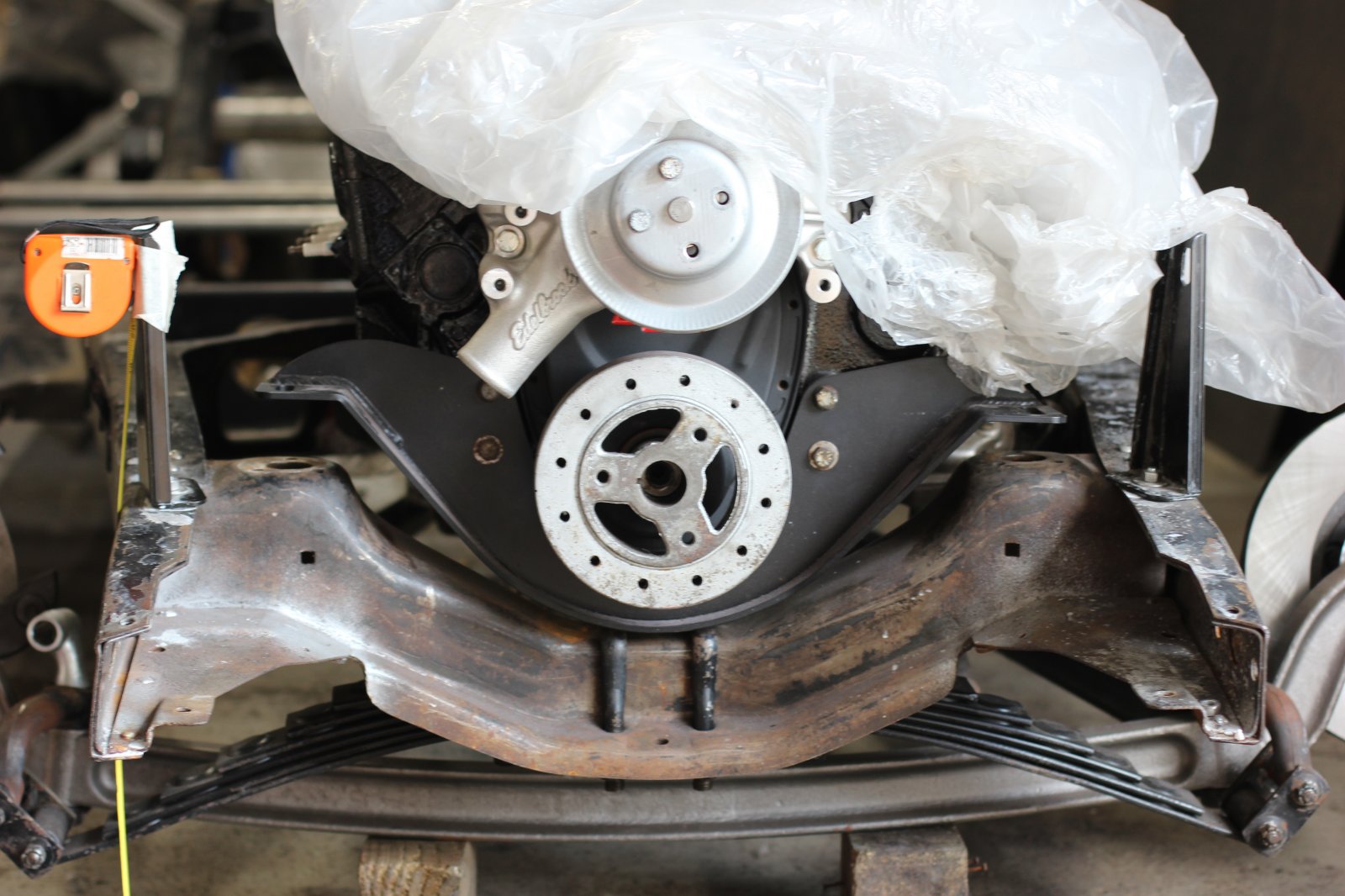

  28. Smart62
    Joined: Jul 18, 2012
    Posts: 54
    Smart62
    from UK Sussex
    Thanks Everyone! Amazing input and help.
    Here' some pics so you can see where I am at.
    All just mocked up so far at one possible ride height with running boards to view ride level.
    I wanted to keep the front end traditional as you can see. Hurst will have donut mounts when I have worked out all the angles etc. Back end will use ladder bars.
    Frame seen here slightly higher at the back. - Frame to ground at back end is 15 1/2 inches. Engine sits at 4.5 degrees from horizontal. Axle input shaft is about 13inches off the ground with diameter 28 inch tyres. (depends on compression of tyre.) Trans output shaft is 12 inches off the ground here. Front end is about as low as it will go I think. - Not sure how much gap there will be between front axle and frame when all the weight is on which may make it lower. This is my first project... as you can see not an acceptable set up so far, but moving forward bit by bit..
  29. Smart62
    Posts: 54
    Smart62
    from UK Sussex
    another pic from front. Hurst Mount sat resting on cross member. Could modify mount to get a bit lower.
    As the front height of the engine is limited by the cross member I guess everyone with an SBC and solid front axle and any type of engine mount will have similar problems to solve. Let me know anyone if you have successfully solved it on your 35-40 Ford. Cheers
