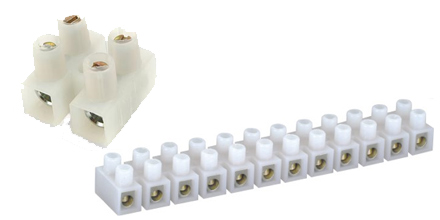

  20. Cosmo50
    Joined: Sep 8, 2011
    Posts: 226
    Cosmo50
    I like to use these blocks when I need to do multiple connections. They are very versatile.
    Sporty45 likes this.
