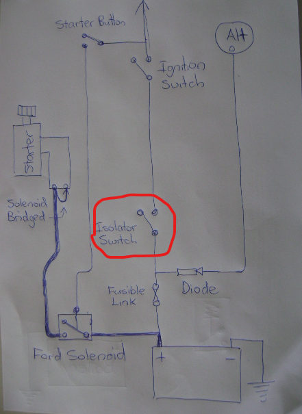

    This is a schematic of how I did the wiring on a Falcon Touring Car [this is up to FIA specs which exceed NHRA specs]
    I used a simple marine 20A toggle switch on the Front Fender [FIA Rules] as a Battery Isolator
    I have witnessed a car burn to the ground after being T-Boned and the main battery cable short circuited with gas everywhere.
    With my above method /schematic this shouldn't happen. Everything is dead by default
    This is a Vishay Diode
    If you don't want to go to this trouble ,just use a simple cheap 2 post battery isolator ,and connect the Alt Charge wire to the battery side of the switch [But I still recommend the diode]
    This stops the Alt charge looping back and feeding the ignition, AND it is not good for the Alt to be disconnected from the Battery while the engine is still running
