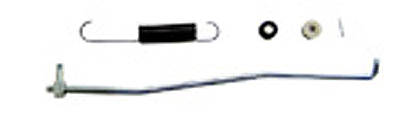

    four barrel uses a different rod that a two barrel. readily available or modify the o e you have to work.

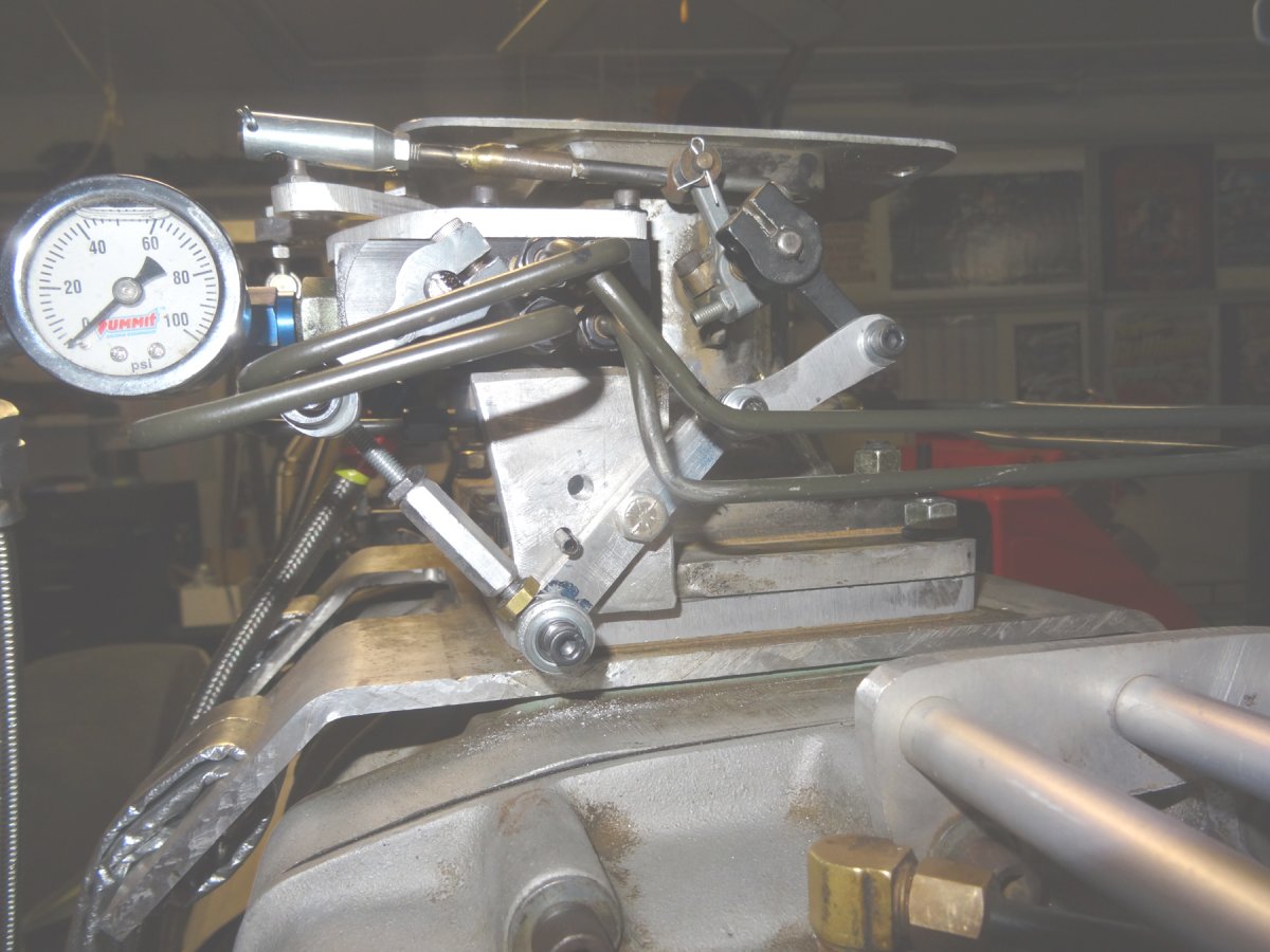

    Hear swat-eye dun!...........Used a stick of all-thread and bent it to suit my needs. The "trick" though is to slip the all-thread in a piece of chrome water supply tubing(the kind under your sink) from Lowes or the Depot. Bend that to fit(with the all thread inside) and use small heim joints on both ends to fancy it up.

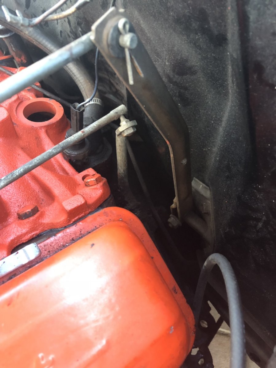

  5. Well I’ll have to say a big thank you to everyone that offered their ideas. I really appreciate it, seriously. However after being able to take a good look at everything and right before I attempted to bend the throttle lever into shape I noticed a MAJOR issue that wouldn’t be solved with a different size linkage etc. The linkage from the car pushes forward to open the throttle, however on the eddie, it requires the throttle to be pulled towards the rear to open the throttle. It appears that a cable conversion is really the only solution. Wish I didn’t waste everyone’s time by missing this obvious problem.

    Are you certain of this? I think you best take one more look at it. From what I can see of the accelerator pedal pivot, and the angle of the throttle arm on the carb, it sure looks like they would be compatible as is. Sometimes when you disconnect the linkage and the return spring the accelerator pedal will fall into the wide-open position and make it seem as though what you are suggesting is the case. Double check.

    Sorry, to the original poster you are absolutely wrong on that statement. The throttle pulls toward the fire wall to open the carb.

    bending the existing rod would be cheaper, stronger and look better IMHO.

    Or find one off a 4bbl car

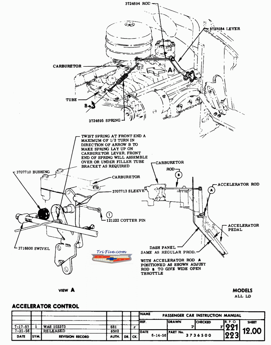

    I don't think that is correct from the photo you supplied. The throttle arm pulls towards the firewall when the accelerator is pushed down [it cantilevers around a pivot in the firewall]
    I just pulled a 283 engine from a 65 impala and it pulls the same way [been like that since '55]
    Here's a schematic of the throttle lever layout on Chevy's

    Yeah not to pile on, but your mistaken.It pulls to firewall.I also think of you get the little adapter that goes in the large carb hole it may all just fit.

  16. Been a few days but I’ll update the thread. Yes, I was foolish and wrong, the throttle pulls in the correct direction. Ended up simply bending the throttle rod to fit. Got my buddy’s father to ask a coworker to drill and tap a 1/4 rod and a bolt that would be made into a sleeve to extend the existing kickdown rod. Should have the kickdown installed by Monday
