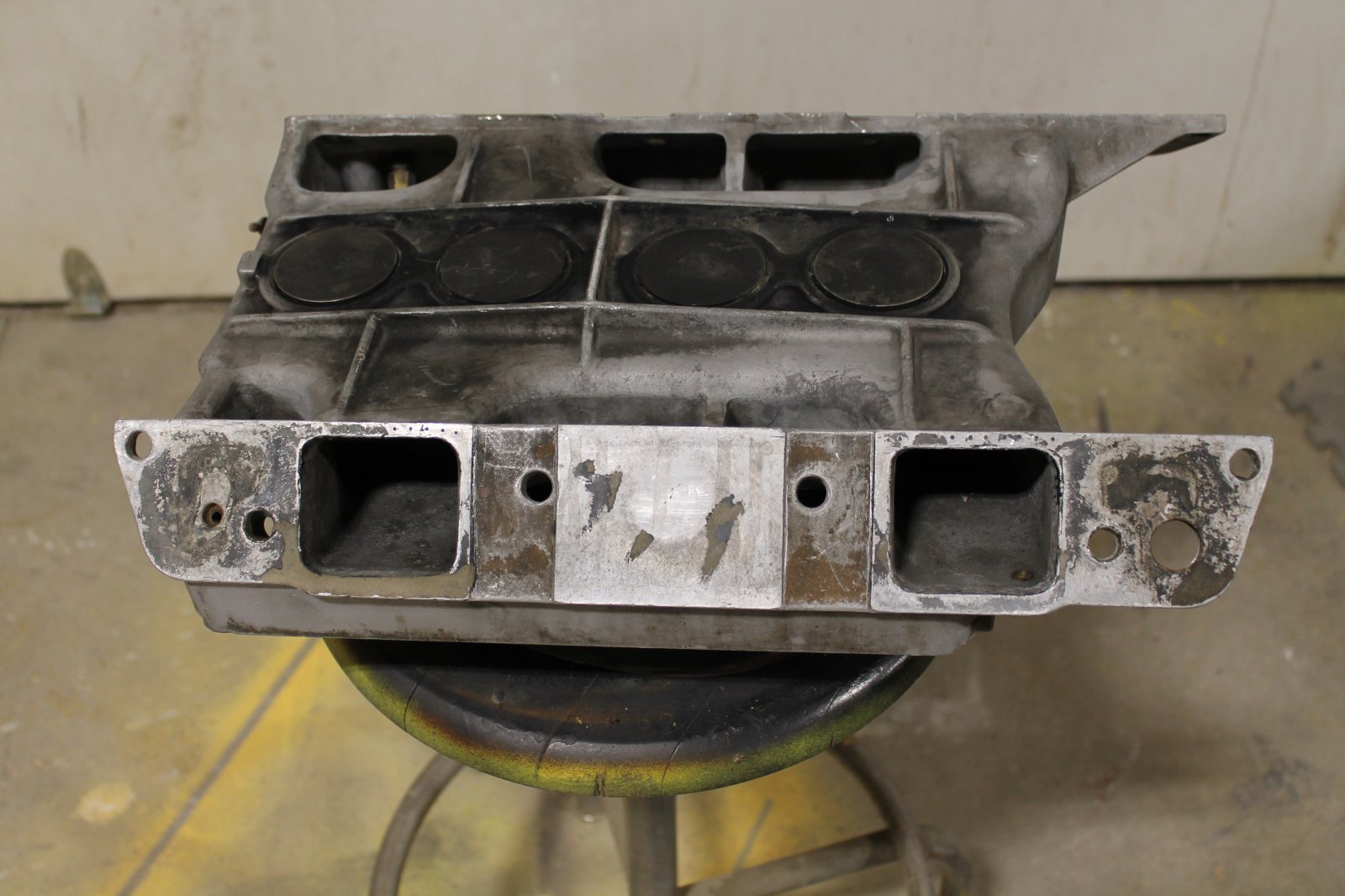

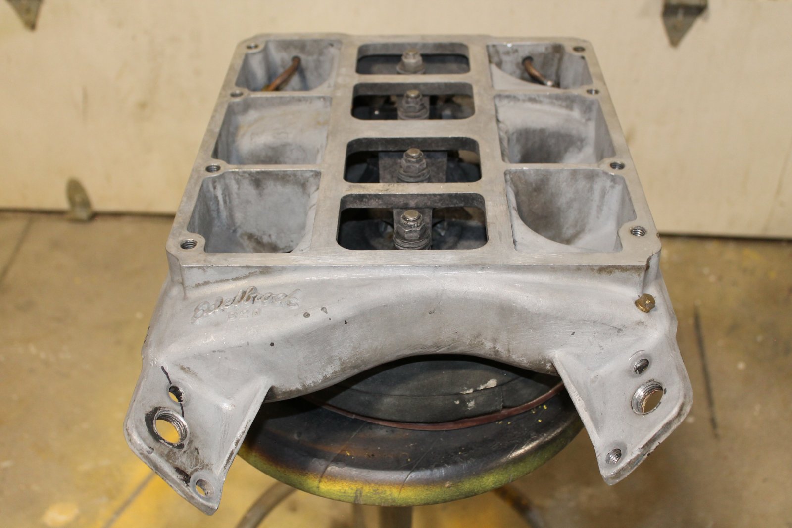

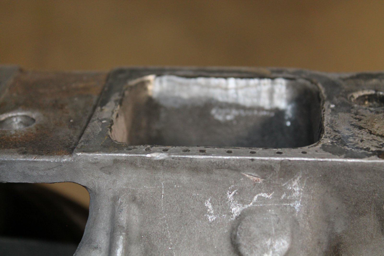

    This manifold is for a 671 blower onto the early Pontiac heads and so will need to be modified to fit the later ones. Since I need to have a couple of cracks welded up (see pictures) I will do the modifications at that time.
    This manifold isn't in perfect shape but considering how long I have been searching for any Pontiac blower manifold I am thrilled to have it.

    Really cool man. Thanks for the pictures.
