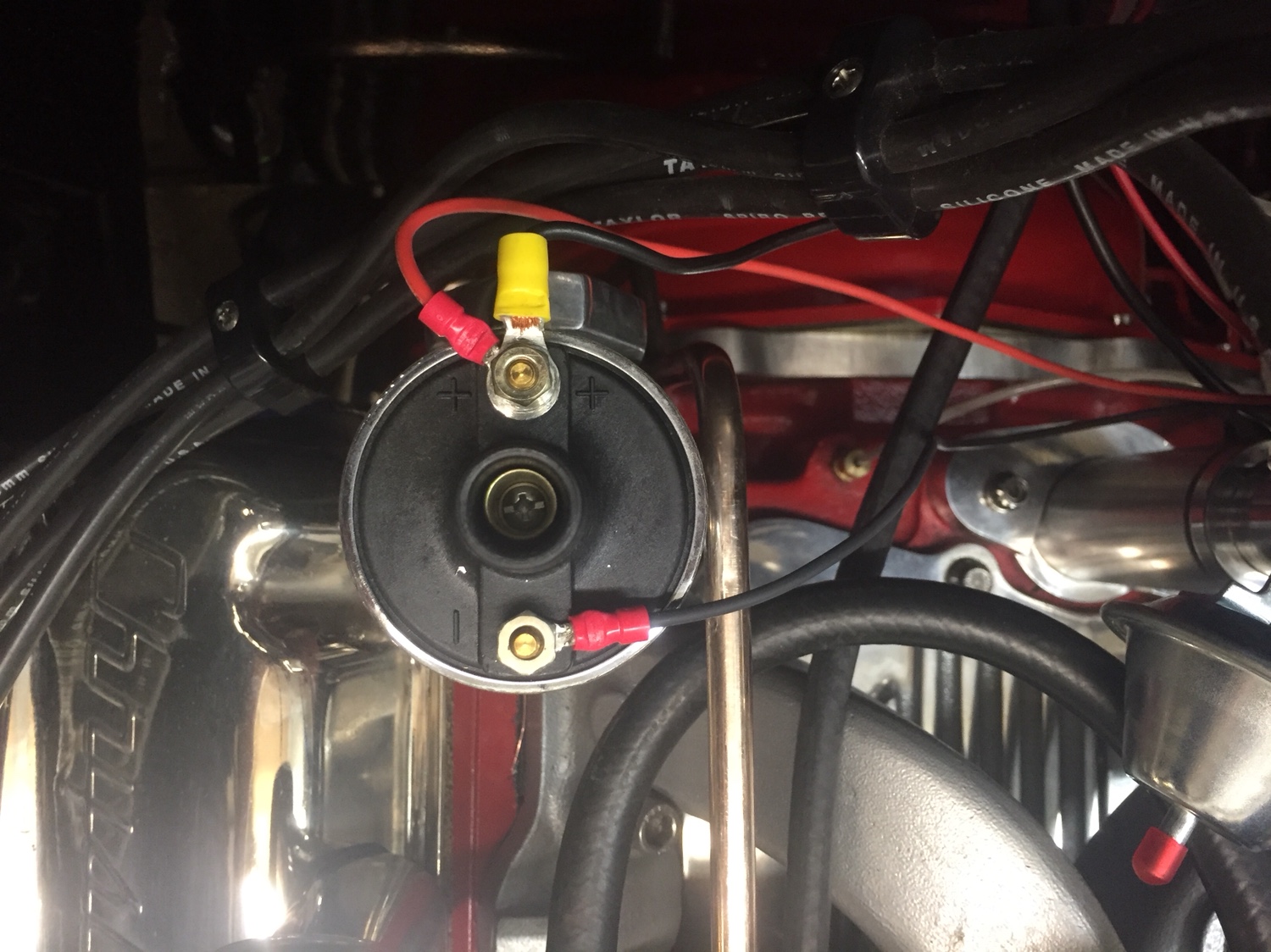

    Here’s the coil:
    - wire goes to the distributor and the two + wires go to the switch (black) and distributor (red).

  18. I just went back outside and tested the coil. The light does not blink when touched to the negative side while cranking. I'm pretty sure that's not right. Theres no way the new distributor and coil are bad. What could be causing this?

    To test the coil disconnect the distributor leads, then take a jumper wire connected to the negative side of the coil and tap it to ground on and off .
  23. What am I looking for to happen? Do I put the test light into the middle terminal of the coil to check for spark?
  24. saltflats
    Joined: Aug 14, 2007
    Posts: 8,081
    saltflats
    from Missouri
    No put the coil wire in it hand hold it about a 1/4 inch from a good ground.
    The coil should spark every time you remove the negative jumper wire from ground.
  25. Just tried it, spark was present.

  27. What should the spark have looked like? Should it have been big and bright? What I saw was pretty small. I'll try the ground wire tomorrow, it's late and I don't want to wake the neighbors if it fires.

    Should be a nice blue spark and jump 1/2 inch.
  29. Here’s a terrible video of something that I’m probably doing wrong. After I took it I realized that the breather probably wasn’t a good ground and tried it on the distributor, it was a little bit easier to produce a spark but it wasn’t much bigger.
