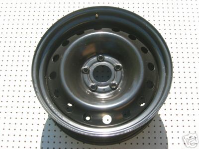

    Here's a photo off an ebay listing that claims to be a 5x5.5 lug pattern/ 16" diameter wheel. When I scaled the photo in AutoCAD (and assuming the 5x5.5 is correct when measured from lug center to furthest away lug center), it looks like these wheels would really accept 17" tires (based on the estimated bead seat location), not 16" wheels as listed. Can you shed any light on this?:confused:
    Thanks again.

    That looks like a 16" to me, I've got a couple sets of those wheels.

    Those five lug artillerys are 16". But they are 17" overall because wheel diameter is measured where the tire mounts, not to the edge of the rim. Maybe that what screwing up your CAD thing.

    Nope. I was measuring to the bead seat, about an inch in from the rim's edge. I think the lug dimension might have been wrong.:confused:

    This is the only picture I have on my computer without caps. But I'll pretty much guarante that wheel in the ebay posting is the same wheel. 16x4.5 with a 5 on 5.5" bolt pattern stamped "KH" (Kelsey Hayes) on the inside of the rim.

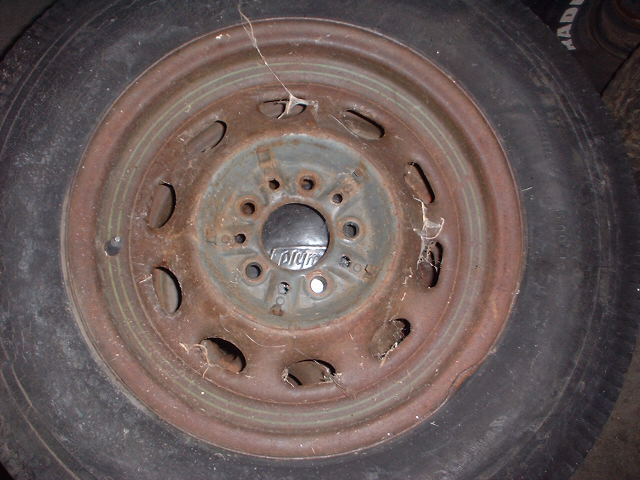

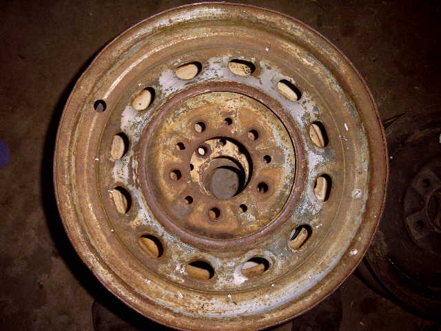

  24. here's some pics of various artillerys. The black one is '36 Chevy 17", small 5 lug. The two yellow ones and the one with stripes are 5 x 4.5" bolt pattern (Mopar) the gray one is 4.75" or 5" pattern.
    I'll try to get pics of a couple 5 x 5.5" and 6 lug tomorrow.
